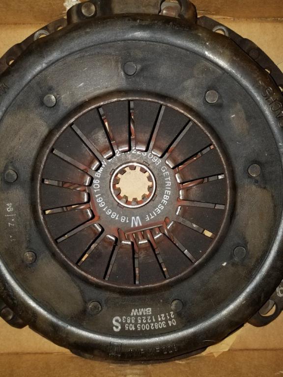

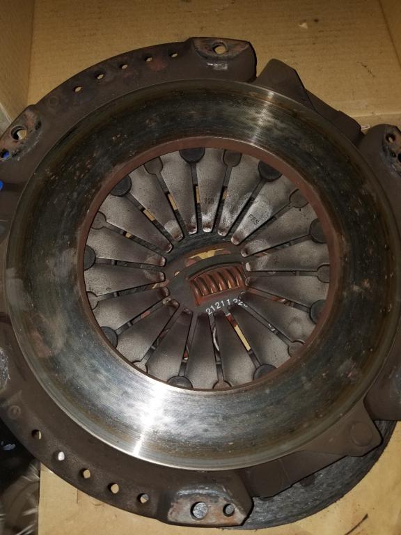

                                #105
                                Heres an ix pressure plate, i can do some measuring if anyone is interested
