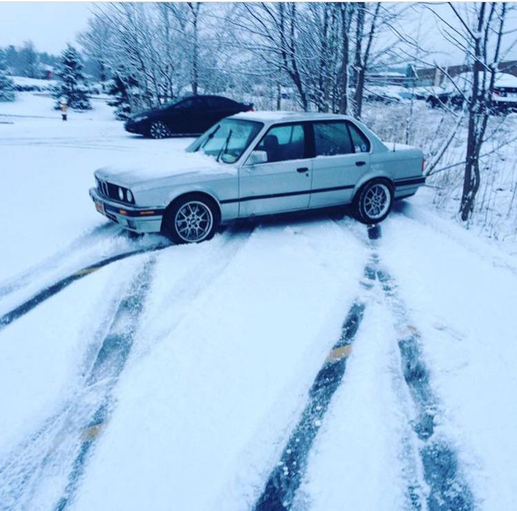

    Heres the old (rusty) car

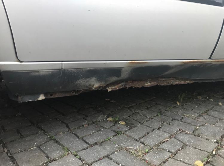

      Thrashed rocker on the right side of the silver car (was like this when I bought it... I always thought maybe Id pull it out and install some Mtech skirts or something.. )

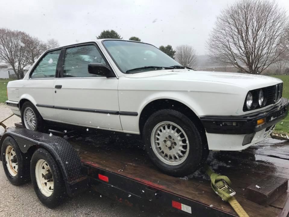

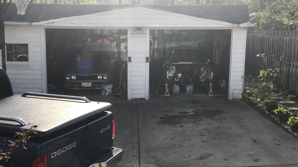

        The two E30s, Waiting to become one
        My garage is crap, theres no lighting in there, only one outlet, and no room. the hopes are to get some of the work done at home and tow the cars over to where I work to do the "real" work

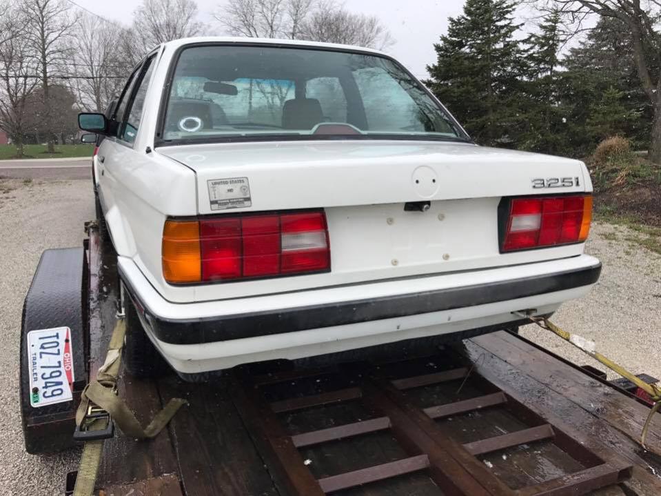

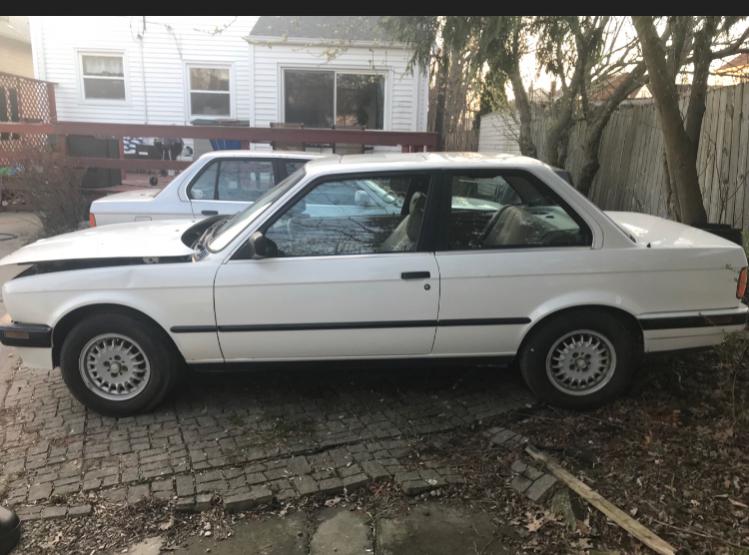

          Its rare to find a rust free body up here in Northeast Ohio, So I had to grab this thing. the only trouble is, I drove an hour away with a trailer and didnt know there was going to be some damage to the front frame rails and a LOT of damage to the rad. support. The guy I bought it from was honest and said the rad support was tweaked, but I didnt know it was going to be as bad as it is.
          still totally worth it though

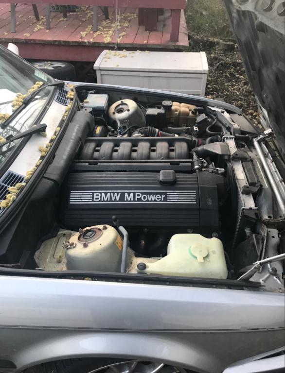

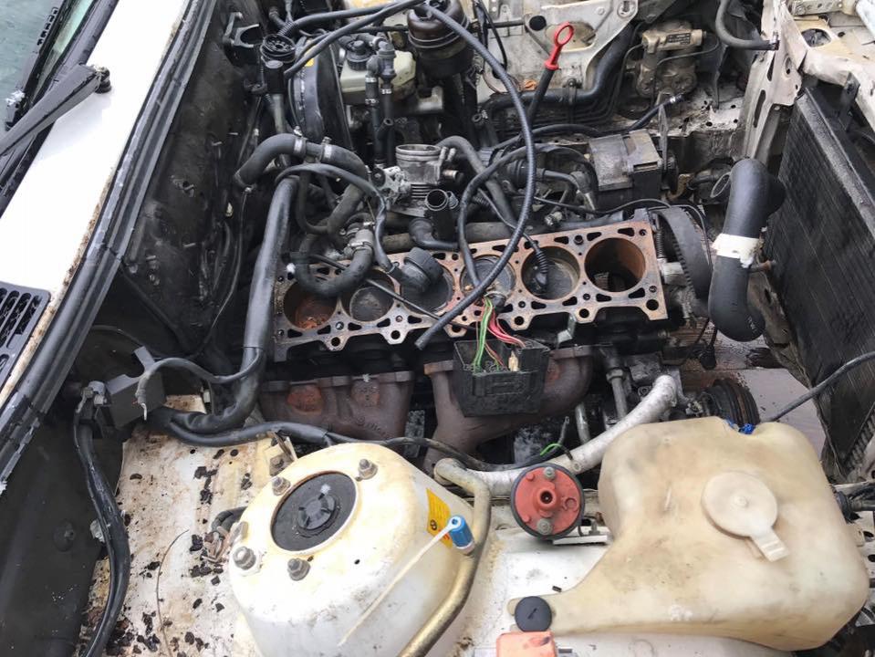

            A view of the engine bay before I took it apart. I just hacked the Rad support off since it was so mangled, Ill have to replace it anyway

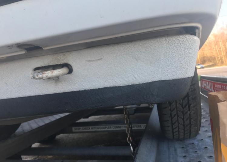

                Its super Clean below the battery box (And at the lic. plate lights too).

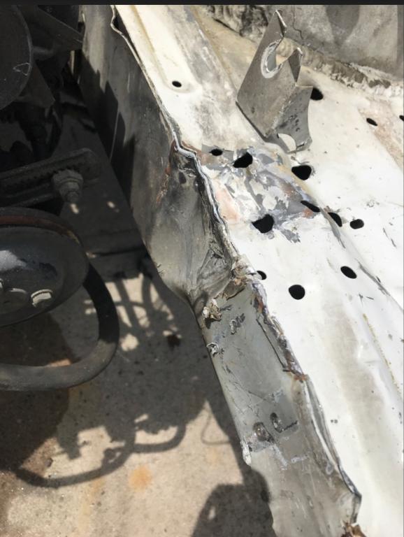

                  Its obviously had an incident with a tree or something.. And they just beat the rad support back together as good as possible and replaced the grill and hood (?).
                  The rails have some buckling in them which I decided to try and straighten a few weekends ago

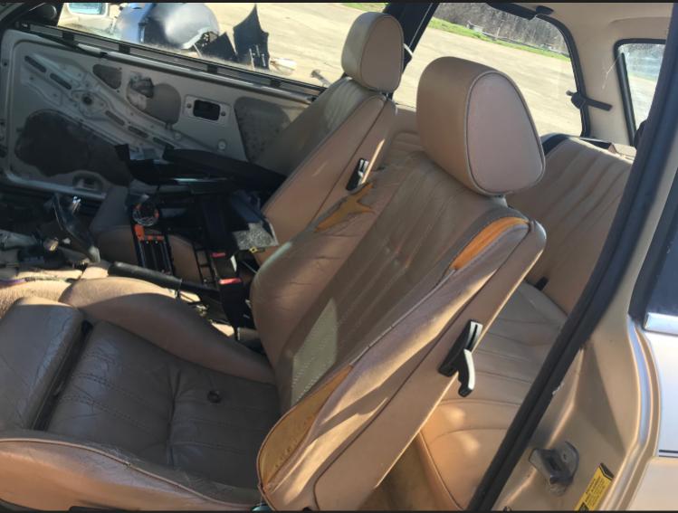

                          the sports seats are trashed as usual, but I plan on recovering them

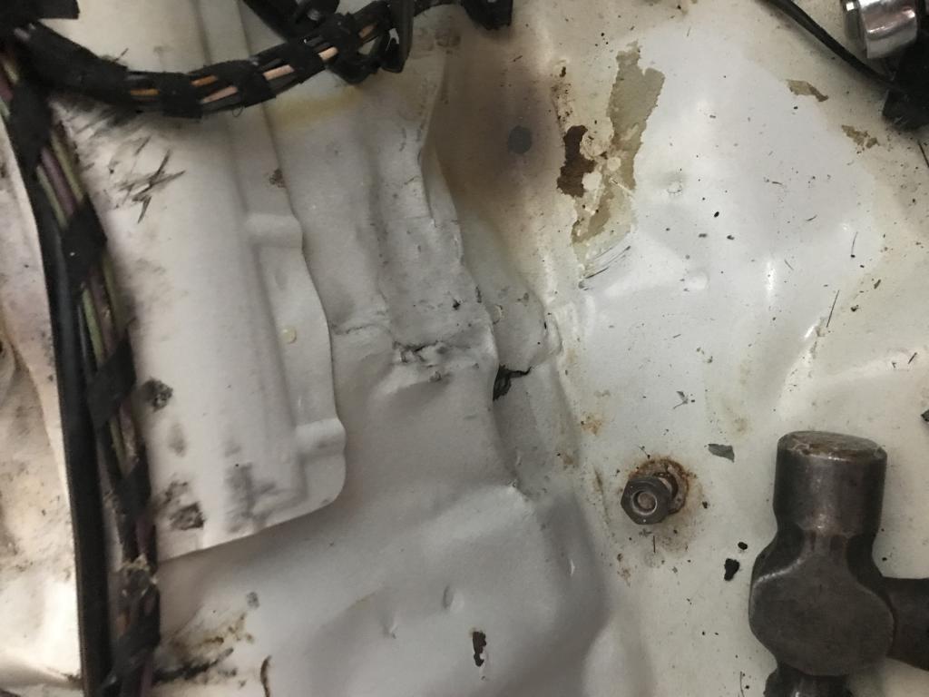

                            Stripped the dash, carpet, and heater box out of the white one this past weekend, And found that the damage on the trans tunnel is a bit worse than I thought
                            I knew the Guibo came apart and thrashed the tunnel, but I didnt know that it actually sliced through the sheetmetal in places. that will be some work.
                            also It looks like the motor was pushed back into the firewall in the accident, and dented up the firewall below the heater box

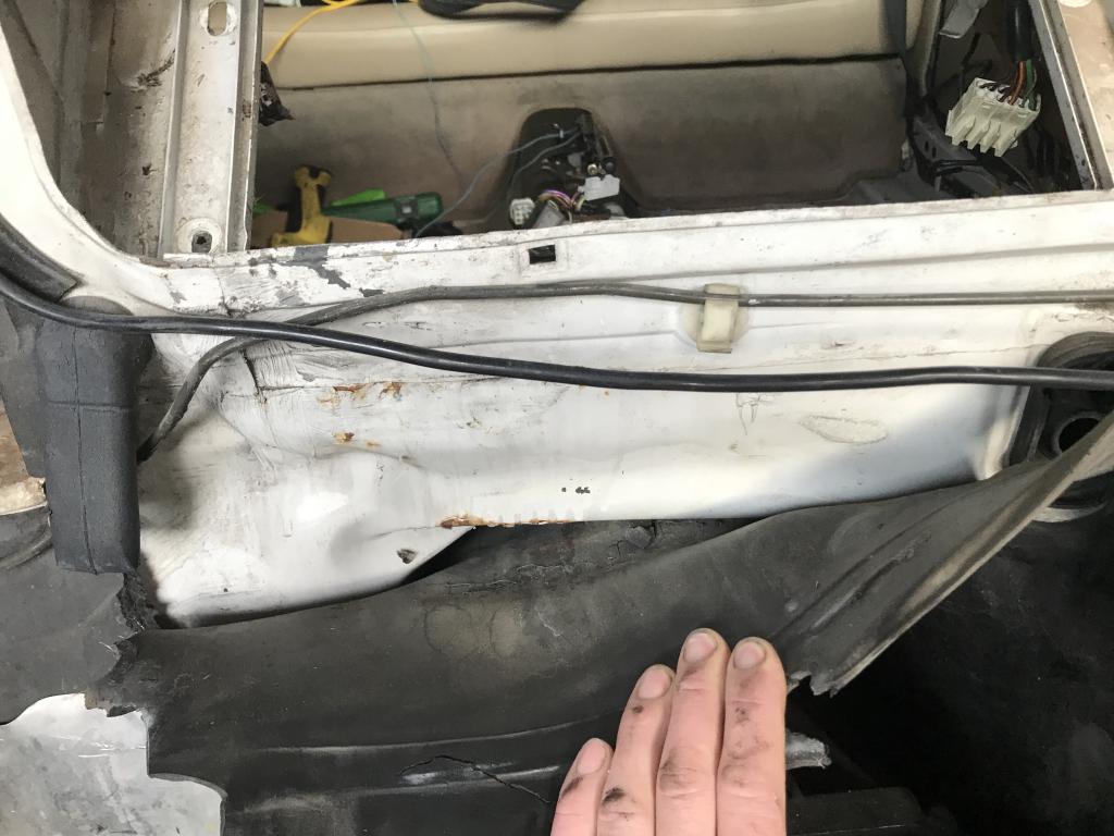

                              Heres the floor on the passengers side. Not as bad as the drivers side
