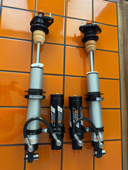

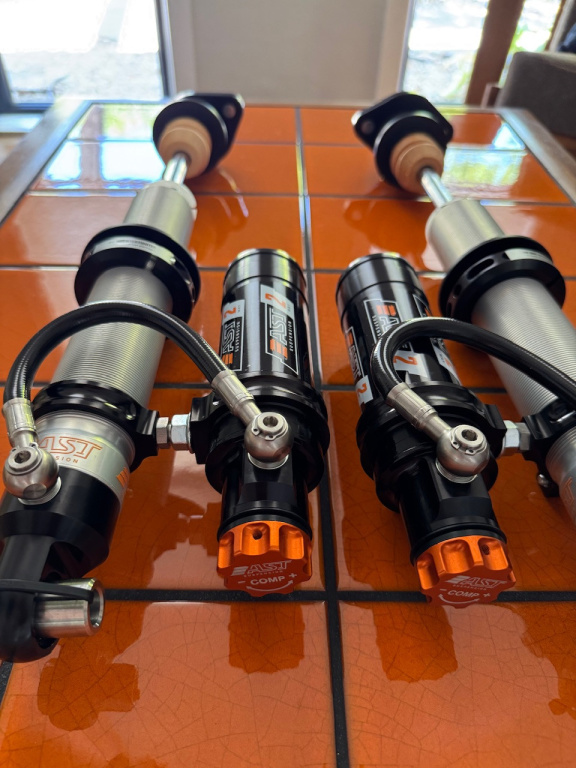

    9000km update. Car still going well and upgraded suspension. Now running AST 5200 dampers, pretty happy with them.
    Tried a few ways to mount the canisters, on the rear directly to the trailing arm was the best option. Mounted to shock body worked on driver side, not on exhaust side
