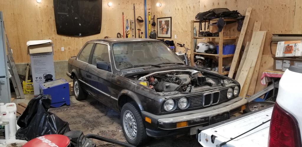

      First up the subject car. Pardon the sawdust - as I said earlier I was balls deep in a reno for that last year and that included insulating and paneling my workshop.

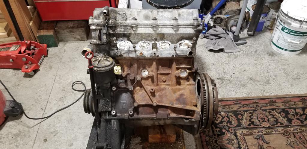

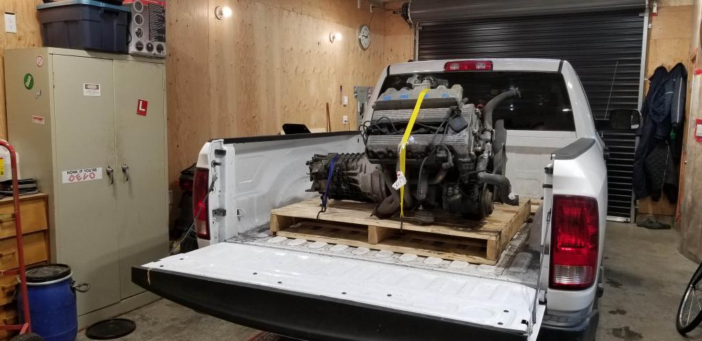

      Second up the M42 as received on the pallet.
Name:	m42 as received.jpg

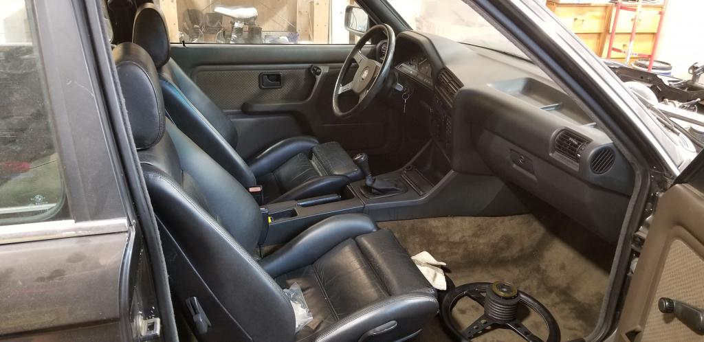

      Third up a shot of the interior showing off my lovely sport seats.

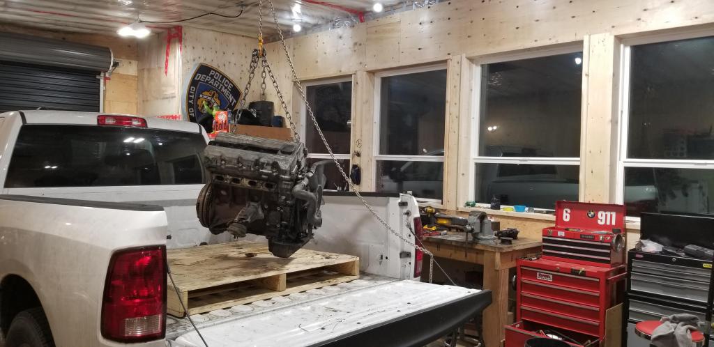

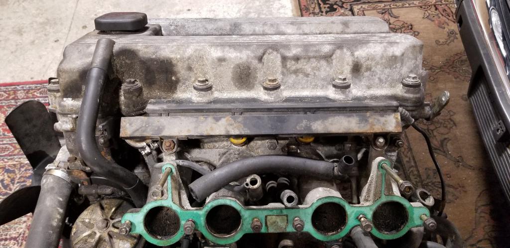

      Fourth up a shot of the m42 hoisted and partly stripped. After that I lowered it onto a moving dolly I bought on sale for $18 at Princess auto - which is just like your Harbour Freight stores.
Name:	m42 hoited and part stripped - 27dec 18.jpg

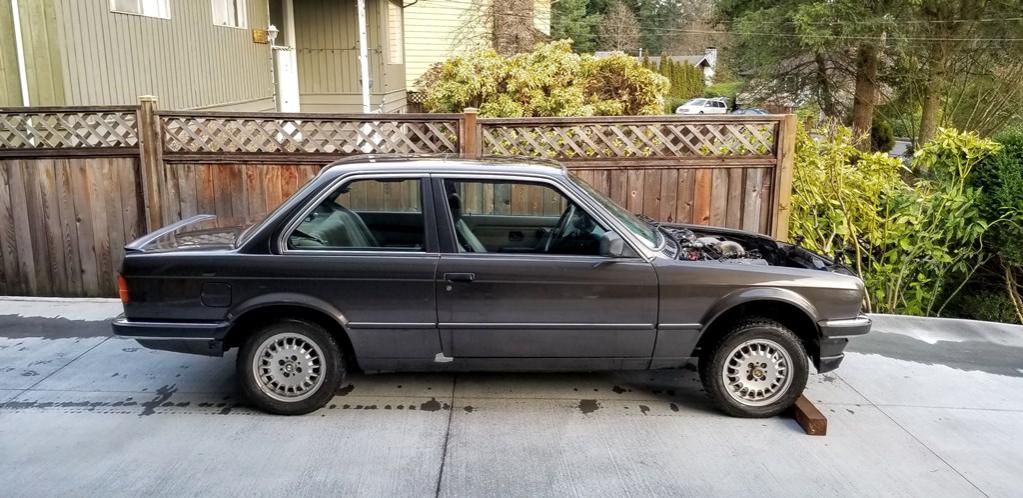

              OK - activity:

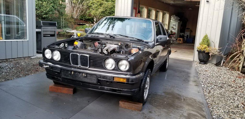

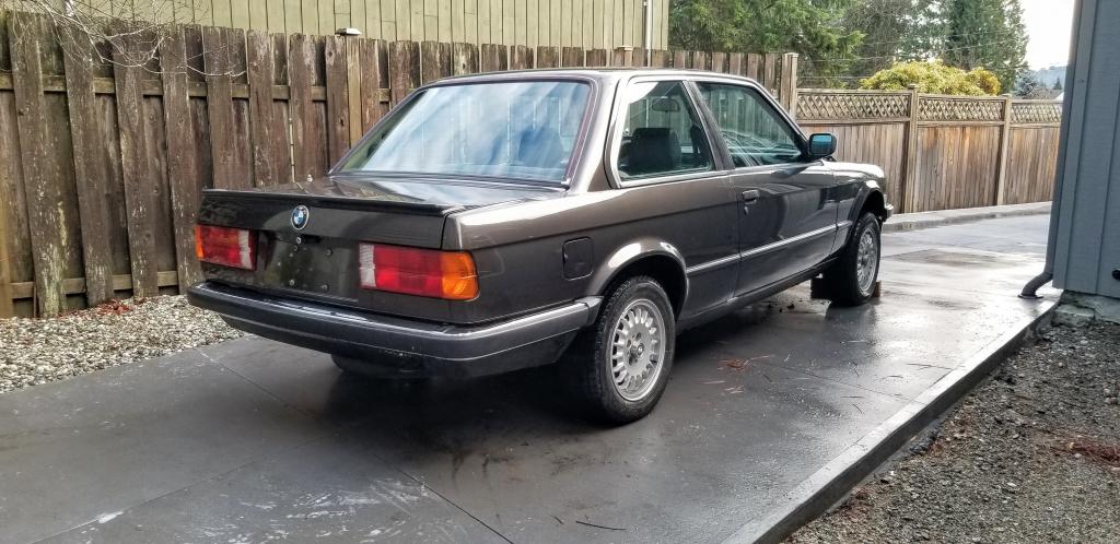

              I took the car outside yesterday and washed it. It's actually the first time that I've ever seen the car outside in daylight. I brought it home in October 2016 in the dark, and immediately parked it in my garage. I did a few things....and then the reno hit.
              Here it is washed up. Rear suspension and subframe is done - front is not yet - hence the goofy stance. Note I got the front euro bumper mounted - that was a job as well. It was bent straight by quite a bit. I had to "english" it into a curve to match the car. Worked out well in the end.

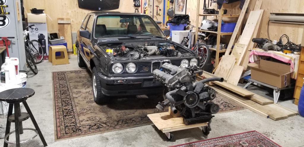

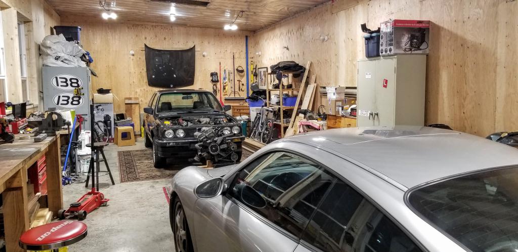

                Cleaned up my shop a bit while the car was out as well.
                Lined up the m42 on the cart I built. It's going to be great.......one day.

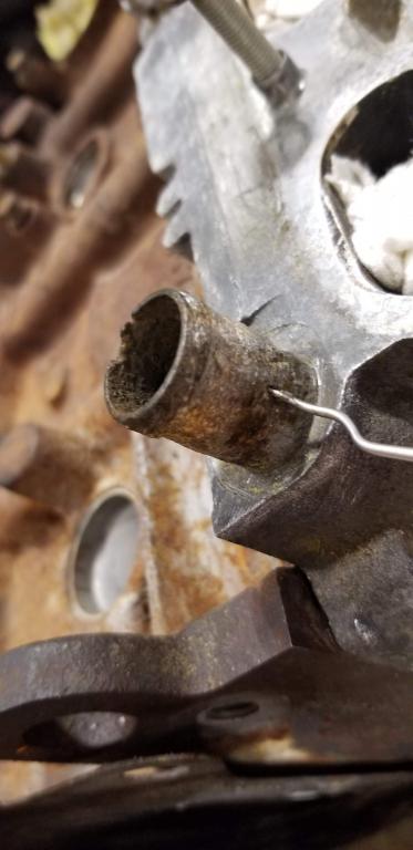

                      Got some stripping and cleaning done last night by the way - looking better and giving me some comfort that this will look fine when it's done.
Name:	engine cleaning1-01jan19.jpg

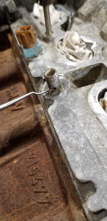

                      Some wicked aluminum oxidation though.
                      The pipes from the header which feed the cabin heater and the throttle body preheater have actual holes rotted through. I plan to build these up with JB weld and then file/sand them down round.
Name:	head corrosion1-01jan19.jpg

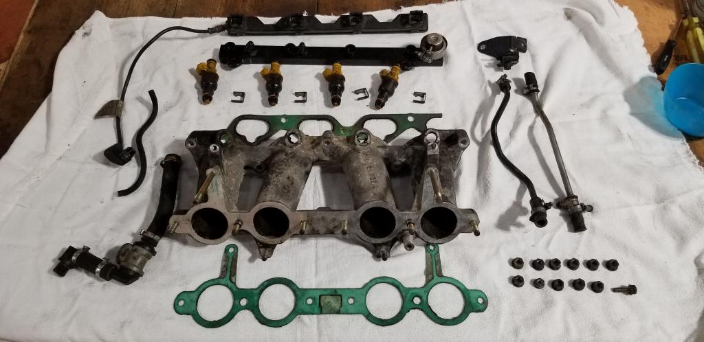

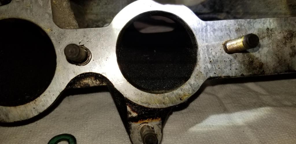

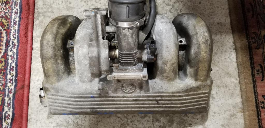

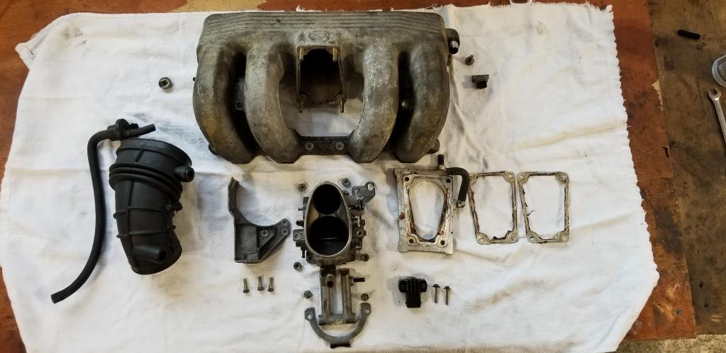

                            I blew apart the upper and lower intake manifolds as well as the throttle body. Trying to figure out what the easiest way is to get this stuff all clean and buffed. Tried closing my eyes and wishing it clean but no dice.
Name:	lower intake 1.jpg
Name:	upper intake and tb 1.jpg
                            I plan to delete the heater element that is attached to the throttle body throat entirely (the square u-shaped piece and horseshoe shaped bracket) but I may re-install the throttle body heater itself to act as a spacer. Word is that the t-body boot doesn't line up well with the airbox otherwise.
                            That all said - I will have to fab and install a new airbox bracket anyway so I have flexibility as to where I mount it.

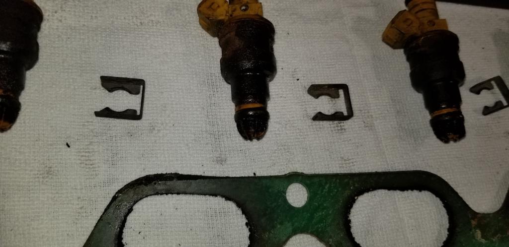

                              Check out the gunge built up inside the intake and on my injector tips.
                              I plan to compare the cost of buying a set of Ford injectors against having these cleaned. The car had only 190,000 kilometres on it so the injectors themselves should still be good.
