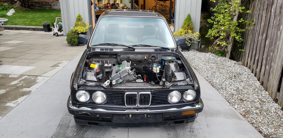

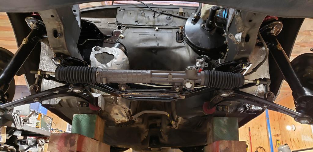

    I fitted the rack using three head bolt washers on top of the rack - when I finally installed the engine and the car settled into it's stance the tie rods were dead level.
    I used e46 inner tie rods and e36 outer tire rods. That's teh only combo that works - but it works well.

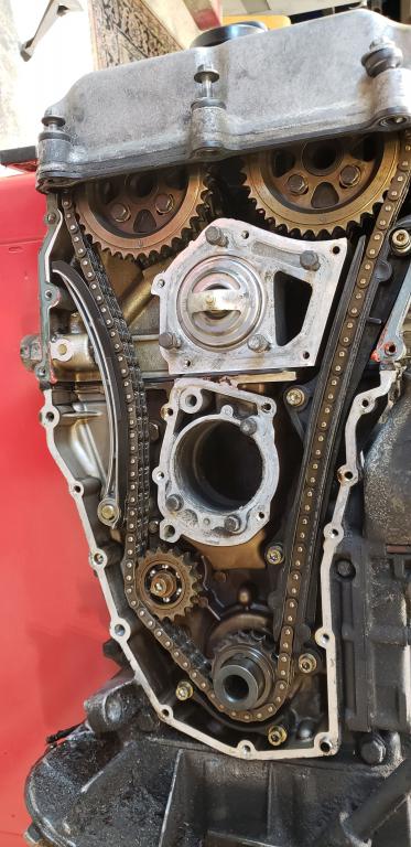

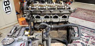

      When I tore don my engine one of my chain ramps was cracked. It was the expensive one as well. Fortunately - I had been *given* a spare m42 which a local had run out of oil. That engine had a new-style chain ramp that was in excellent shape. Here is a photo of it still installed in the spare engine.I also used the water pump from the spare (it was excellent shape) and the inner timing case because the one that came on the engine I bought was badly corroded in the water pump area. Didn't get any photos guys - sorry about that.

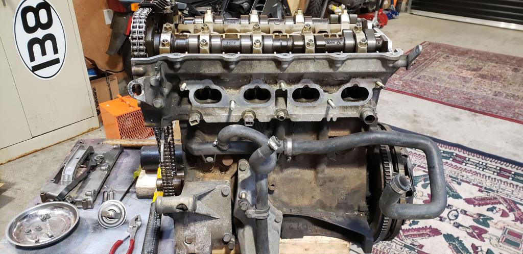

        I sold the head from the spare to a local who badly needed one. Did a good deed and made $250. I hope I don't regret it - I had plans to port that head and install it down the road.

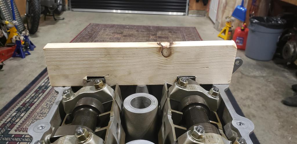

          #34
          Reassembling the engine about a month ago now and I made a tool out of wood to help me time the cams. In the end the wood piece didn't hold the cams square enough so I finessed it bit by bit until the end pieces were dead level. Torques teh sprockets bolts to some ridiculously low setting. Instructions are on line - I won't go into it here unless someone wants me to.

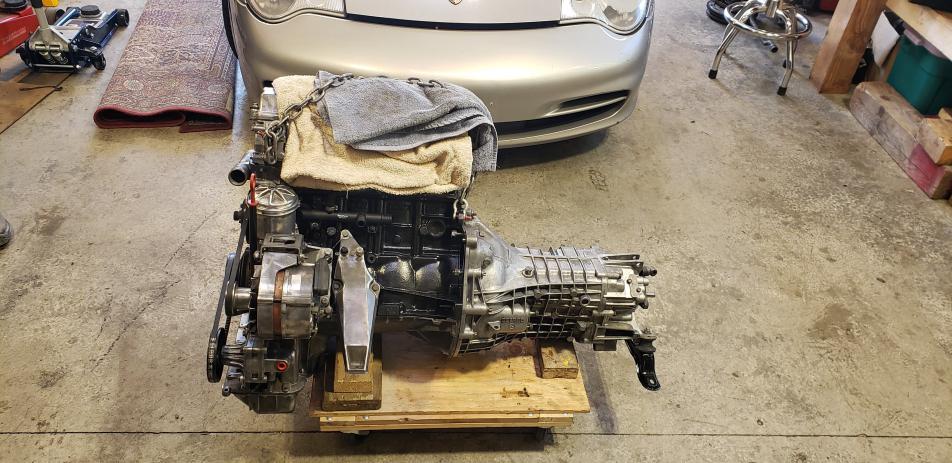

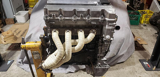

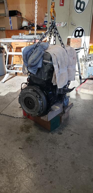

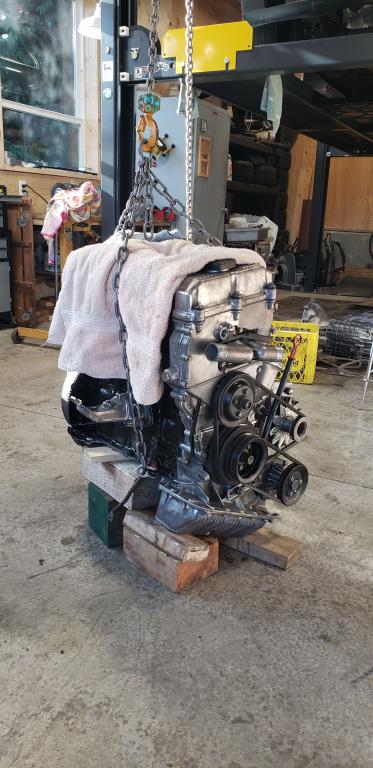

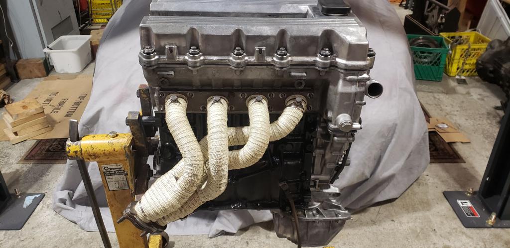

            Engine assembled ready for install.
            I wire wheeled every bit of aluminum and then wrapped my headers. I had painted the block black a while ago already.

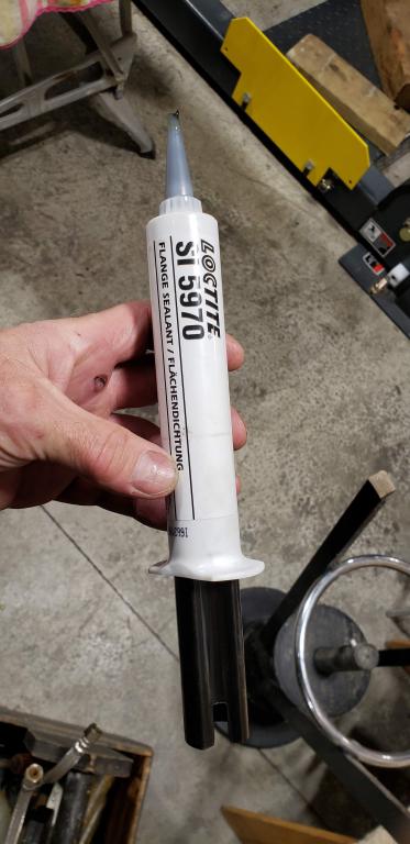

            I used Hylomar on the paper gaskets but for the oil pa(s) I didn't use any gasket - just a bead of Loctite 5970. I befriended a BMW tech and he says thats all they use. Same stuff that Porsche sent me when I replaced the pan on my 996 several years ago. Also a dab of gasket maker type RTV where the twp profile gaskets meet . I hope it all holds without leaking but frankly I will be surprised if it doesn't. I haven't seen a whole lot of dry m42 out there.

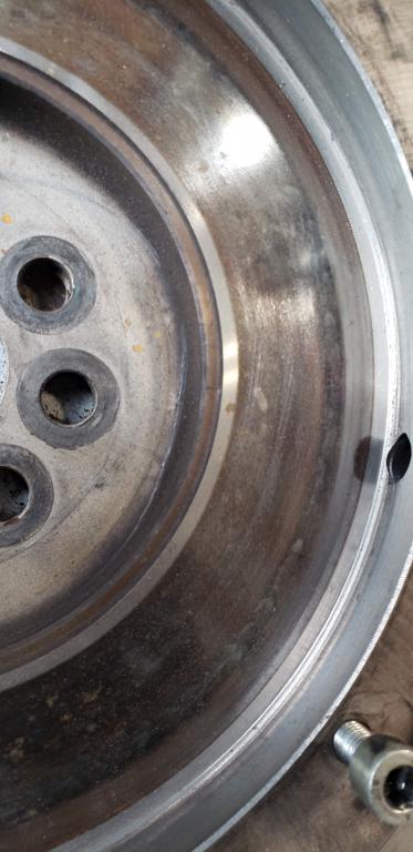

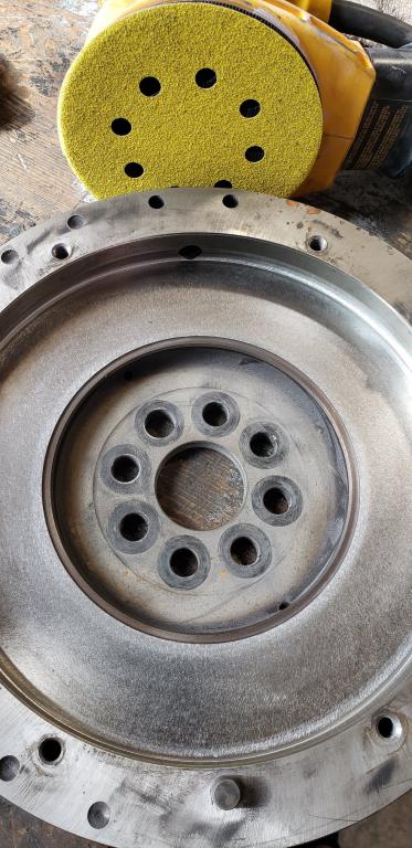

              I did a hillbilly flywheel resurfacing. Came out good. This is a single mass flywheel from a 318is without an air conditioner. I learned this - air conditioned m42 cars got dual mass but non A/C cars got single mass. They're pretty rare here in North America because we normally got A/C but it's the other way around in Europe. Clutches aren't easy to find but I found a good kit for $120 eventually Valeo I think it was. The single mass m42 flywheel is very different than the m20 flywheel - it has a big rim around the outside and the clutch sits inside that rim..It's heavier too I think - but hey it bolted right up without mods. Only got these photos guys - sorry I should have been more diligent.

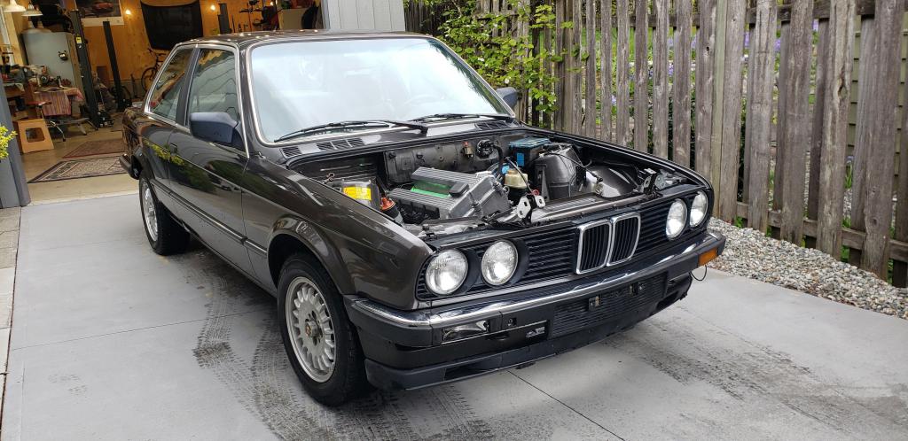

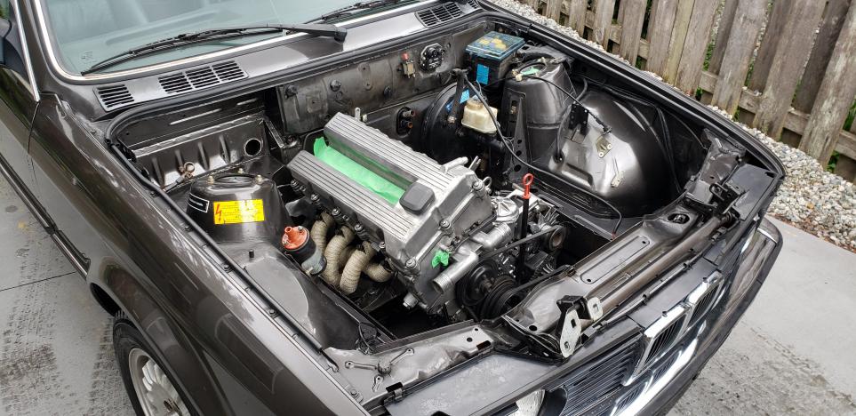

                  And finally in the car.
                  I got a shop to prepare a spray can of paint matched to my colour (sable brown). Ground off the m10 airbox mount and painted the inner fender. Ihave the m42 mount that was cut froma parts car and plan to rivet it into place. I removed the mess under the intake and do not plan to reinstall the heat exchanger under my throttle body so the mount will need to be moved just a bit from the stock location.

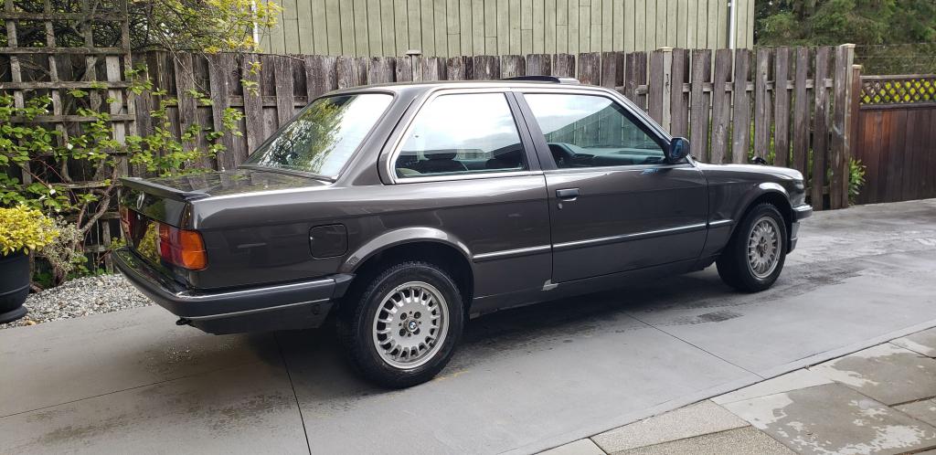

                                Dang - I see I didn't upload the photos after I washed the car. We all like photos...so
ID:	9922541 Click image for larger version
