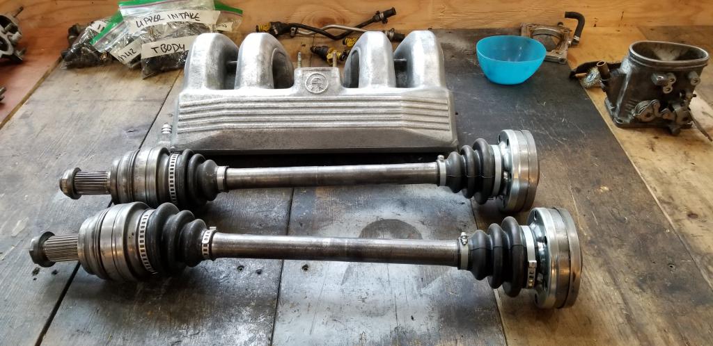

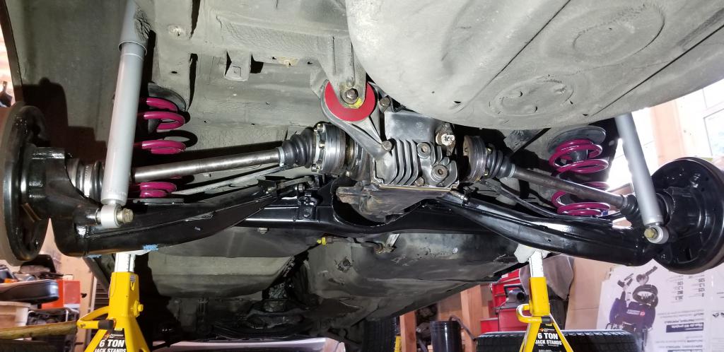

    Soyesterday I hit the upper intake with a brass wire wheel and today I installed the rear axles which I refurbished last year. I had taken the CV joint apart for inspection and they looked good - so I re-greased them and installed new boots.

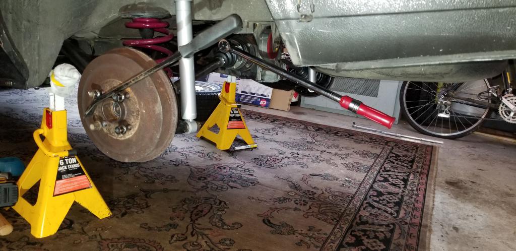

    Jacked up the back and threaded the wheel bolts to act as a leverage point for my prybar while I torqued the axle bolts themselves.
    I could not find a torque spec for these bolts anywhere in my Bentley or the manuals on line. Google came up with a page that said 53 ft-lbs - I took them to 60 for peace of mind.
    All done - next up is to install a sway bar. The early 318i cars came without any sway bar at all and I am installing a 12 mm to keep things a bit supple.

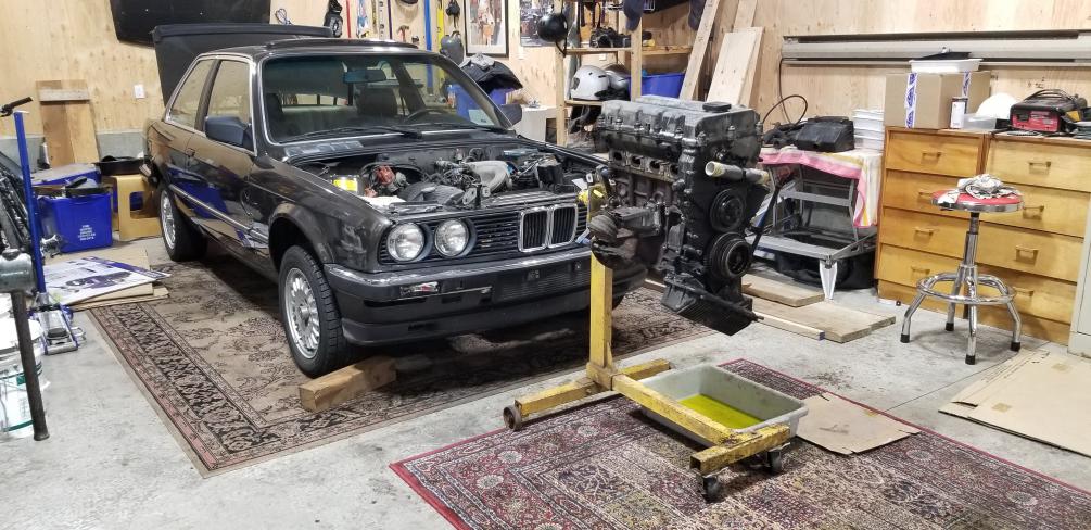

      Update.
      I borrowed an engine stand from a guy at work so ready to get busy cleaning up and re-sealing this engine. Plan is to replace *all* the seals and gaskets. Not planning to redo the timing gear, hoping the chain ramps etc are in good shape.
      Also hooked up with a group of local e30 guys on whatsapp. Probably some of you may be following this thread - great group - hooking me up with parts from the moment I logged on, ready to come and help out when I posted this morning (although ended up not needing help).

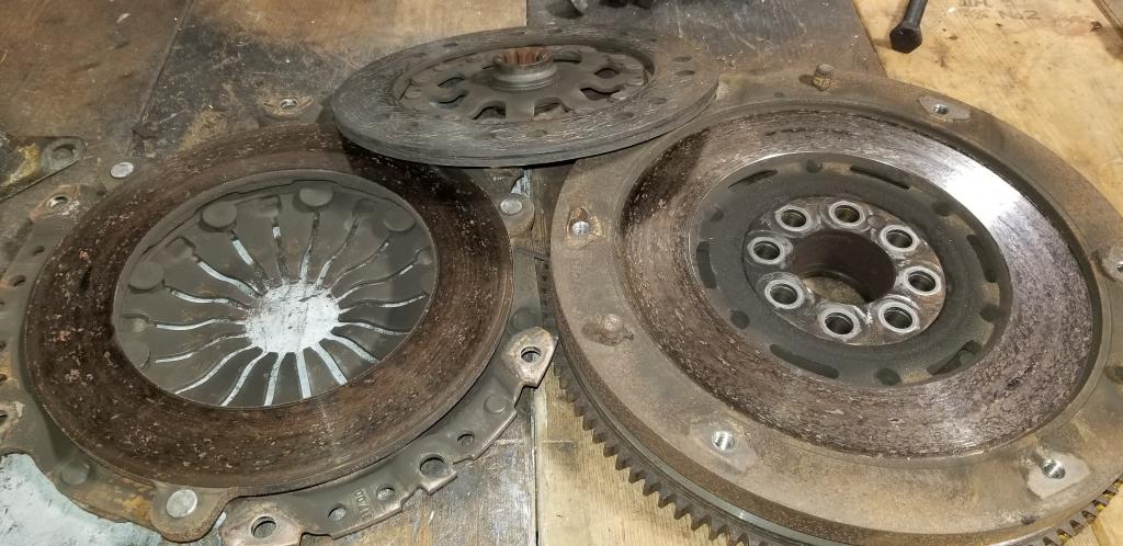

      First things first - I removed the clutch and flywheel. Mine is a dual mass and I heard from one of my new e30 friends that cars with A/C had dual mass flywheels and cars without A/C had single mass. I'm on the hunt for a m20 single mass flywheel - either from an m20 or a m42 without A/C. The old clutch had some meat left but the pressure plate and flywheel looked rubbed a bit raw.

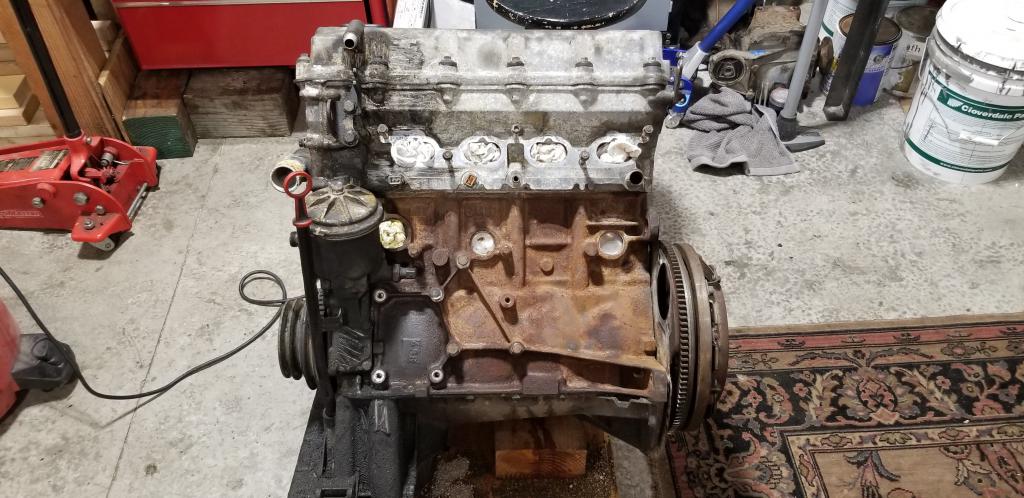

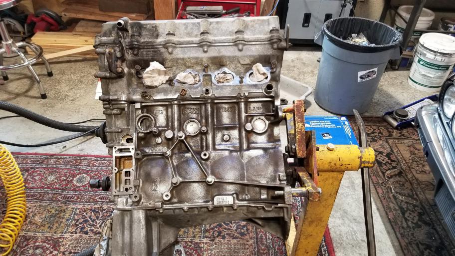

      Here's the dirty engine on the stand - can totally visualize this in the car.
Name:	engine on stand1.jpg

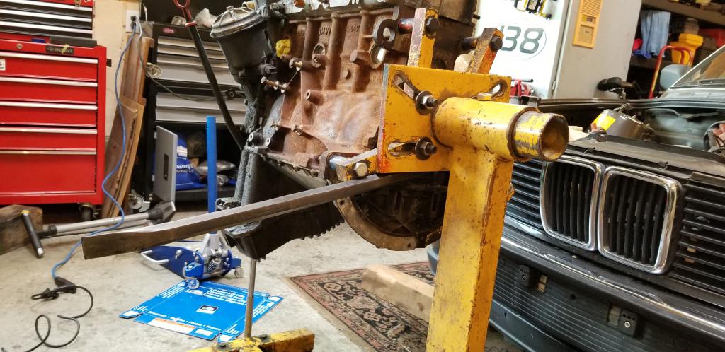

      I thought removing the crank bolt would be hard but it wasn't. I threaded a couple of flywheel bolts back in to the back of the crank and wedged a prybar through the bolts up against the frame of the engine stand. Then I extended my breaker bar using the handle of my floor jack and it twisted right off. Hard to tell if I applied 240 ft-lbs to it...it's possible that the crank bolt has been off before and was not torqued to the outrageous spec.
Name:	crank bolt 1.jpg
Name:	crank bolt 2.jpg

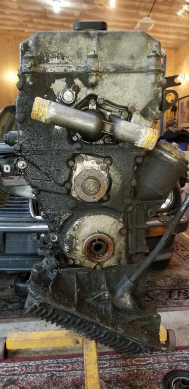

      So that left me with this mess to clean up...much solvent and scrubbing followed....
Name:	dirty case 1.jpg

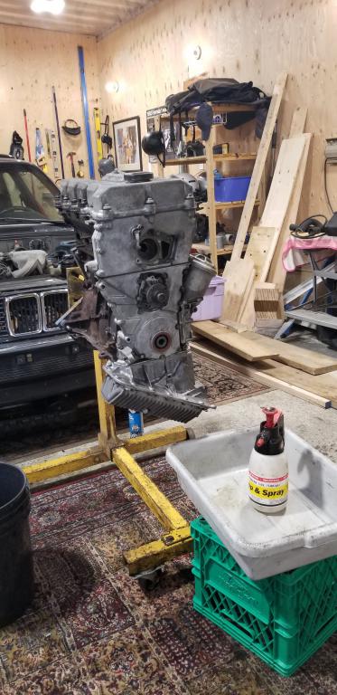

        So yeah - at least four hours of spraying solvent, brushing, wiping, spraying scrubbing, brushing, wiping.....pleased enough with the results.
Name:	cleaned up 2.jpg
Name:	cleaned up 3.jpg

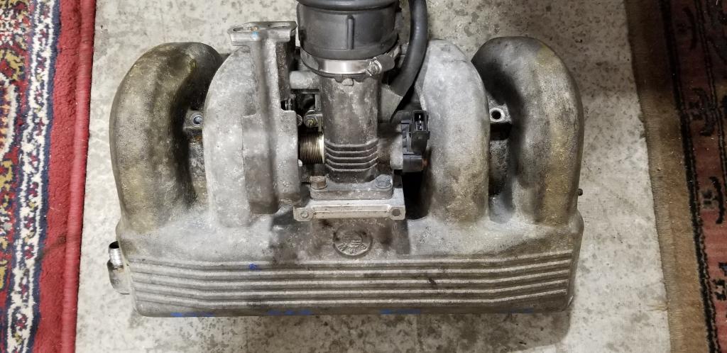

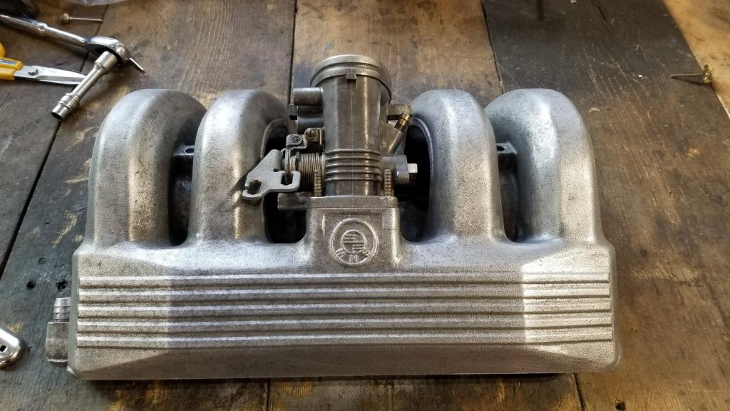

            So in between some travel for work and a cold that's kicking my ass I have managed to do more cleaning. Lot's more cleaning
            This motor is a hella mess for supposedly having only 200k kilometres on it. I hope to get the valve cover off tomorrow and maybe also the timing covers - that should give a good indication of the condition this engine is really in.
            Here is the upper intake and throttle body before:
            and after:
Name:	clean intake 1.jpg

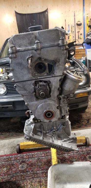

            and this is the case before:
Name:	engine cleaning1-01jan19.jpg
            and after:
Name:	clean block 1.jpg

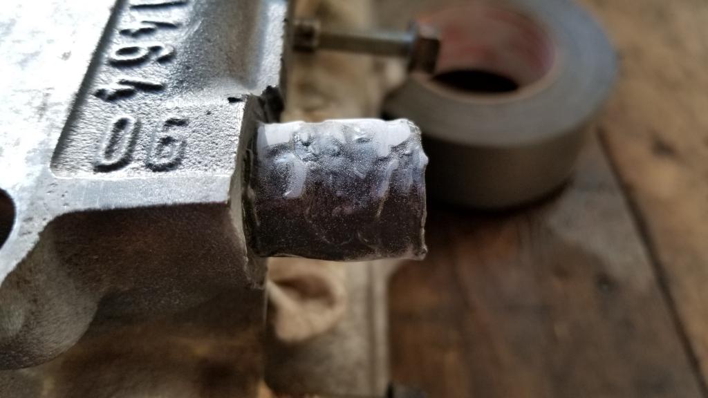

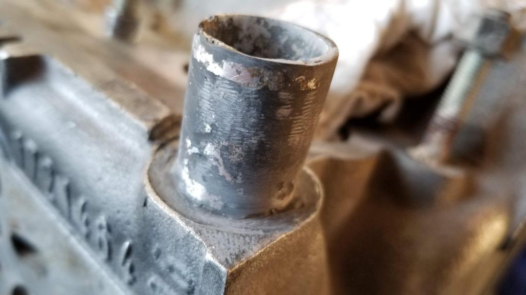

                  So I have been pretty damned negligent in updating this post. I've made huge progress in the last year. In teh final strokes now. Let me try to get you caught up.

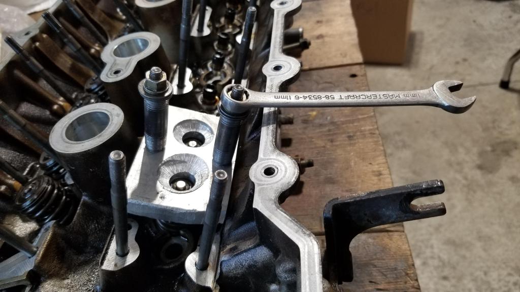

                  I used JB weld to repair the corrosion holes in the coolant pipes on my head:

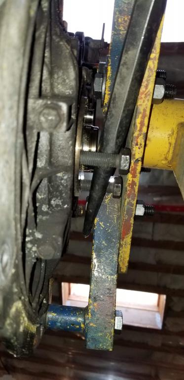

                    Then I fabbed up a valve spring compression tool so I could disassemble the head.

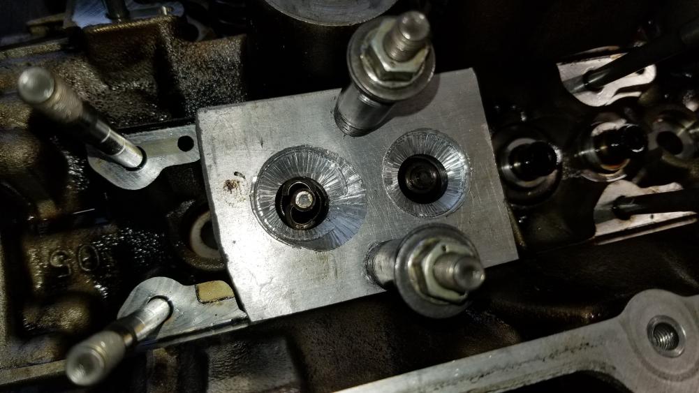

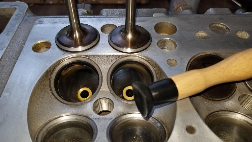

                        Then I lapped the valves Click image for larger version

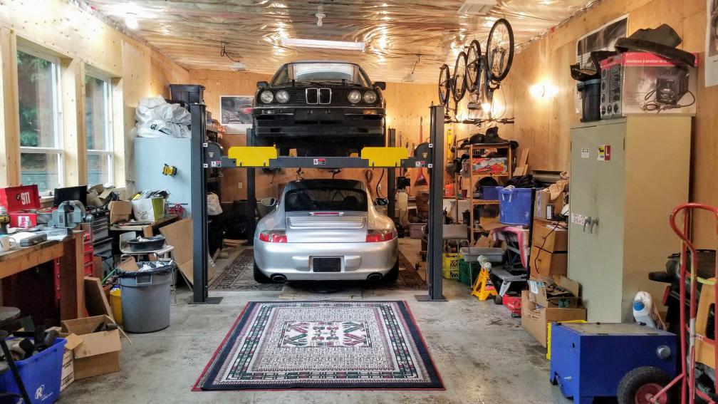

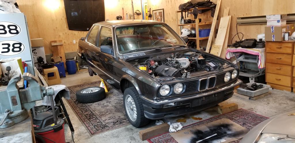

                          Then I installed a four post hoist in my shop Click image for larger version

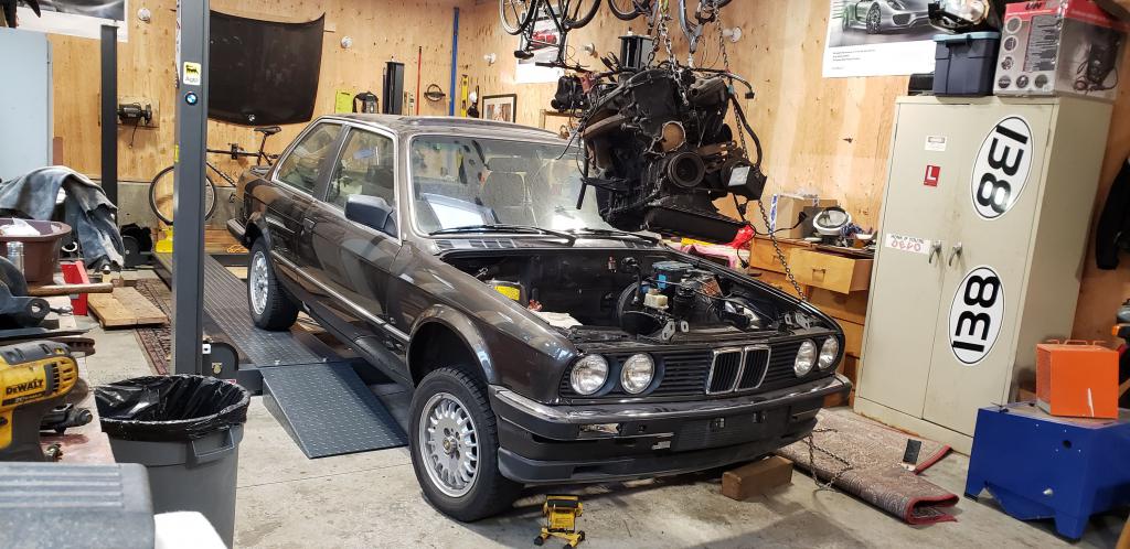

                            Then I finally yanked the m10 Click image for larger version

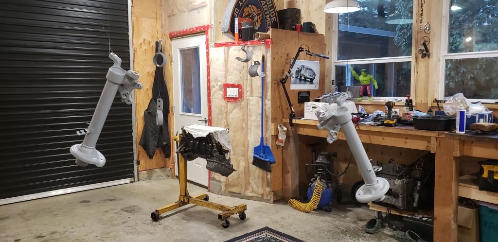

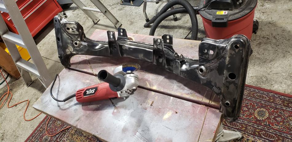

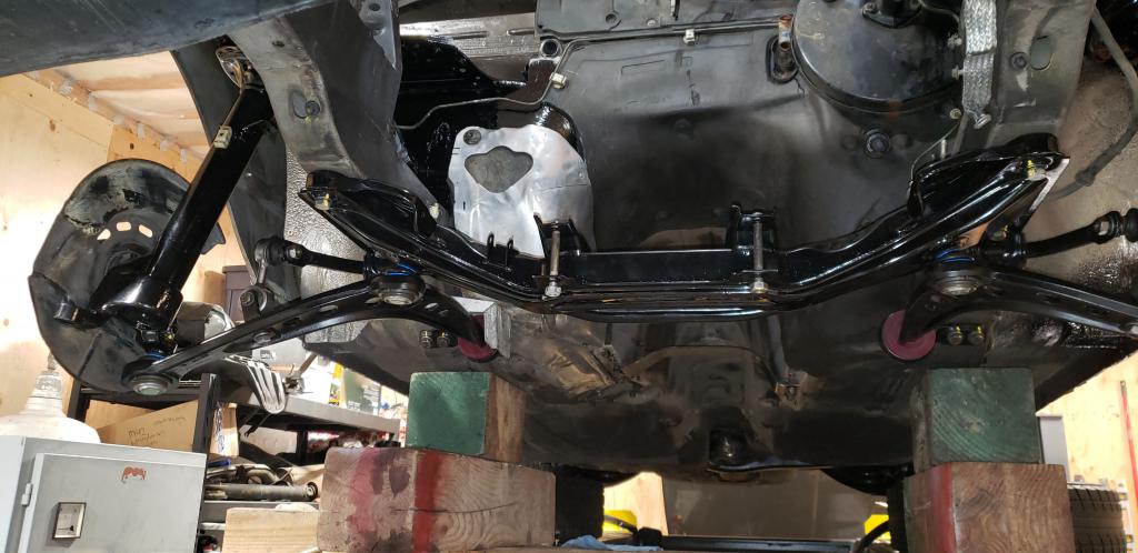

                              Then I stripped and painted the subframe and struts - that's an m10 subframe - it won't work with an m42 without modification to the spacing between the stud and locating dowel on the motor mounts - more on this later. I ended up buying a new subframe. Basically they are the same for every e30 - except the very early cars (like 84-85) .
ID:	9919258 Click image for larger version
ID:	9919256 Click image for larger version

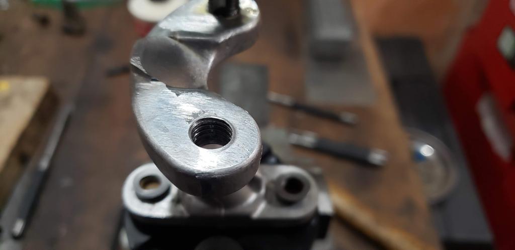

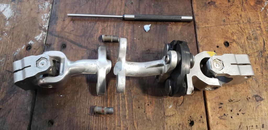

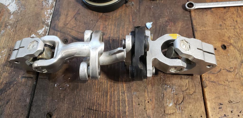

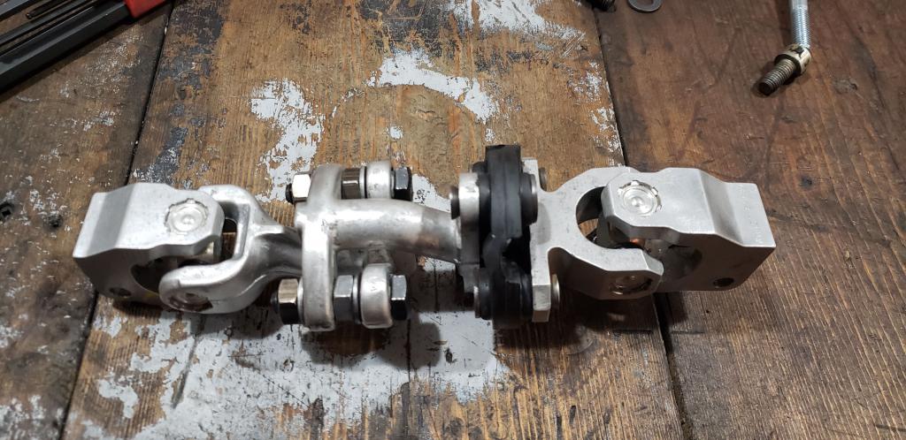

                                Then I modified my steering joint to fit my e46 ZHP rack. I ground off the rivet and used a bolt with a nut as spacer. I also tapped threads into the joint itself and then loctited everything.
