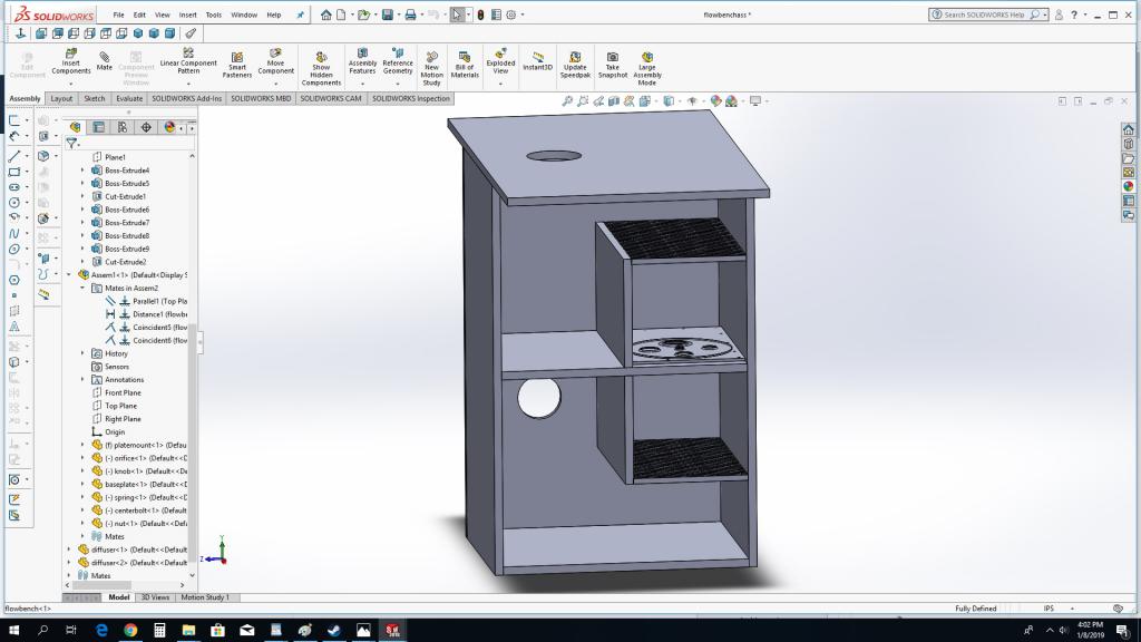

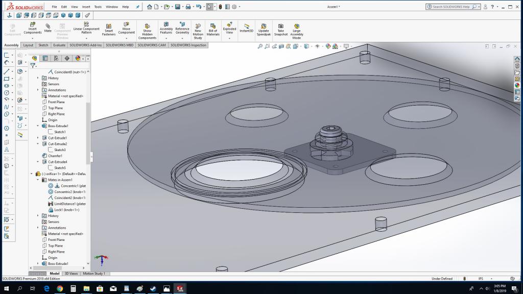

                      Flow bench design is coming along nicely. Going to try and figure out how to setup my Arduino for I2C so I can hook up a differential pressure sensor and digital calipers to automatically calculate my CFM/lift. Also looking into running a servo to automatically adjust depression. If it gets too crazy I'll go with a manometer/ manual setup. I'm not too worried about getting a 100% accurate CFM reading, as long as it's consistent.The Ametek vacuums I'm looking at will pull 28" H20 @ 100cfm each. Hopefully I'll only have to run two.. I also have a 3D printer on the way to test out on the orifice plate spring loaded clickety assembly
Name:	orifice plate.jpg

                              Made some flow bench progress. With my current vacuum setup I am pulling 17 in H2O through a 2" orifice. Mock cylinder is printing now...
