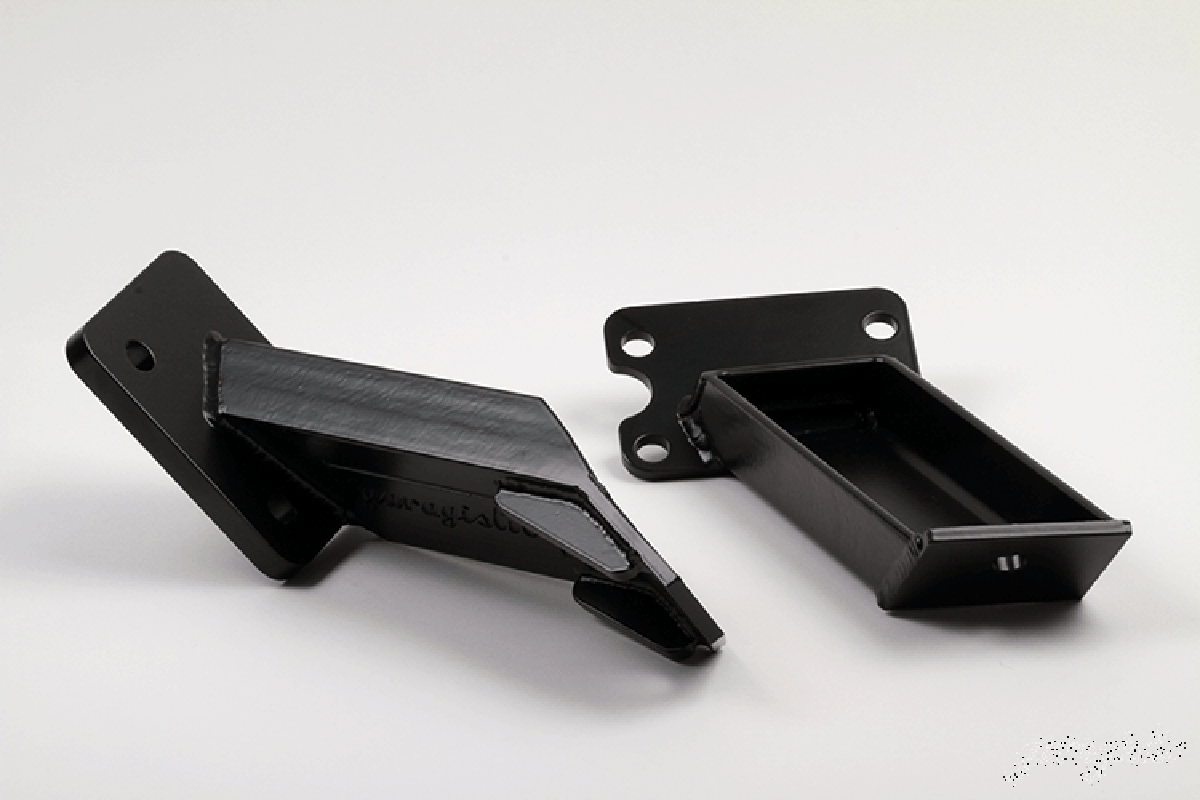

    Originally posted by AWDBOB
    What mounts did you get? I’d recommend picking up a set of Good N Tite mounts and asking him to make the passenger side mount for header clearance.
    Most m30 headers don’t fit in an e30 due to the angle of the dangle. Ive heard the ones that require the least modification are the BavAuto m30 headers which aren’t sold anymore. Both the IE’s and the Schmiedmann’s require modification. If you had the engine mounts I mentioned above, you’ll be better off but not out of the clear.
    Garagistics m30 mounts are whack in various ways, and the website claims they work with the IE headers but I’ve never actually heard of that working out. Perhaps someone can correct me on that.
    As far as mods go: do a nice cam (not regrind), headers Injectors, tune. IE makes two nice billet m30 cams that are spec’d pretty well and are affordable.
    If you’re feeling adventurous, go Megasquirt and ditch the AFM.

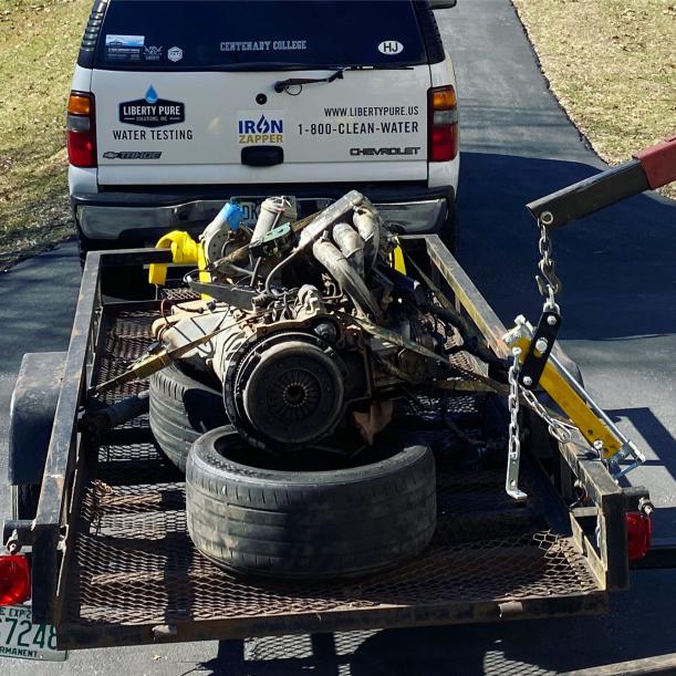

    I'm currently at school right now about 800 miles from the engine so I had my dad and uncle snag it (thankfully they both know what they are doing). But I'm really only able to go off pics at this point. Im going to megasquirt my M20 while building up the M30, and to learn how to tune etc. Might turbo the M20 first then swap it to the M30 later. Idk what direction im going turbo wise yet, but the M30 is going in eventually.

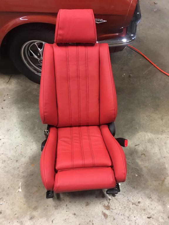

            finally got my seats done. They are okay for what the price is and Im happy to have complete seats again. 'Click image for larger version

                Seat looks good! Did you buy a skin kit and do it yourself, or an upholstery shop?
                    I bought the Lseat kit and then had a local guy do it for me. Took him about a week and a half so I assume it wasn't the easiest haha
                    Heres a link with it all isntalled https://imgur.com/a/8LPypLO

                        Has anyone used these mounts? I've seen no reviews for them, but they are cheaper than the other 300$ option..... https://e30goodies.com/product/m30-engine-mounts-e30/
                        Trying to get my E30 back on the road soon and start prepping parts for m30 swap. Going to order motor arms soon.
                        Edit: Bought them lets see how they look!
                            POWER YOUR E30 WITH THE LEGENDARY M30 B35 ENGINE! These motor mounts allow you to put the legendary M30 B35 engine into the great platform of the E30. That means the legendary M30 3.5 liter inline 6 can bolt into your E30! The M30 is a tried and true setup in an E30. Tons of torque, beautiful noise, and not to mention
                            Well these are made in the USA... also in Merica money, plus cheaper.
