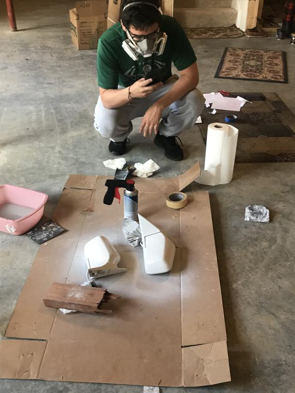

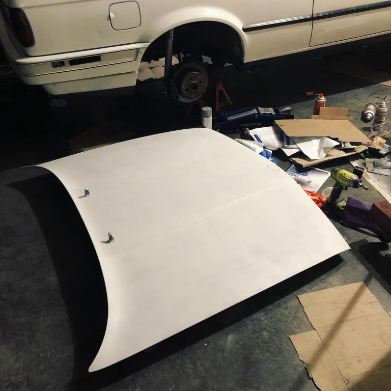

                Been awhile since I last posted. I bought a new fender to replace mine that was rusted through and have sanded it down and prepped it.
                Went in to do routine maintenance with the timing belt water pump etc, took about a month with large intervals to get everything off and redone.
                Seal kept leaking so I think its not mating well. Got some sealant and a new gasket otw.
                Started painting my hood that had some terrible grey paint on it. It's taking awhile! Hard to do everything I want in the time after work and weekends. I got a new nardi wheel and IE hub that I'm loving.

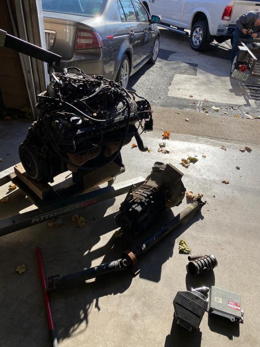

                      Sold my M52tu and bought a full M30 drop in swap for the same price. Guy I bought it from in NY said it came from an imported E30 M30. Had a misfire so I'm going to take it apart and see whats going on.
