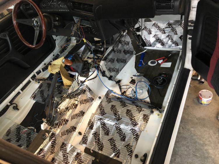

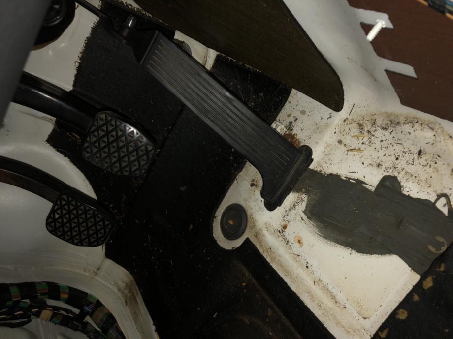

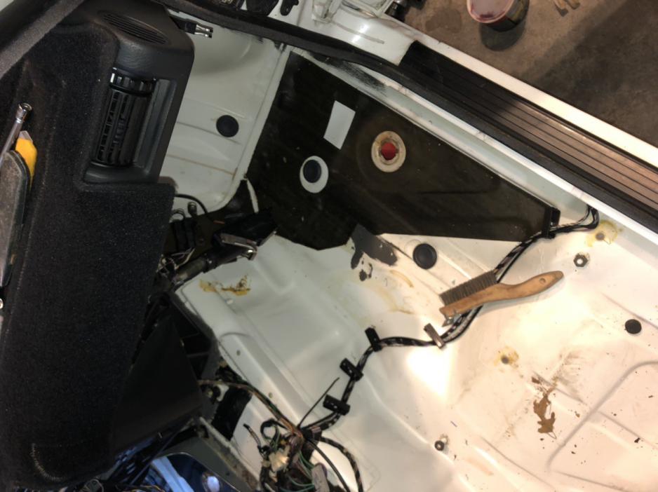

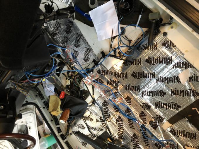

      Pulled the carpet because the rats nest of wiring doesn’t correspond to any of the wiring charts I’ve found. None of it seems to make sense so I’m running new wires, going to pick up a sub and an amp and go from there. Interior was pulled and looked FANTASTIC for what I was expecting.

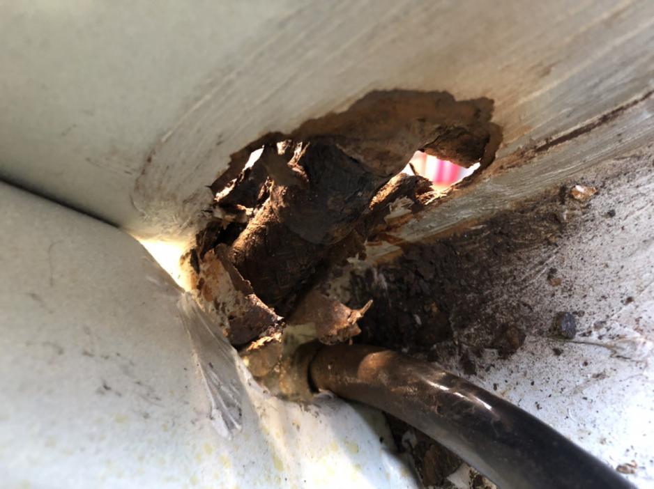

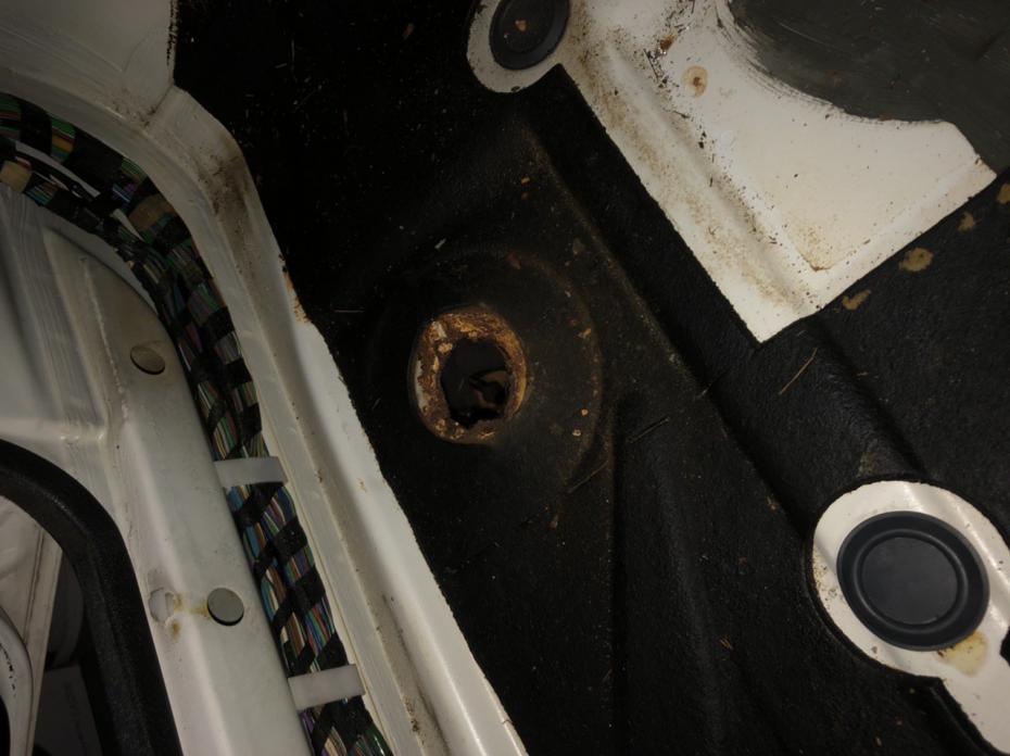

      there were three rust holes, a minor one on the passenger side, slight rust on the accelerator and a decent sized hole on the drivers side. POR-15 the whole lot while I figure out how to fix it since I can’t weld.

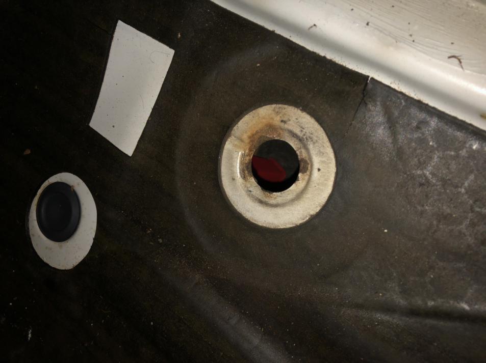

        #33

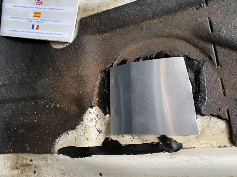

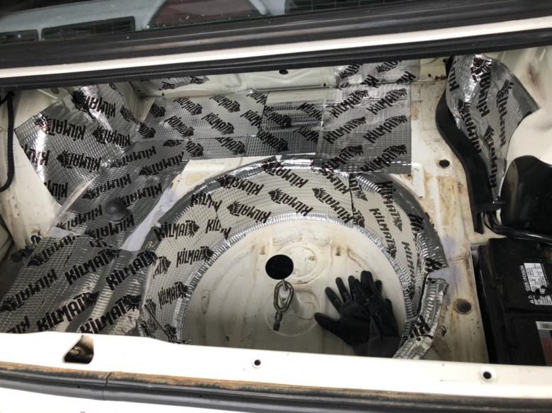

        So I found some rust.... apparently this is a common area for it to sprout up. Hard place to fix it and since I can’t weld I’m kind of at a loss on how to properly get in there and fix all of the corrosion.

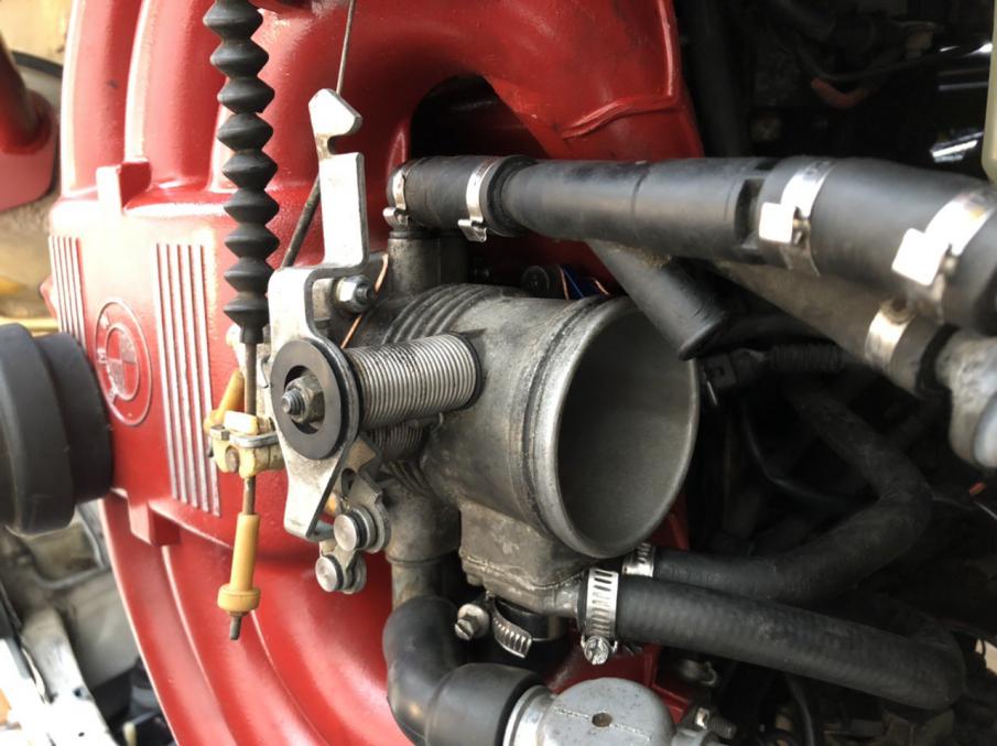

        also as I was wiring up an M50 TPS for Megasquirt my throttle body mounting point broke off. Thankfully one of the members here in Md had many parts I needed to fix up the car so I drove to get them!

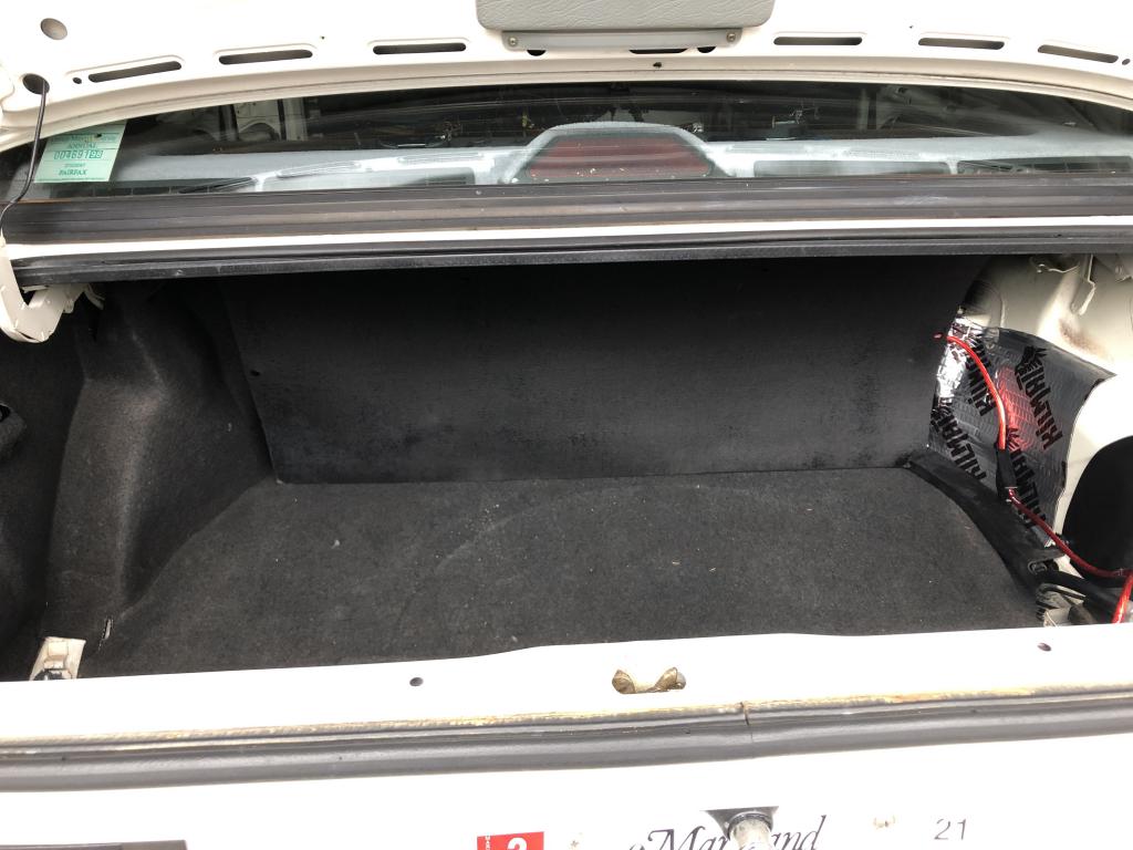

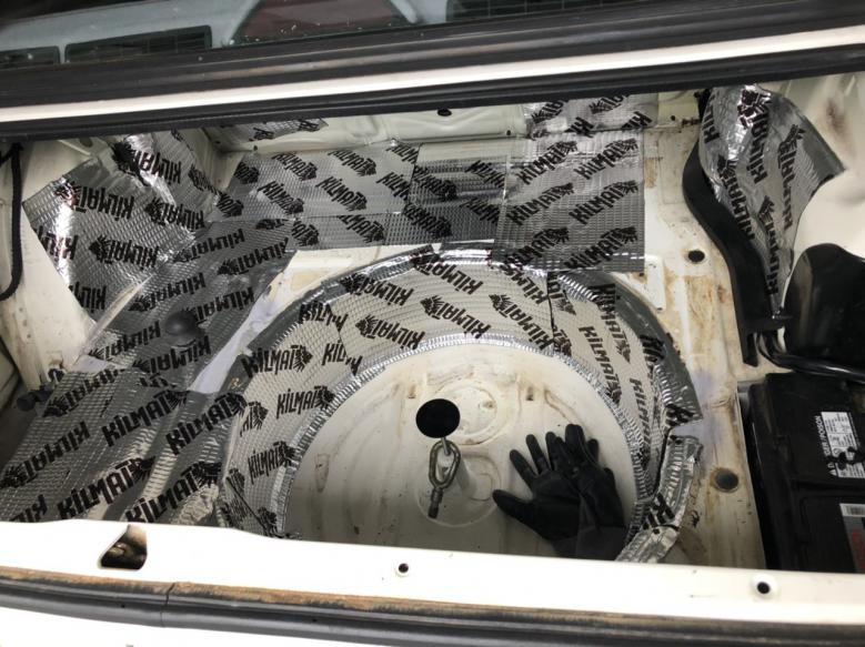

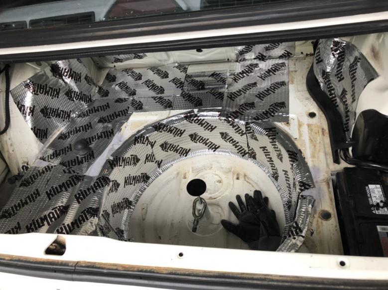

        finally I got the carpet out and died black, pulling about 75 pounds of trunk rubber out of the car was fun. Most of it came off in about two massive chunks so I didn’t see the need for dry ice. I’ve put kilomat most places and am starting to wire in speakers etc. I can’t for the life of me get the head unit wired up... can’t tell if the issues my wiring connections, the wires being wrong or something else.

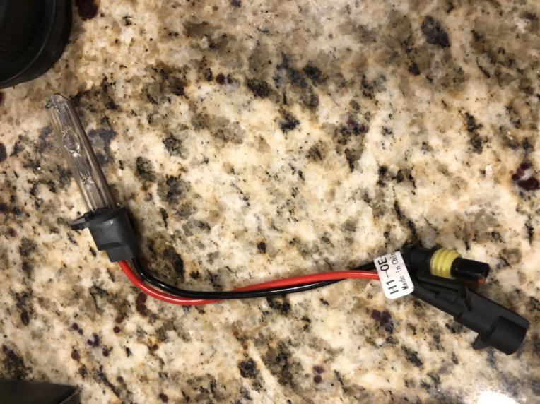

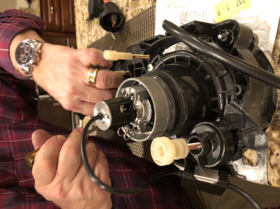

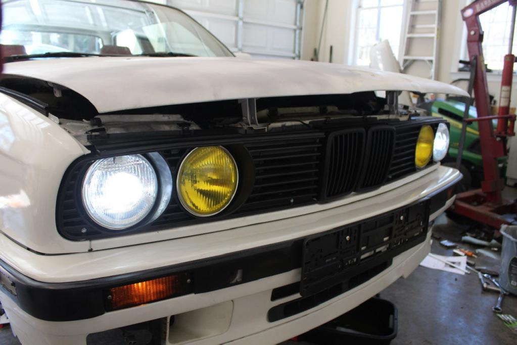

          And I added some Shadowline Motorsport LEDs in both high and low beams. Going to see if I can get both sets to stay on together.

            #35

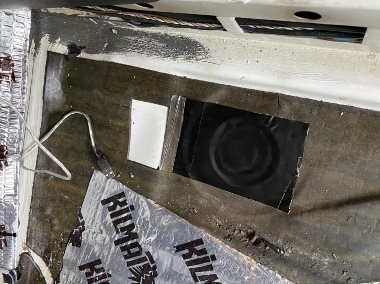

            Interesting fix for rust from my dad who apparently did something similar in the 80s for his rusted out beetle. Aluminum sheet, Roof caulk, weather resistant Gorilla tape and the bondo underneath finished with por-15. We’ll see if it lasts.
            (my choice was welding in metal but he doesn’t wanna do that for some unknown reason)

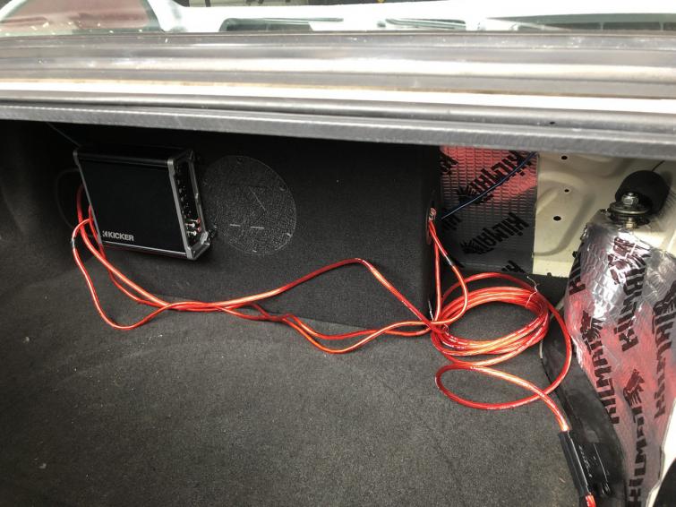

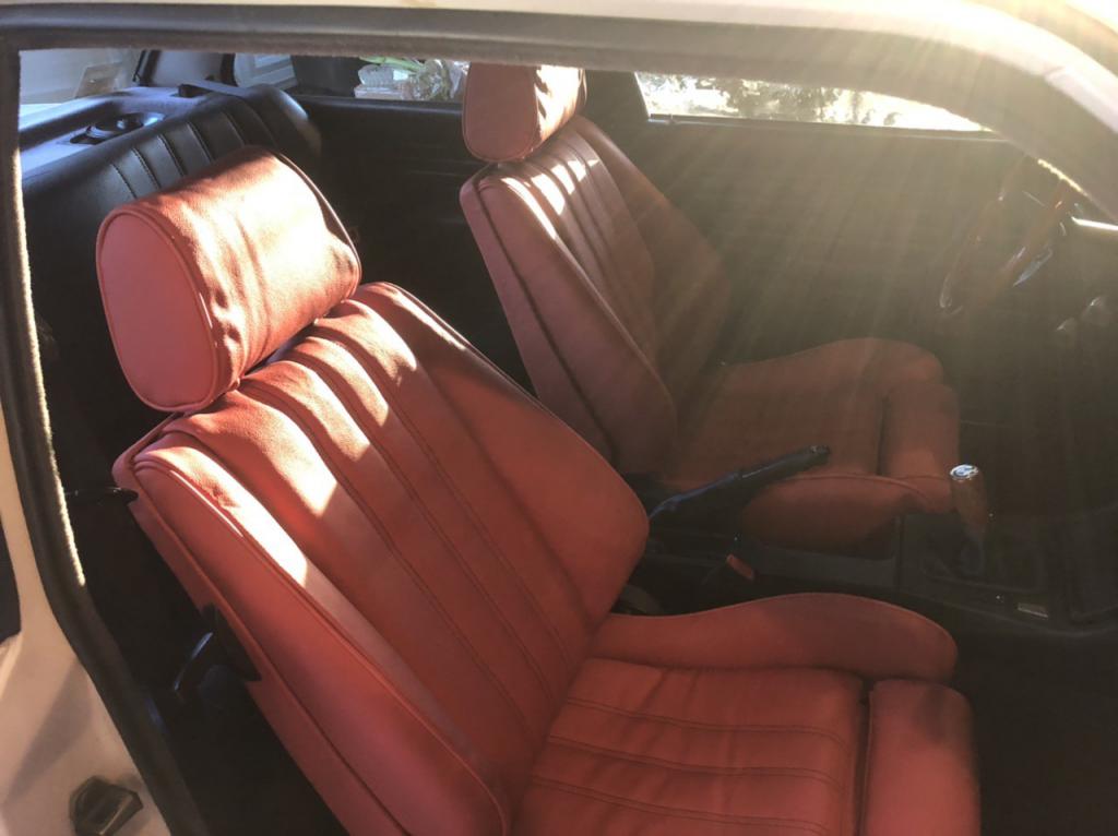

              Otherwise interior is all back together and working. Ran new wire and installed a new HU, speakers and sub. First time doing any of that and honestly it was super easy once I figured out what amp to run the Sub. The sub is kinda quiet behind the back seat so i may look for a ski pass.

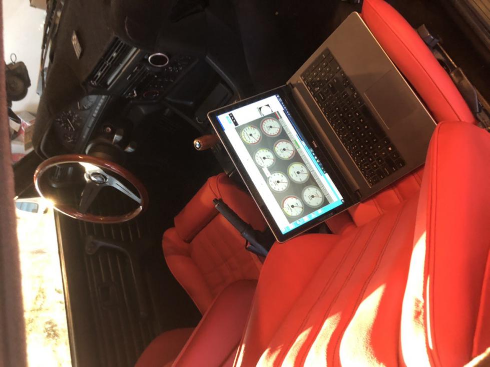

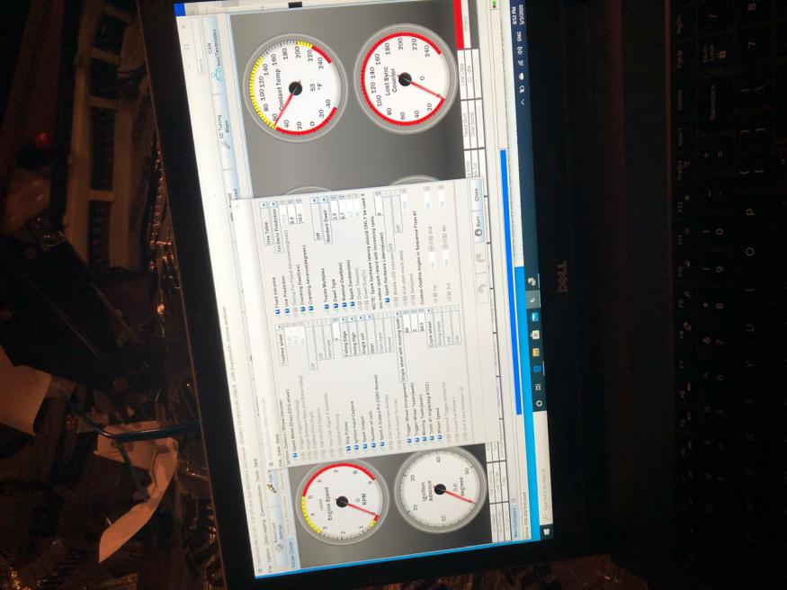

                Lastly I’ve been trying to figure out megasquirt on my car. Bought a PNP from whodwho, running a 14point7 AFM and O2 wideband. E36 TPS needs to be calibrated still, I think I can run my stock coolant temp right? Then just a GM IAT needs to get wired in somewhere.

                  Megasquirt installed and the car runs! Idles very high at like 1200 RPMs and is super rich. Unfortunately it seems my AFR from 14point7 doesnt appear to be working. Tried wiring into the harness next to the stock plug.
                  Maybe someone could give me a point as to where i went wrong.
                  This is the wiring chart for the O2 sensor.
                  I tied the Red 12v to the stock Green/blue.
                  Black went to the brown ground wire.
                  White went to a bolt on the chasis.
                  Green went to black for the signal.
                  I then wired the green wire inside the glovebox to my AFM gauge, drew the power from the cig lighter and grounded to the chassis. I only get 10AFR from both MS and my guage. My O2 is covered in soot so I know its really rich.
                  This is the 13point7 wiring diagram
                  Wire Color Name Connects to Note Red Power Switched 12[v] Use fuse holder, 12[v] should be live only when engine is running Black Electronics Ground Ground Ground where interfacing device is grounded
                  White Heater Ground Ground Ground to chassis or engine block
                  Green Linear Output Interfacing device; ECU/Gauge/datalogger/etc… 0[v] @ 0.68 [Lambda] Linear to 5[v] @ 1.36 [Lambda], equivalent to 10-20 [AFR] for gasoline fuel
                  Brown Simulated Narrowband Output Stock ECU if Lambda sensor replaces stock Narrowband sensor Stops Stock ECU from throwing out a Check Engine Light when Narrowband sensor is not detected. Switch point @ 1 [Lambda], equivalent to 14.7 [AFR] for gasoline fuel
                  Blue or Orange Sensor Temperature LED Output Long lead on LED to Blue wire.
                  Stock wiring diagram- http://www.megasquirt.325ix.com/MS_t...to_E30_O2.html
                  Maybe ive not calibrated it correctly. Going to try again to set it up tonight.
                  Late night edit: figured out I wired the brown narrowband signal wrong. Going to try again tomorrow!
                  whodwho has been very helpful in giving me tips. Slowly learning more about it all and I think my O2 is working but I’m just uber rich. Gotta lean it out, so more reading on Tuning!

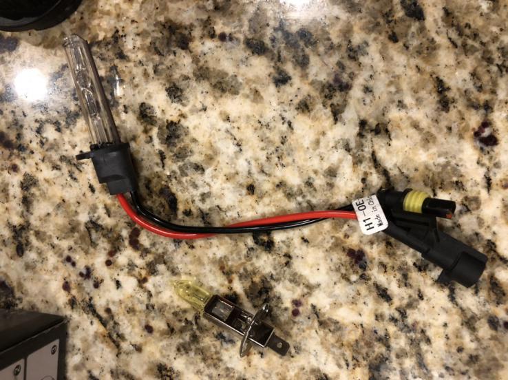

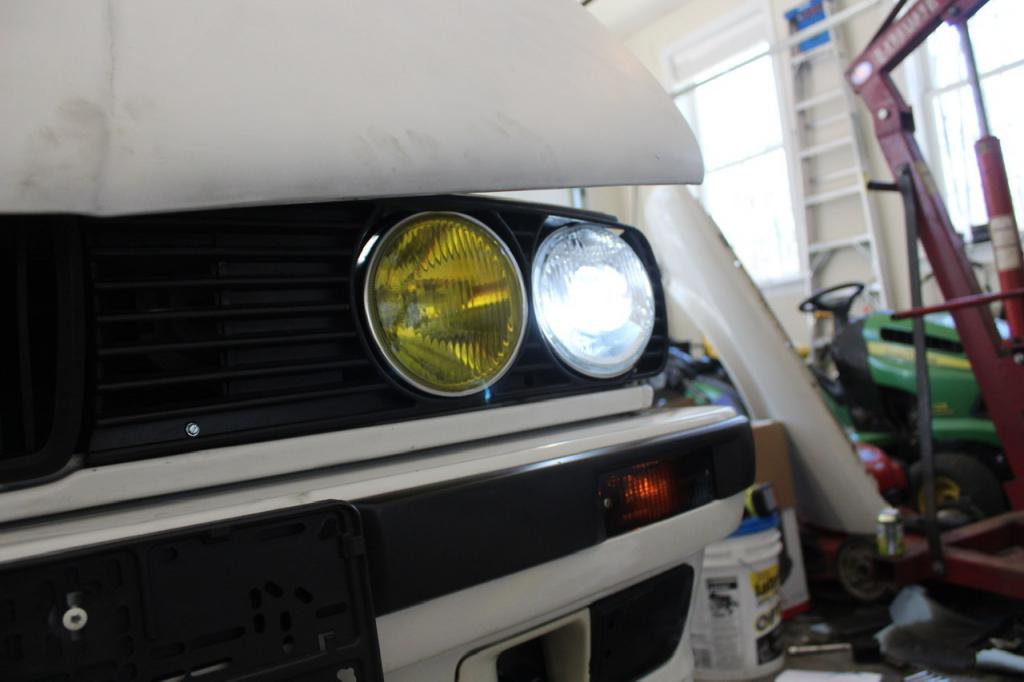

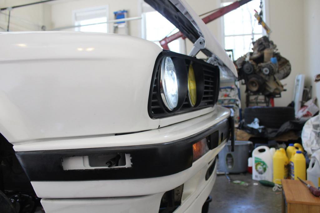

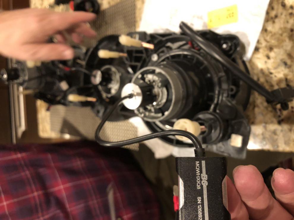

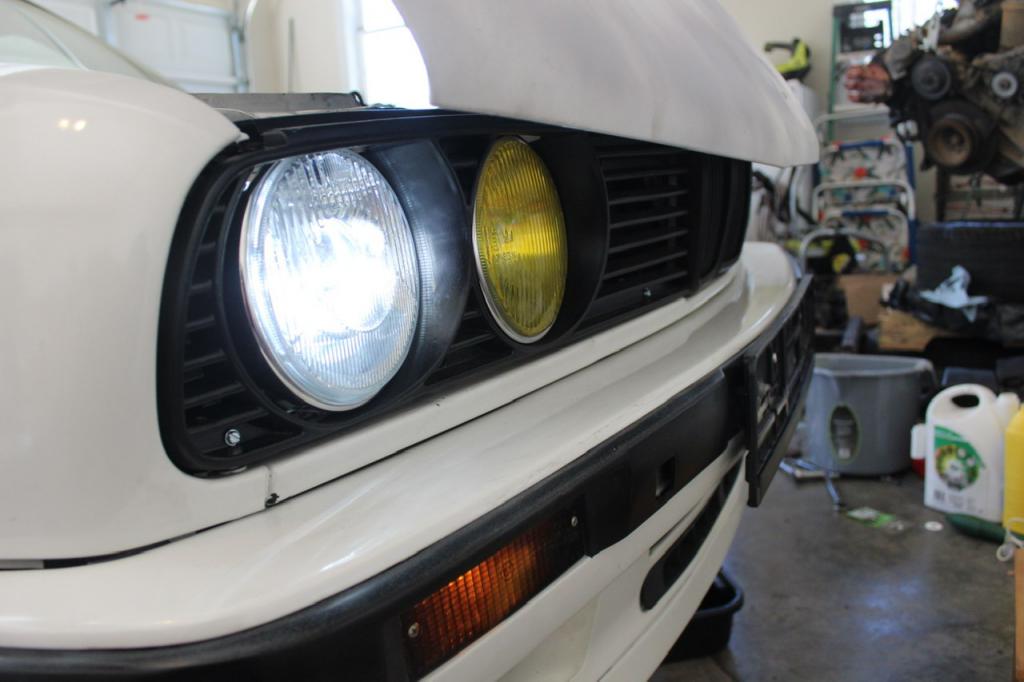

                    Installed my Shadowline Motorsport’s R8 LEDs and I cannot recommend them enough. Finally being able to see will be a huge plus, very bright compared to the ebay special the PO had. I went with the 6K slightly blue color. Wiring was simple, I cut the stock housing about an inch in diameter to allow for the larger box attached to the wires.
                    going to take these out late one night go to my local gym parking lot and see what the light distribution is and if it’s blinding to oncoming traffic. Better safe then sorry.

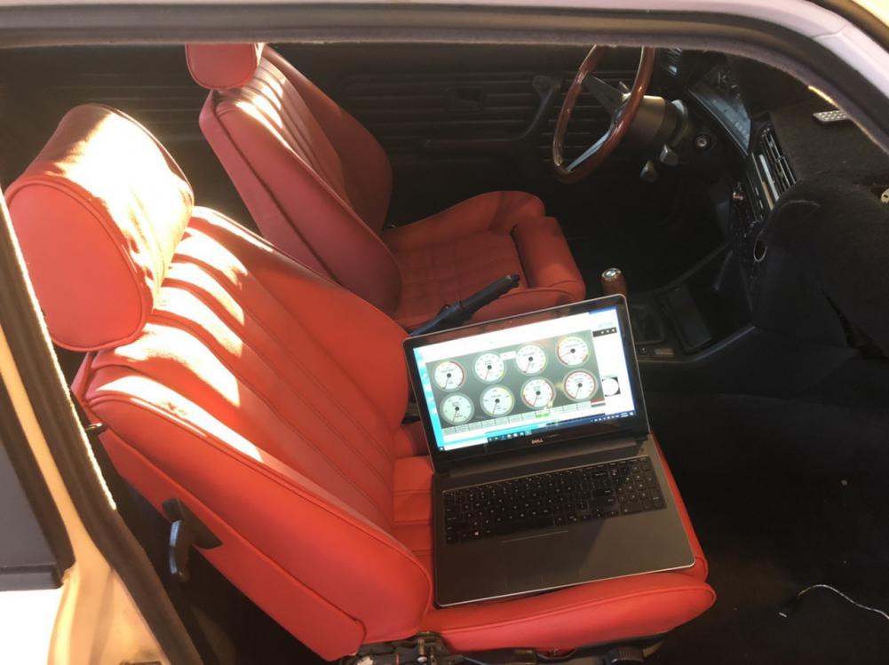

                      Can someone just comment if they can actually read my Megasquirt files? Trying to figure out how to upload them. My idle is god awful and I was hoping someone could look at my tune. My wideband readings dont even make sense to me as they go from 13.3 to 16.9 then to 10 within miliseconds and flat line. I advanced timing in hopes of trying to lower my RPMS by 1k but im afraid of advancing it too much.
                      I guess it doesnt hurt to go back and reread the manual + MS forums and maita forums.

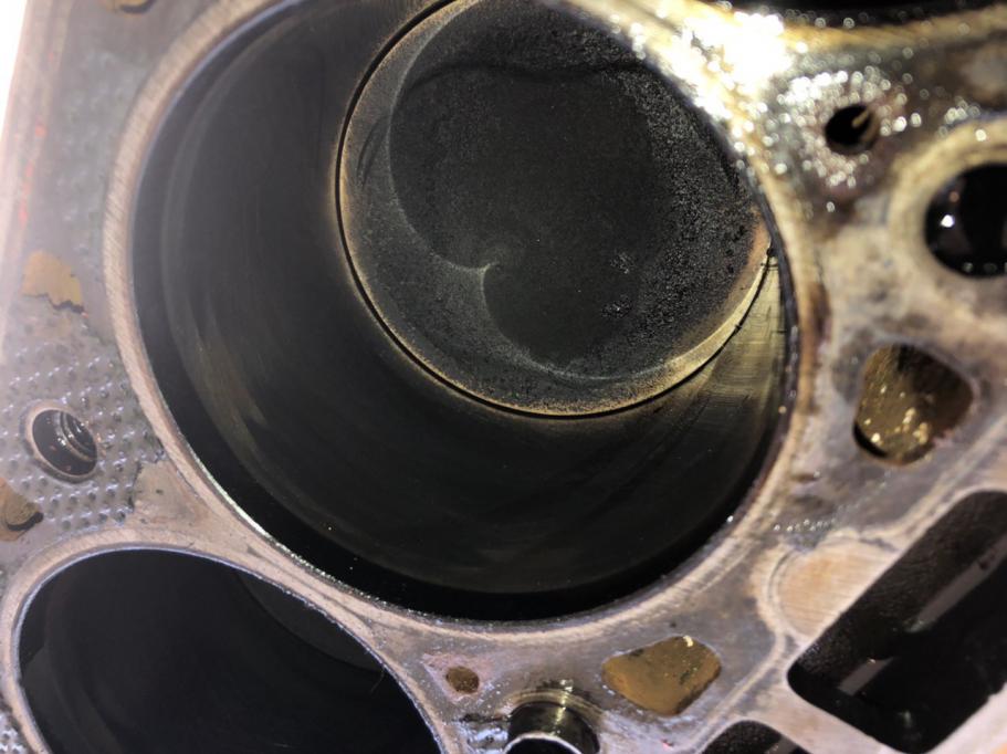

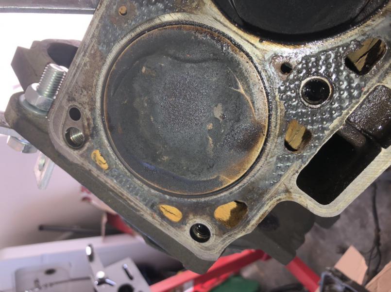

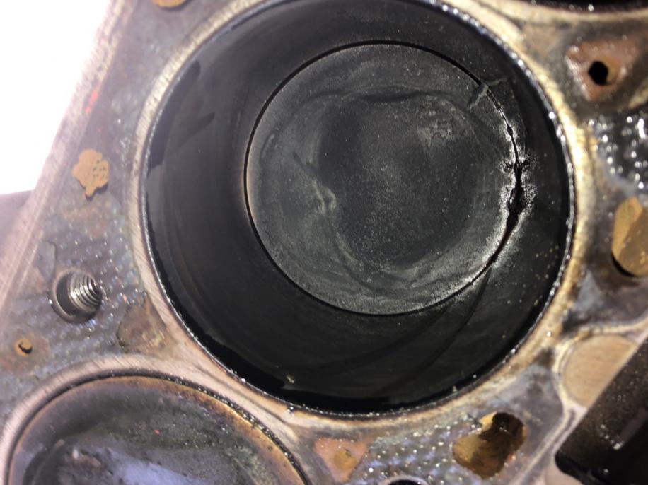

                        So I pulled the M30 head, intake, electronics and all the accessories. Head looks minty fresh, bottom end not so much but I think still looks solid. No scoring in the bored and every single bolt on the engine was hand tight or worse. Not one was torqued to spec besides the camshaft nut (is it 40mm? It’s fricking HUGE).
                        car idles great now, wheels were too tight on the calipers so I actually wasn’t able to drive it. None of the local stores had spacers so I had to order them. Needs about 5-10MM. Otherwise here’s a little photo dump.

                          Interior looks okay, kilmat makes everything much quieter. Idk why the older threads say stock is best, the new alpines and kickers + sub and all the kilmat I put in make a much better cabin.
                          I like it but the subs a little quiet behind the seats. I’m thinking of taking a knife and cutting the foam seats where the hole is and then folding and sewing the back seats apart at the ski hole so that it’s open.

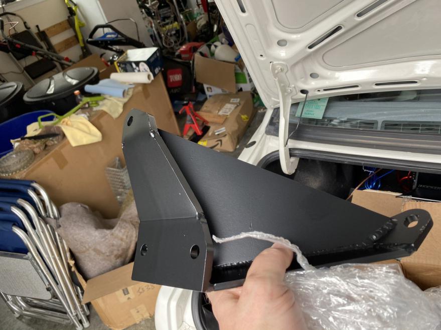

                            The motor mounts came in finally from the Uk. 230$ shipped I think from E28goodies. I trusted these more than the garagistic ones. Look good so far! (Powder coating was free)

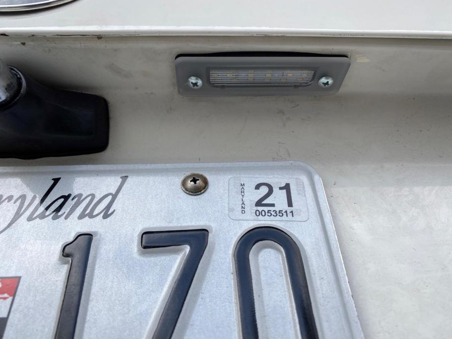

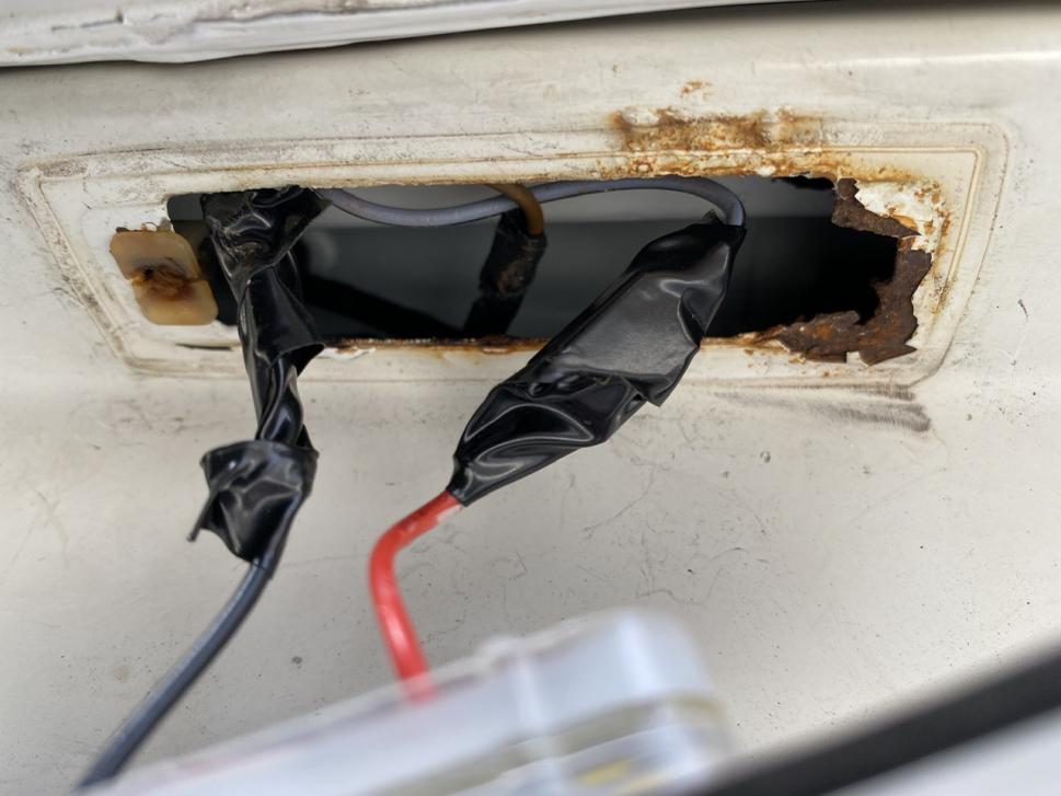

                              Buying some new parts during corona outbreak and dad replaces rear lights w LEDs (wanted to see what the change was like from stock on an inconspicuous location). And then yet again some rust repair
