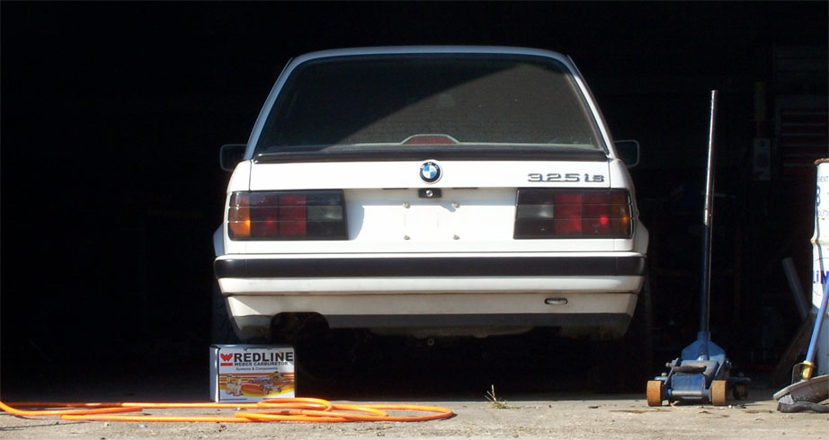

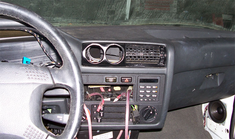

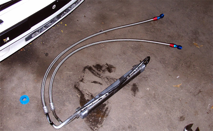

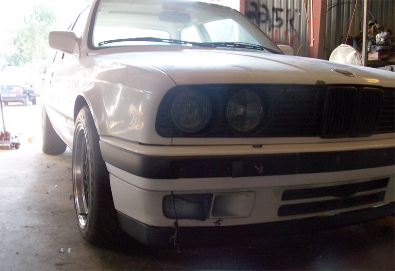

            'Nother update. (tired of watching LSU fuck up)
            I've been working on a lot of little things lately. I finished up the coolant system. Finished the oil cooling system. Put new Euro trim on along with my IS lip. Put the carpet back in the car. The hood is back on. I've got the wiring harness almost complete. I went through and labeled all of the wires on the ECU side and cut the ECU plug off of the harness in preparation of the standalone. I grabbed a pair of knock sensors and the plug/wiring that goes all the way to the ECU (since it is a shielded wire) off of a motor and put it on the side of the block. I've just been doing a lot of tidying up of the entire project. Also, the suspension has settled a little more even though I still have over 150 lbs of stuff to put back on the car (mainly at the front of the car).
            Enough of the explanation, here are the pictures.
            Oh, and for anyone who has been itching for an update on this, here it is.
            It's been hard to get time in to work on little projects like that. I expect to make a few more in the next few weeks since the overall consensus is that it would be better to do the 2 gauges with the spare vent instead of the 4 and no vents.
            Also, that gauge panel is up to the first person who PM's me wanting it. I would like to get 100 shipped for it.
            Jon
