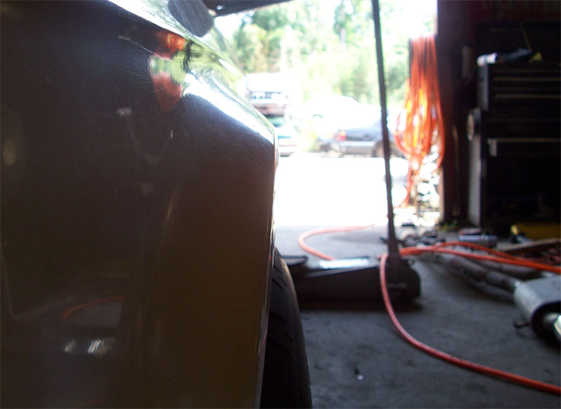

      Well, I found someone local to me that had an Eastwood fender roller. I rented it from him and it worked like a charm!
      Before:
      After:
      It will definitely give me a little "cushion" once the suspension is fully settled and the car actually has full weight on it.

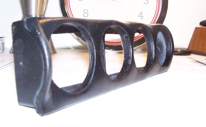

                      Ok, goody goody picture time!
                      Since I know that a lot of people don't like the thought of losing their center vents, I have decided that I will make a few of these:
                      I'm not sure how many I will make yet. I will be offering them in the two gauge setup and the 4 gauge setup. I'm not sure on the pricing yet, I will figure that out once I actually finish the 2 gauge cluster and see how difficult it will be compared to the 4 gauge.
                      My 2.9L Build!

                        #116
                        You should angle the faces slightly!
                        Killer build man. im excited to see it run!
                          +1 on face angle.
                          your build is amazing btw.

                            #118
                            Thanks for the kind words guys.
                            I tried to angle the gauge holders as best as I could and when I test fitted them in a spare console, I noticed the console is angled towards the driver, that plus the angle that I had the holders at, equals perfect angle for viewing.
                            Anyone interested in a vent gauge holder?
