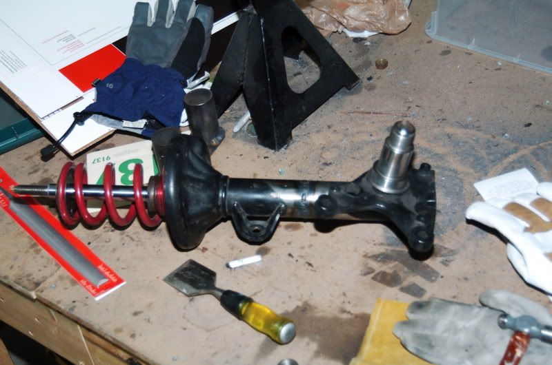

        little update, Since i havent really had a large amount of time to work on it, i have started making the measurements for the coilovers, and hopefully soon i will be able to finish a front strut and then jig it up so that i can start making the front 4130 control arms. Ill be ordering the bearings and tubeing soon to.

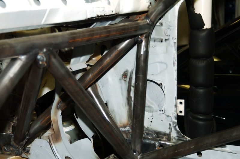

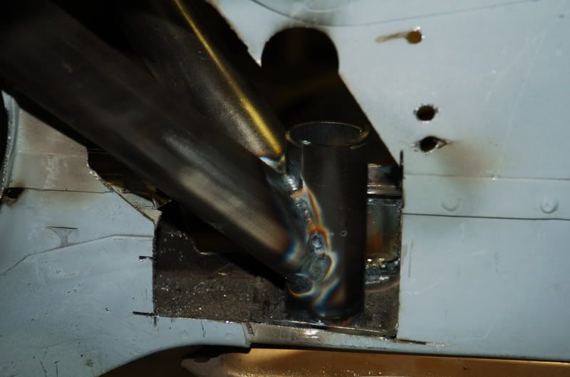

                      The passanger side front is almost done, i have to get one of the strut tower bars bent and then the front pass side will be done :D
                      I decided to work on the coilovers on friday, i shortented the struts a total of 3 inches to get the most travel out of the struts while also lowering the the car by not running spacer in the strut tube

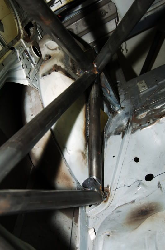

                      I sticted the rear fender to the cage to. to help tie in the rear frame rails into the cage

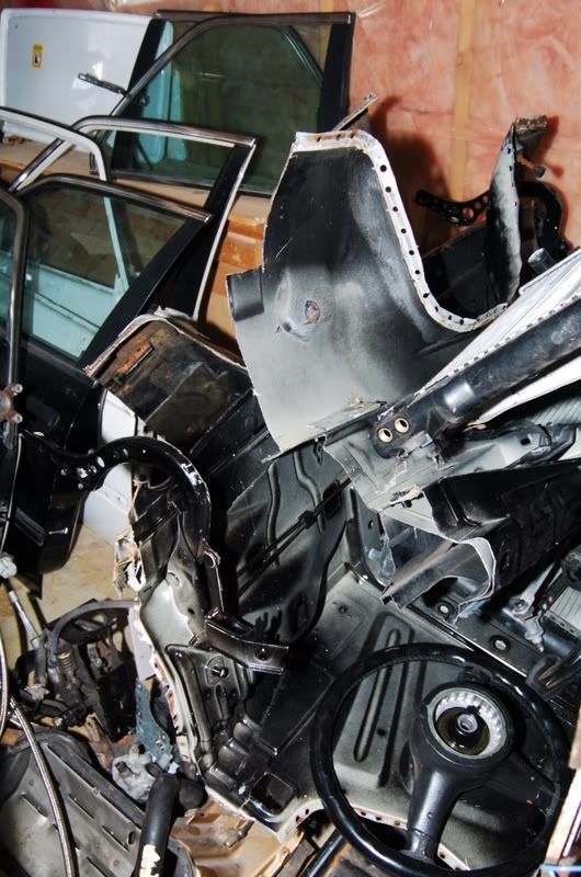

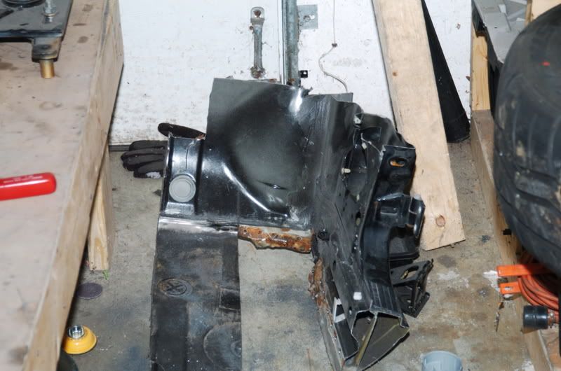

                      Now i introduce my second e30, well whats left of it. All the spots that are all cut up have replacement pieces
