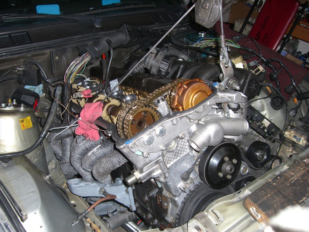

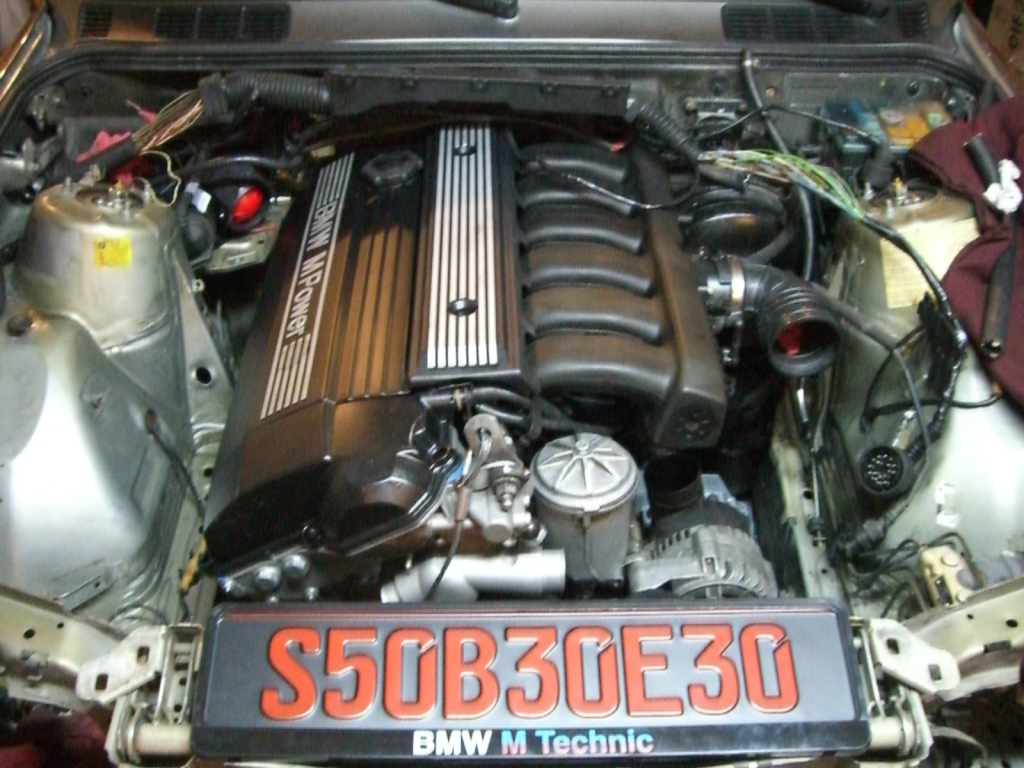

    UPDATE: ok mon-sat this week i have been at it on the swap. last nite i finally got the motor seated onto the mounts at about 3am, took some pics yesterday, thought i would share...

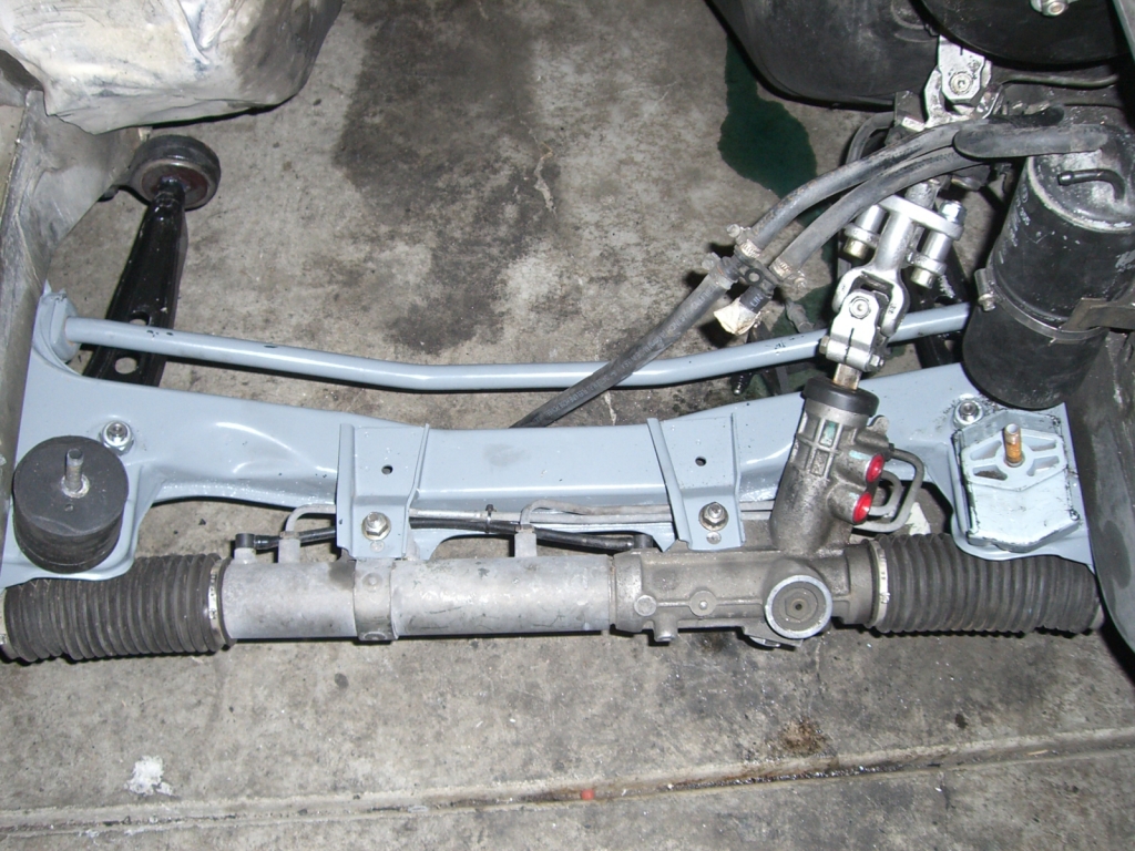

    fresh subframe+ z3 1.9L rack installed and ready with AKG knuckle mod installed.
    headers installed, with nice shiny new coppers...
    wiring harness ready, used my old m20 c101, and soldered it onto the s50 harness with the help of Aaron(cahomey), thanks bro!

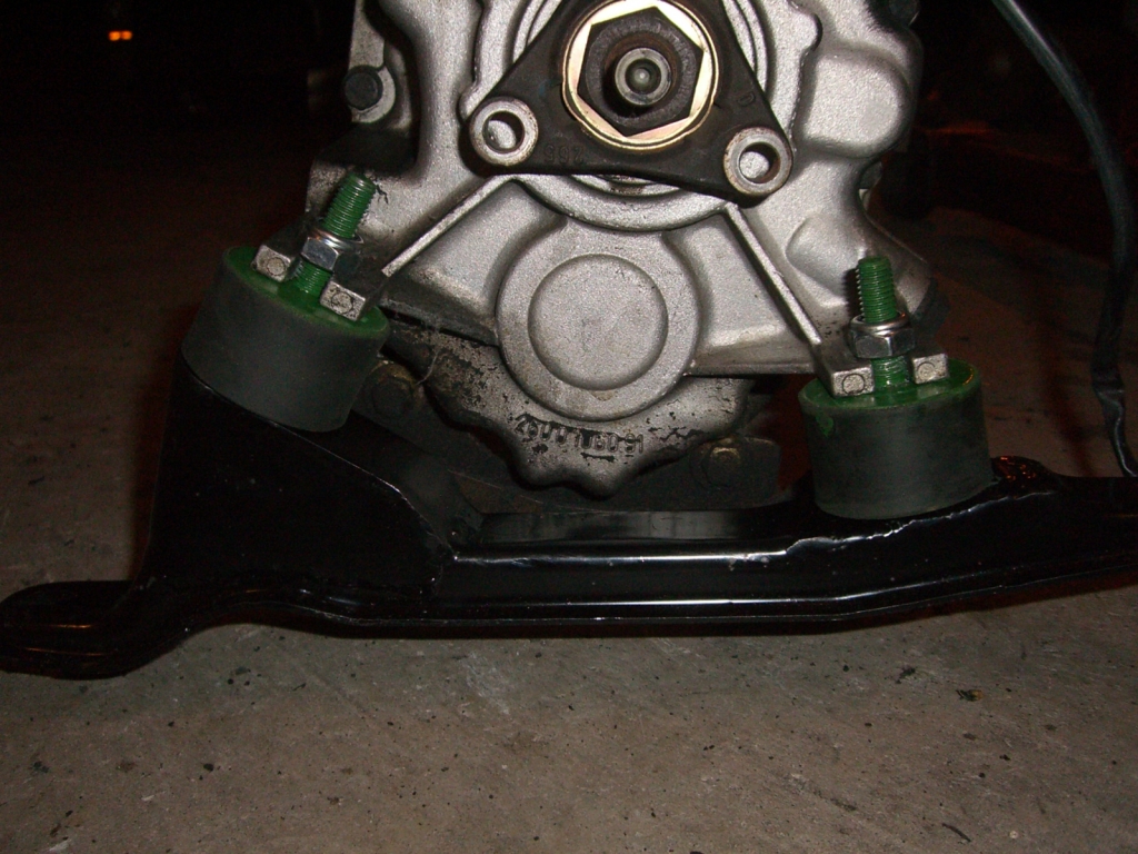

    Dougsic tranny brace installed with e21 mounts.

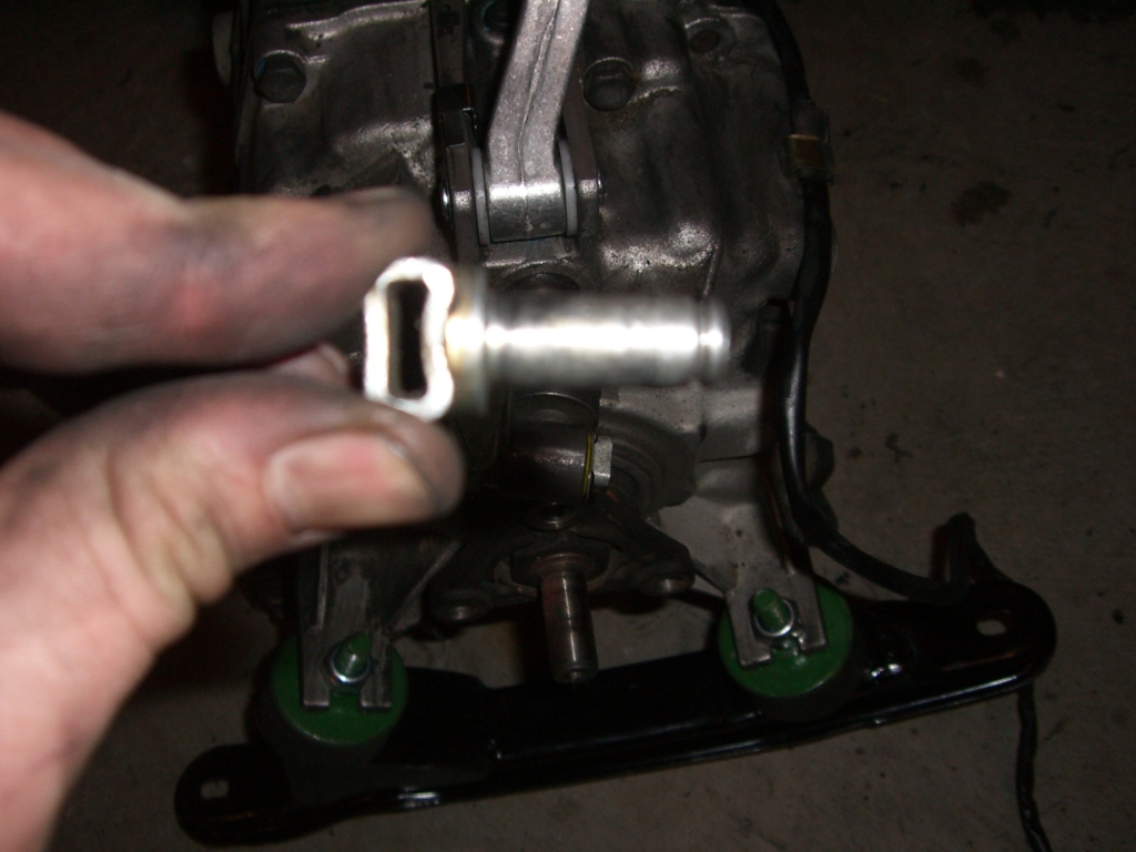

    selector rod bent up for clearance, and twisted 10deg to compensate.
    had to pull the fuel rail + valve cover for more clearance @ firewall.
    OH YEAH BABY, SHE IS IN!
    c101 hooked up, looks OEM. also you can see my IX booster installed w/o adapter.
    IX clearance @ intake manifold. didnt shave any fins, its pretty much touching...
    header clearance @ subframe. i have the mount spaced up about 1/8", headers pretty much sitting on subframe b/c of the wrap.

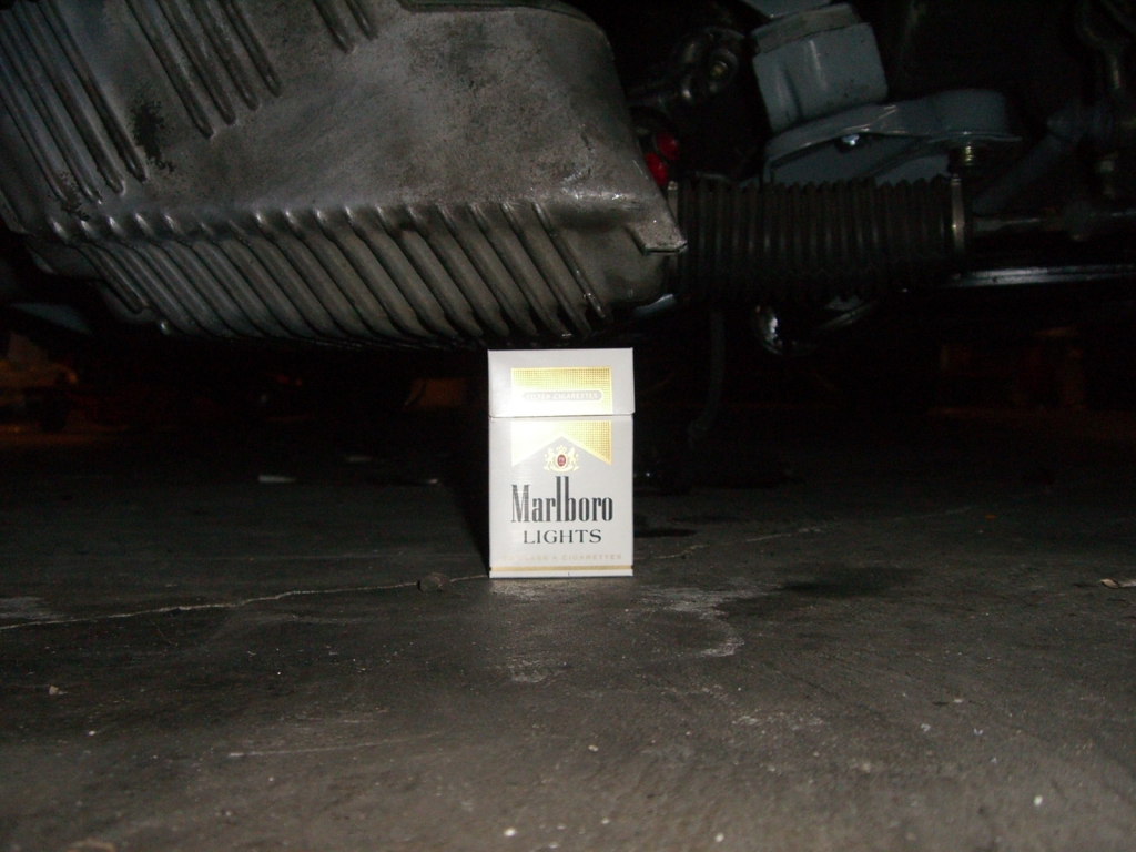

    oil pan is damn low on these motors...suspension isnt even settled yet, just dropped the car on the ground in this pic.

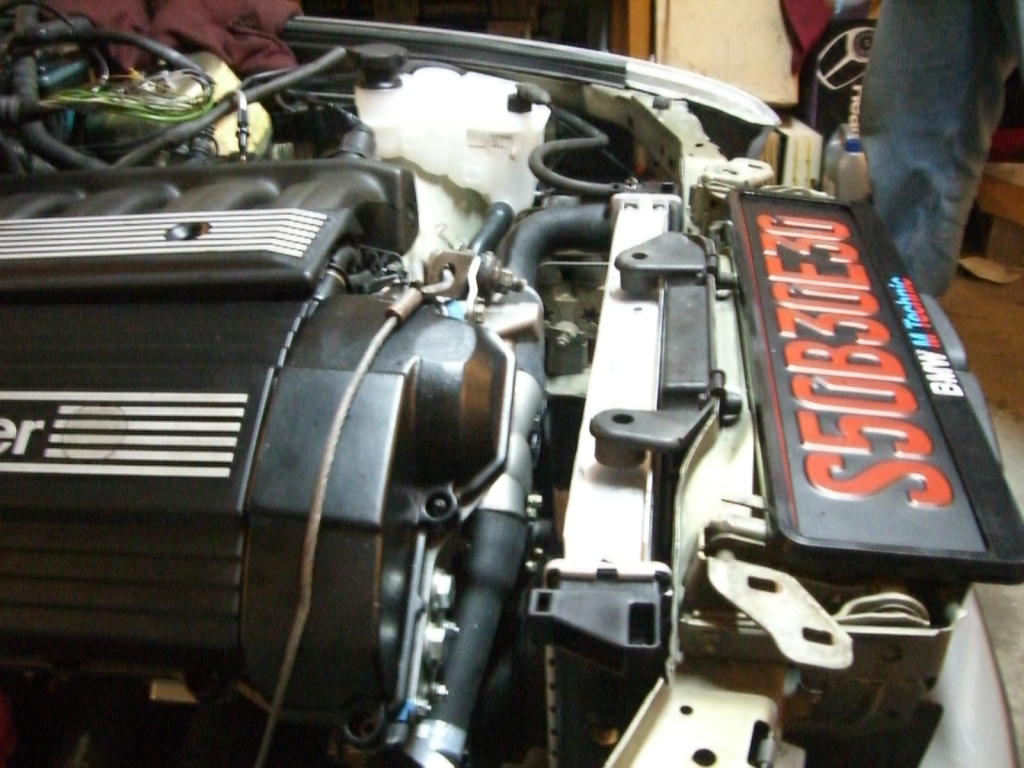

    got the cooling system installed, new rad, new coolant tank....bling bling!

        to cheap for some heat shrink... :mrgreen:
        sounds fun... im jealous.

          I was not supplied with a large enough heat shrink tube.
              :nice:

                sick build! that thing is gonna be fast.

                  don't forget to take the rag out of your intake ;-) nice build

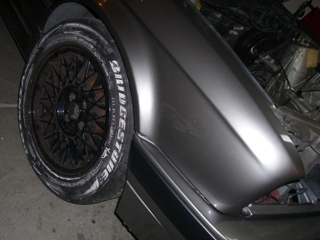

                    You should paint the "Bridgestone" onto the sidewall with paint markers

                        Nice. I want to see if my extra .2L is just a lil faster! Looks clean!

                            Next time: No adapter plate for the booster. Fuck i might even do that before i finish the car (which is like this weekend), i would just hate to waste half a bottle of that sexy blue brake fluid...i bleed em yesterday : (
                            Thanks for that pic!
