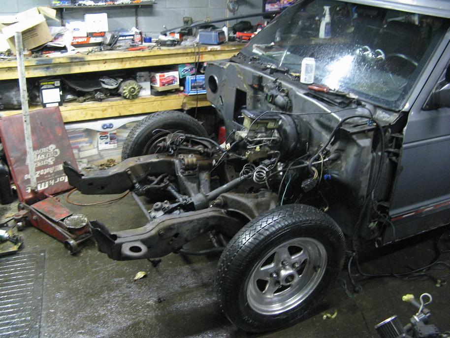

      Onward to the next thing....
      So i'm starting the 383 stroker swap in my S15. Not much to see, i took the front end off and i'm starting to tare into it. Going to change it over to manual streering and brakes. Plus i'm eliminating the AC and heater. There's not going to be any fenderwells in it either since i got fenderwell headers for it that will be open all the time.
      The motor is a run of the mill 383 stroker 4 bolt main. .600 solid lifter cam, Harland Sharp 1.5 roller rockers, World Product Sportsman heads that have been ported and valves will be punched out to 2.08 1.60, still need to do the valves they are at 2.05 1.60 now. Milodon gear drive, CSR electric water pump, Mallory dist, MSD ign, Eldelbrock McFarland Torklink intake, 850 carb. Trans is a TH350 with a 5000 stall converter. I'm undesided on the rear. I got a Dana60 that could be narrowed down.
      I just pressure washed it and was messing with it.

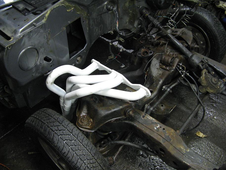

      Just seeing what the fenderwell header will look like.....

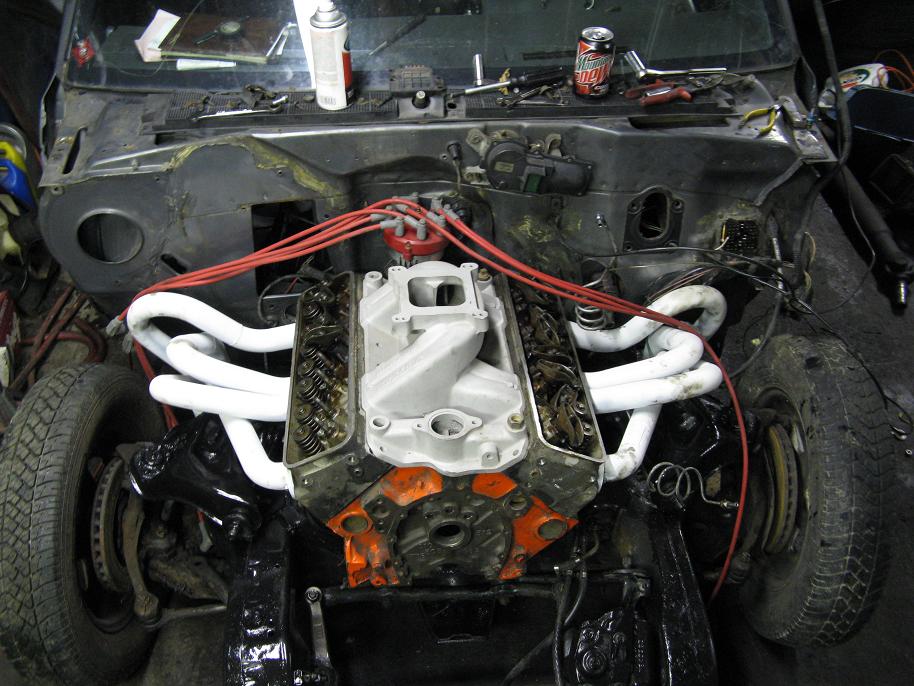

            #35
            Sat a dummy block in it to check for clearance issues before i start to clean everything up and what not.
