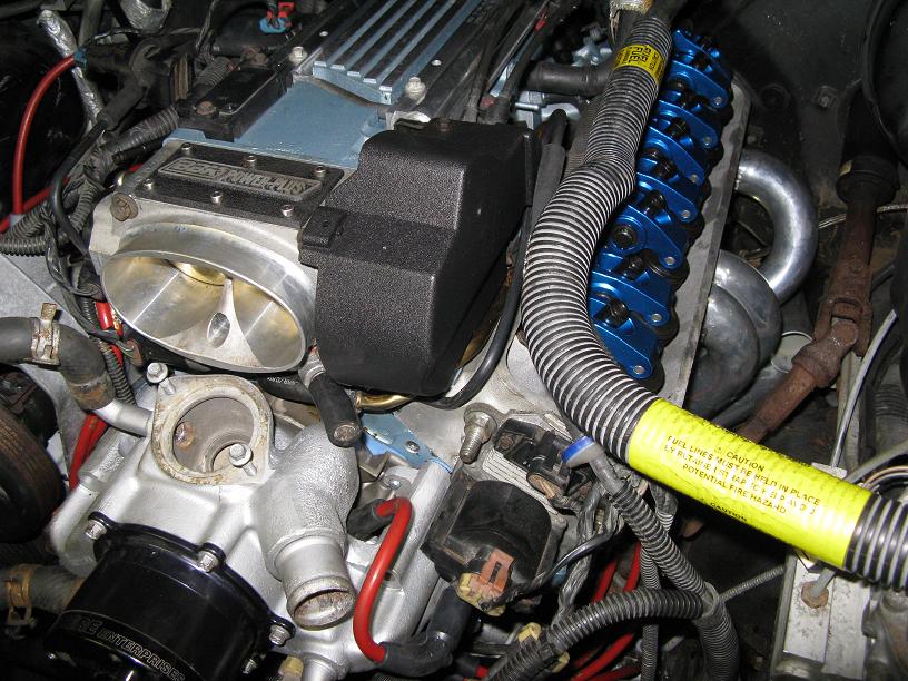

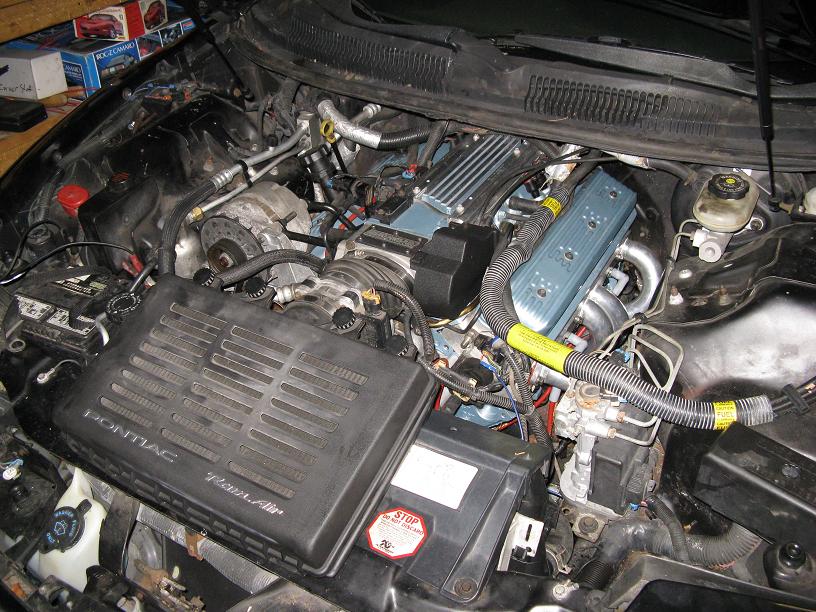

                      Started to work on the Firehawk again. Put the trans back in it and ordered some more things for it,
                      BBK 58mm TB
                      Comp Cam chromemoly, heat-treated, 5/16" pushrods
                      1.5 roller rockers
                      New GM opti spark
                      Auto Zone LT4 pressure plate with McLead clutch disc
                      8.2mm Taylor plug wires
                      C5 vette wheels 17x9.5 front, 18x10.5 rear.
                      Things i still need to get:
                      radiator
                      160 thermostat
                      4.10 gears
                      tires
                      PCM reprogramed
                      few new sensors
                      spark plugs
                      and a 3" X pipe kit off of Summit
                      Some spects on the engine, cause i don't think i listed it:
                      LT1 with a Eagle 383 stroker kit
                      stock heads that have been ported, Comp Cam valve springs.
                      Comp Cam CC306 (Duration 290/307, Lift .510/.540)
                      Cloyes double roller timing chain
                      Stock intake ported matched to the heads with a BBK 58mm TB
                      Meziere electric water pump
                      Jet Hot headers (Hooker Header design)
                      The wheels (should be here this week)
                      pretty valve train
                      And i covered it up with the stock covers painted Pontiac blue to match the rest of the engine.

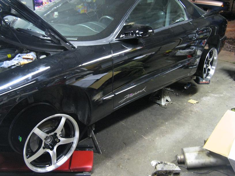

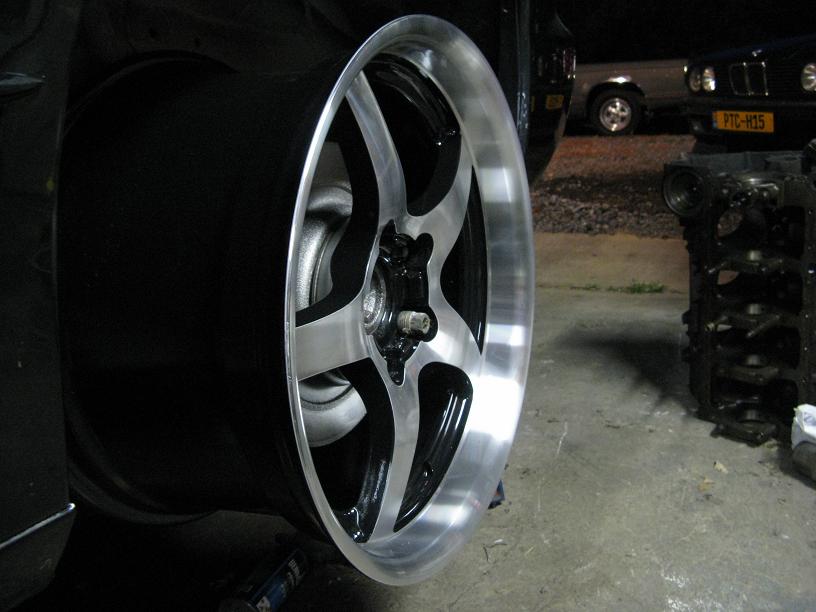

                        The car is dirty from sitting around. But the wheels got here today. i just flopped them on, and the centers aren't pictured. But i kind of like them without the centers. I think im going to get 275/45/17's for the front and 295/35/18's for the rear. I could put 315's in the rear but some "work" would have to be done to the wheelwells.

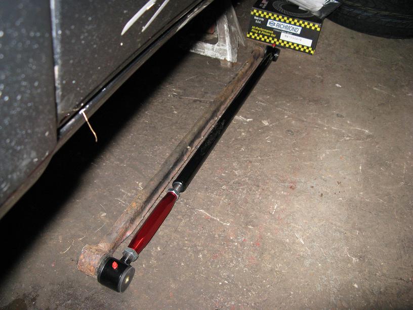

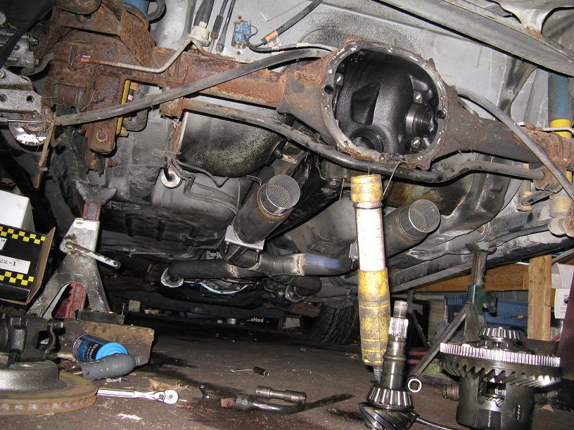

                          Ordered the rest of the stuff for it
                          4.10 gears
                          adj. panhard bar
                          radiator
                          160 thermostat
                          tires 275/40/17 front 295/35/18 rear
                          exhaust
                          and sent the PCM out to Madtuner to get reprogramed
                          I put it all on exept the gears, panhard bar, and the rear wheels/tires.
                          I did start the car with the untuned PCM and open headers in it and it fired off. So now i need to wait for the PCM to get back and i need to put in the gears and it should be ready for the road. Plus a good cleaning cause it looks like a mess in the pictures. And the garage will get a good cleaning too.
