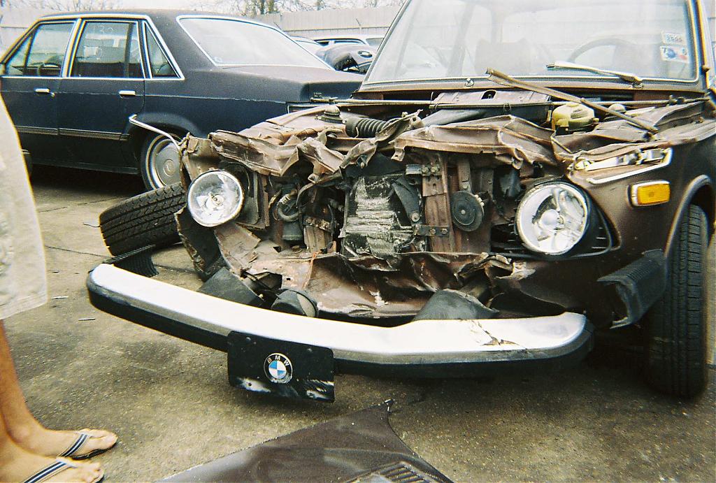

                      Just for kicks - here's my first 02 that met a drunk driver.
                      • moatilliatta
                        • 6158
                        that prolly would have been the first time my pistol whipped a drunk driver.
