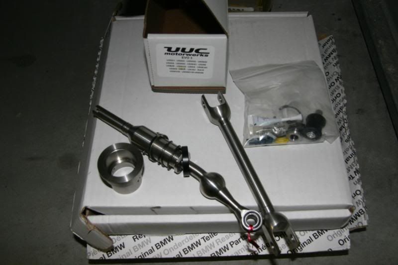

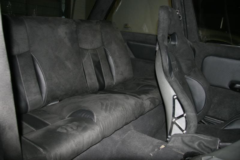

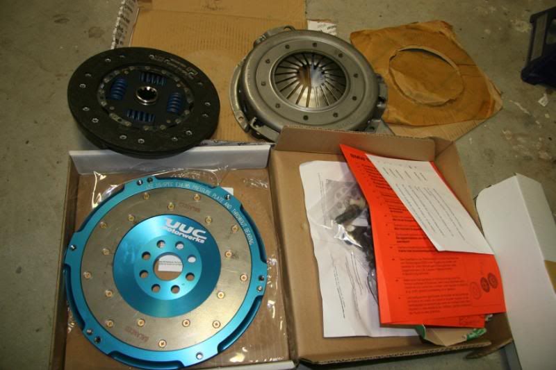

                                More updates
                                Got my rear seats back
                                And my clutch(M5), flywheel(Stage 2 alumin), and shifter came from UUC
                                '89' E30 with Euro S50B30
