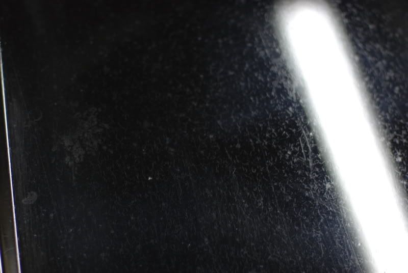

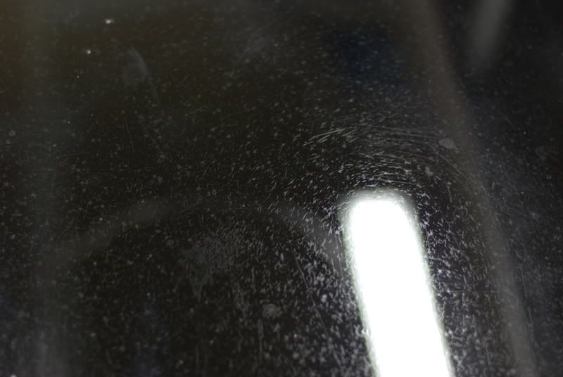

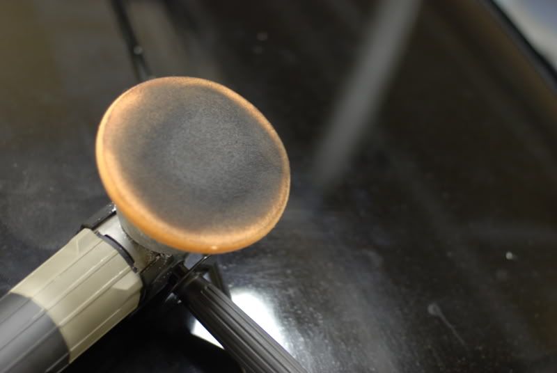

So as I pulled the car in...I got tired of dealing the engine at the moment and decided to see how sore I could get my arms with the Porter cable on the hood...here are some shots:
Easy to see what was touched...now I gotta try and get my hands on an orbital as that may actually bring the paint back better...
How about those paint imperfections:
BMWCCA #389756
wetsand first with 2500 grit, then try buffing with a good polishing compound and down from there.
Looking at the pictures again it looks like the paint is shot and filled with all those cracks in the clear.
Its hard for me to tell from pictures. if the clear coat isn't cracking then i say your good with the wet sanding.Comment

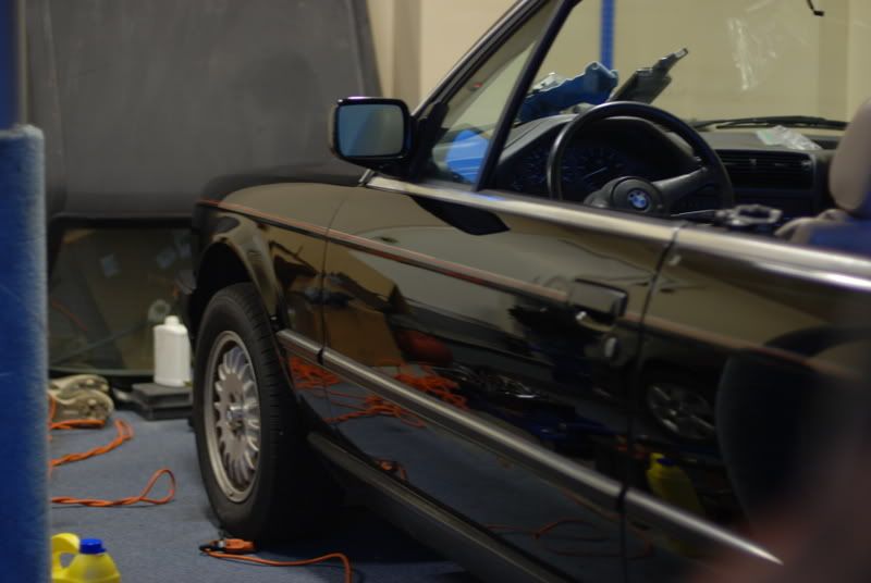

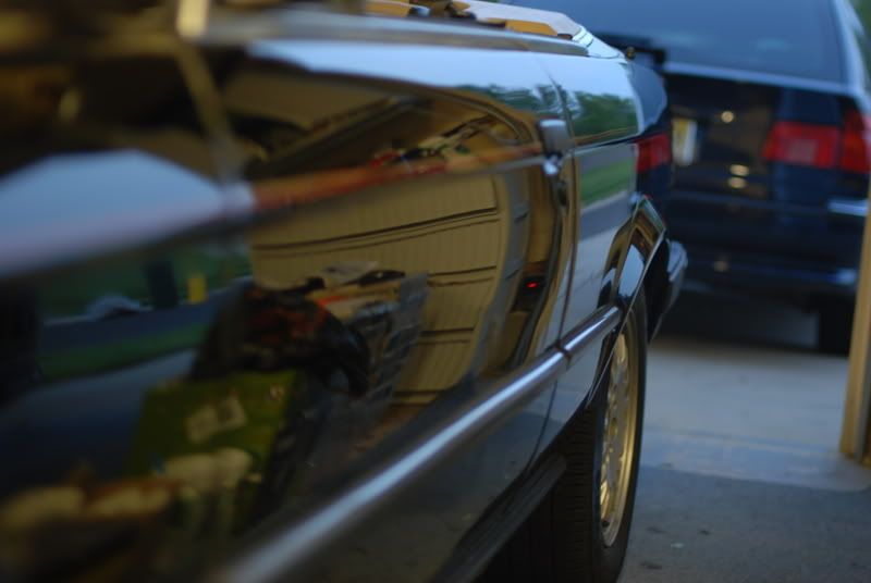

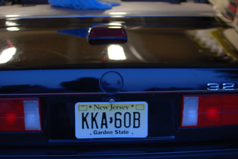

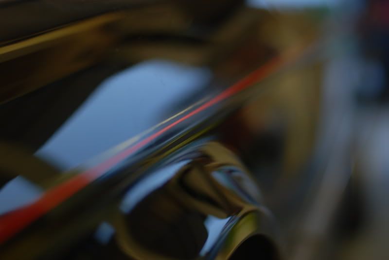

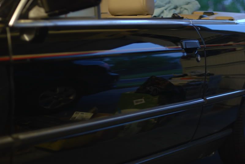

Well...after getting semi-motivated...I cleaned out the garage...pulled out the vert...wiped her down...and started with the PC7424....here are the results:
Now...if only the paint on the hood/trunk were just as good as the doors.... :/
The car is not completely done....this was just compound on the driver's side...she'll look fairly good...considering she needs a new paint job:BMWCCA #389756
