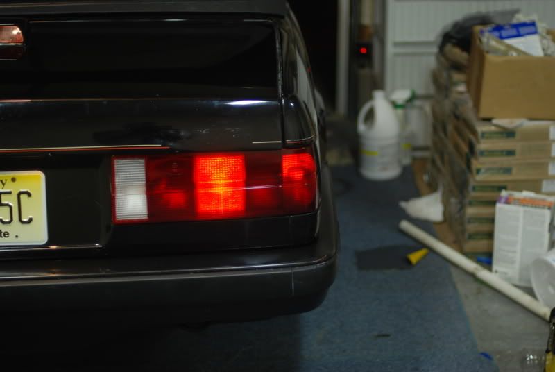

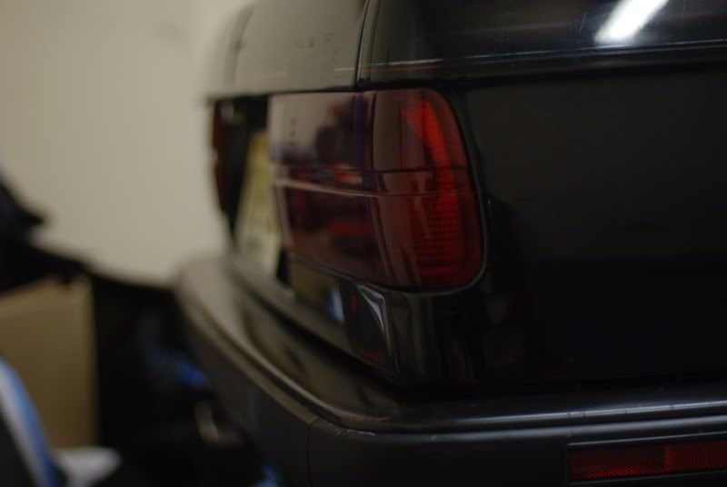

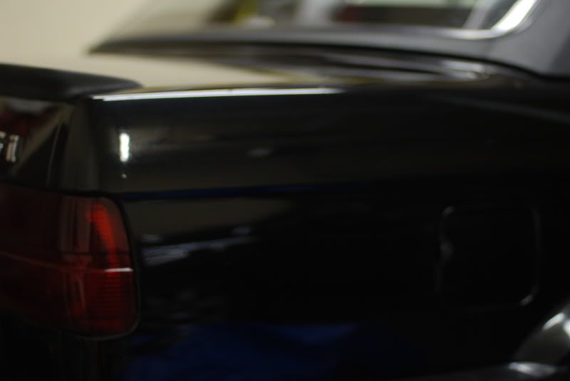

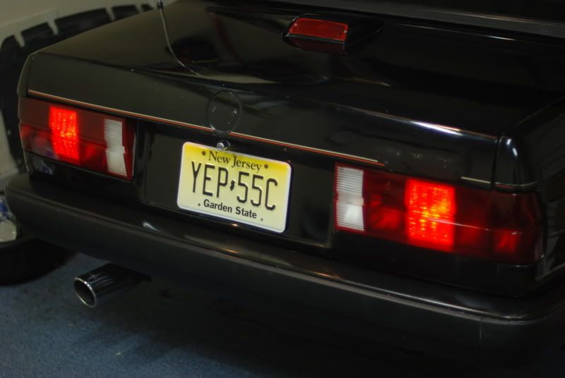

          Finished the tail lights....
          I think they came out pretty nice.

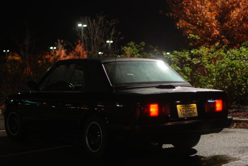

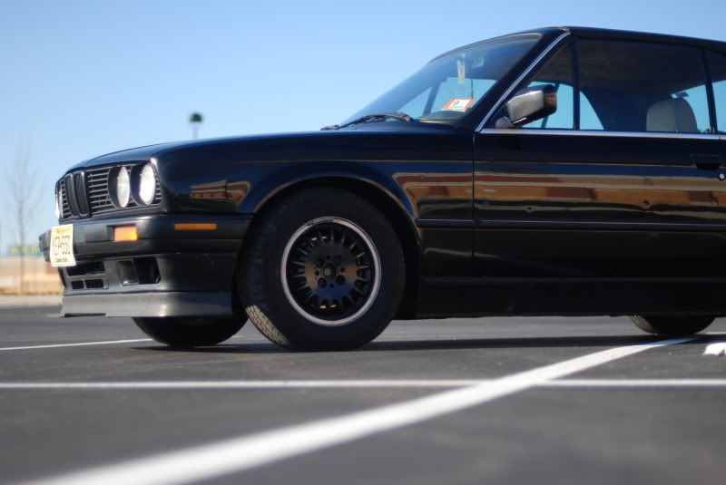

          Took some other pictures of the car:

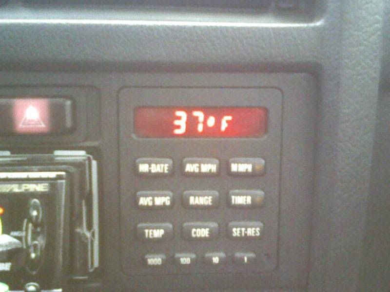

                    red LEDs soldered into the OBC lightbar

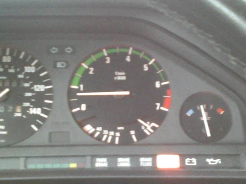

                    Also fixed the odometer, as I shattered another gear, and while I had the dash apart, I thought I'd replace all the burnt bulbs, and what do we have here?
                    Yup...the Anti-lock brake light is now lit...wonder what could be causing that....funny enough the vert is driving fairly well....

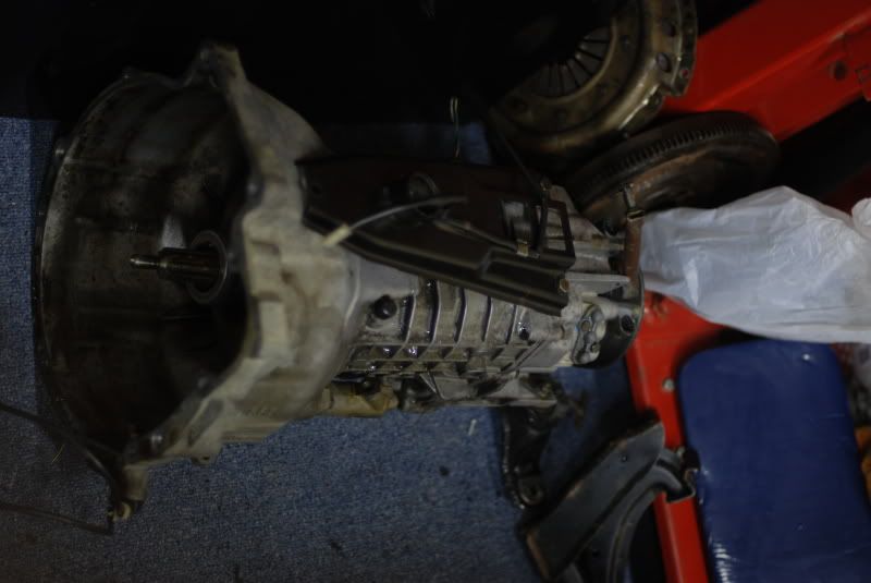

                    I'm picking up the 5 speed tranny/shaft and other goodies this weekend...swap is closer than I think... :)

                      The abs light is most likely the relay, its a silver box under the dash on the driverside on the dash. Take it out and carefully take the cover off of the relay, you will find a small wire loose. Soder it back in place and you'll be back in business.

                        Aye...thanks for the info on the anti-lock light...I will check it out..

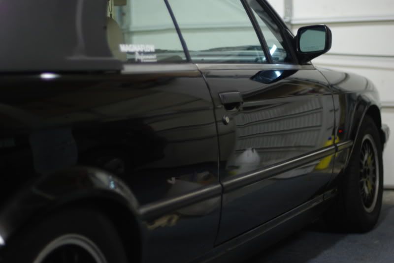

                              The 3rd brake light delete with is lip...
                              after a quick buff after wetsanding off the pin stripes
                              OH...what's this?
                              Another random picture
