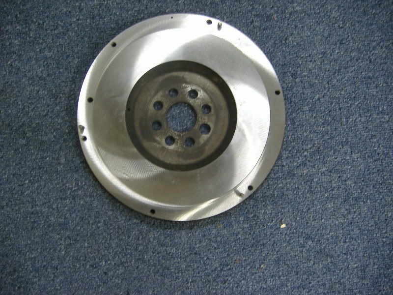

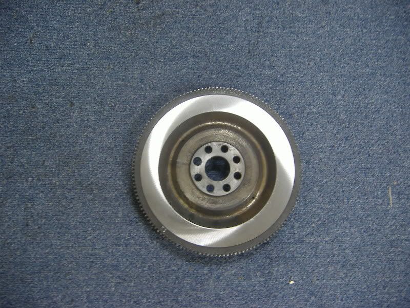

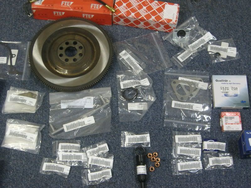

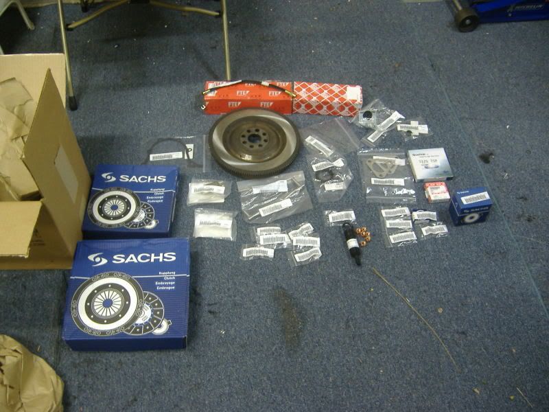

        Well its almost time to move into another phase of this project:
        Lightened/resurfaced flywheel
        Clutch parts/seals/misc gaskets that need to be changed
        Ordering some other stuff today/tomorrow (timing belt kit/oil pan gasket kit/power steering hose), some things I'm doing again as I'm pulling the motor/tranny together and might as well do them. The plan is to start this weekend but you know how plans go... :)

          That flywheel looks sexy!

            Who lightened it for you?

                • 2624
                #247
                machine shop no doubt. if it's a single mass you can lighten is quite a bit. how's your car coming along? been on track yet?

                • bmwpower
                  • 1556
                  #248
                  Yea, I figured it was a machine shop, but was wondering what shop since it seems like good ones are few and far between lately.

                    #249
                    Still working on the car. Collecting the suspension bits now. Hopefully soon....
                    ask a trans shop near you for a recommendation or if they can. but i'd rather get the car together and drive than be modding it :) track season is here.. you signed up for any events yet?

                      • TwoJ's
                        • Oct 2005
                        • 4908
                        #251
                        If you know how much material needs to be taken off, it should be easy for anyone at a machine shop to do a flywheel.
                              There's a guy in Sommerdale, NJ that did it...he dropped 4 lbs, he's often down your way at Atco racing (Anthony Figgas) I can get you his number, he owns the machine shop
                              Also depends on drivability and how often one feels like replacing clutches, lighter flywheels put more wear and tear on the clutch
