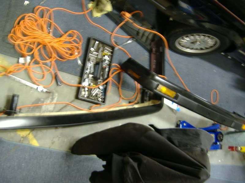

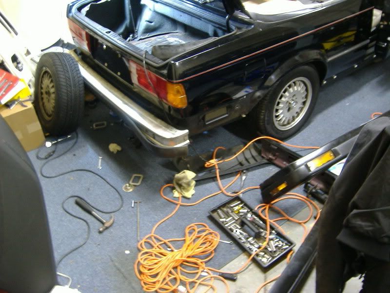

Well I over the weekend I picked up a set of already color matched plastic bumpers for the vert that you can see laying here....
I went to begin the install and I found my way into the trunk to remove the nuts holding the bumper/shocks in. Long story short...the bumper is stuck and will need to be yanked off by driving/attaching bumper to stationary object (or if someone has a better suggestion let me know)
How she currently sits:

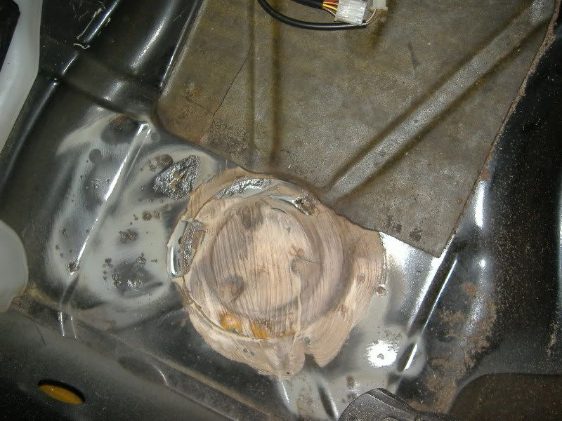

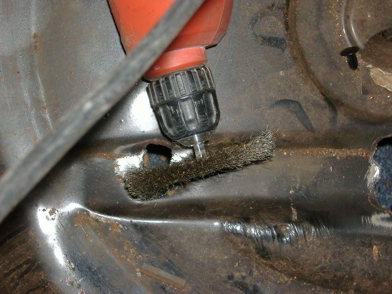

In any case, while I was in there I decided that now was as good a time as ever to address the rust issue both in the cabin of the car as well as the trunk....so I picked up a wire brush attachment for the drill and here is what we have

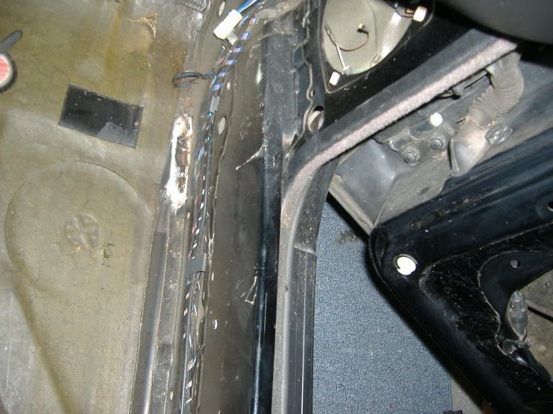

Behind Driver's seat:
Passenger side floor board:

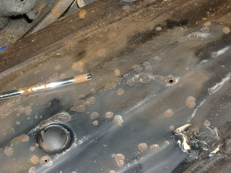

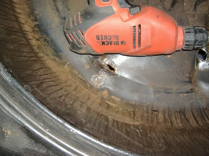

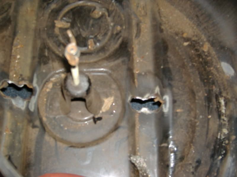

The trunk was by far the worst of the cancer (rust)
Being as though my goal really is to have a nice driveable car, not a total restore, my plan is to find the best rust killer (anthing other than POR 15 recommended?) and then fill all the holes/voids with reinforced fiberglass.

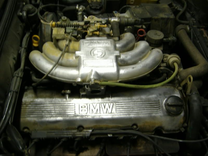

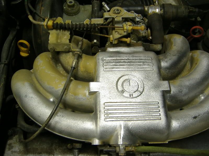

Oh...and while playing with the drill...I figured why not play with it in the engine bay....
More to come as this progressesBMWCCA #389756
Looks like a fun project. For the rear bumper, since it doesn't sound like you pan on using it, I'd take a sledge hammer to the ends of it, where it wraps around the rear valence. Just don't crush your hand ;)Comment
Doesn't sound like a bad idea...although I'd rather keep it in one usable piece should someone want it...its free.99 :DBMWCCA #389756
When you say 3 nuts are you referring to the ones that actually hold on the bumper shock? The Bentley on referred to two of those, not including the trim pieces...I will reread and re check....this weekend.
I will be picking up the POR 15 hopefully this weekend and some reinforced fiberglass and doing some work. I hope to be able to put the carpet back into the car by Monday evening...after addressing the minor issues on the interior....BMWCCA #389756
Looking good, dont spend time on the manifold and the valve cover. The Valve cover should be done in about a week and I have about half a dozen manifolds we could powder coat as well.sigpic

3 nuts per bumper shock that holds the shock to the carWhen you say 3 nuts are you referring to the ones that actually hold on the bumper shock? The Bentley on referred to two of those, not including the trim pieces...I will reread and re check....this weekend.
