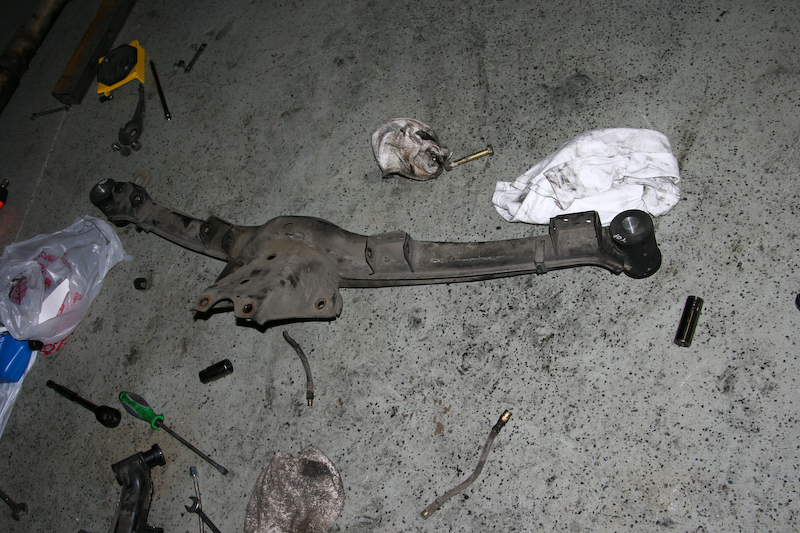

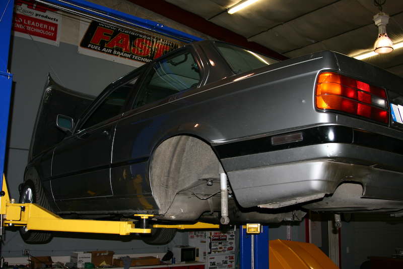

    I'll tell you! Well, for the last 5 days or so, I've been tearing apart the suspension putting in new urethane trailing arm, subframe, rear shock tower, diff bushing, and delrin shifter bushings from AKG. All of the rear bushings were coming apart, especially the shock tower bushings, they were garbage. Also added SS brake lines while I was in there. Also a new 3.25LSD from an 86 535i! This was the first few days...

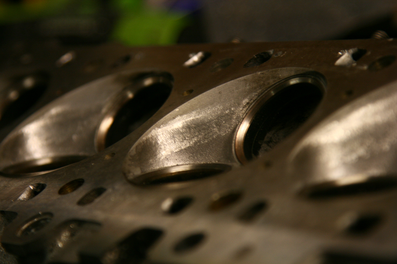

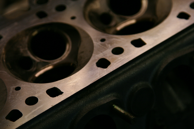

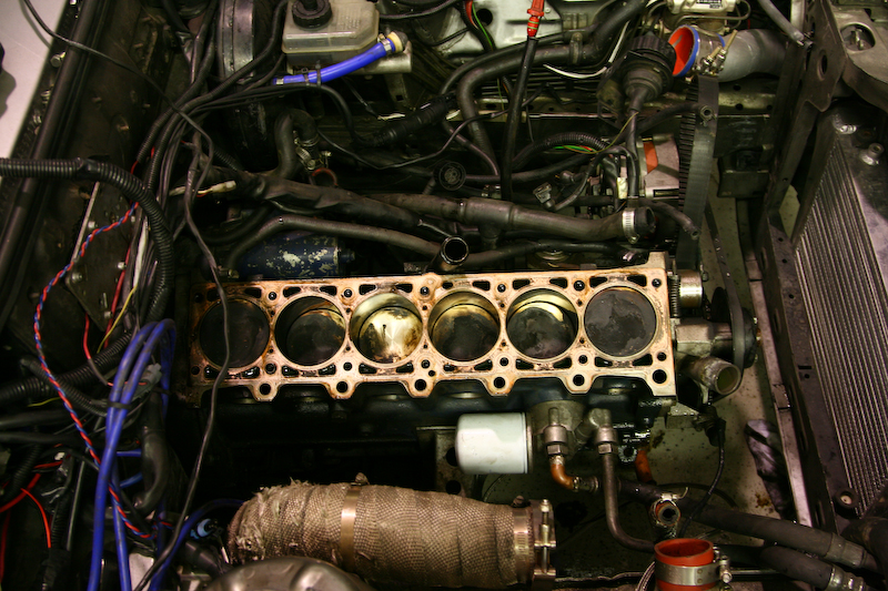

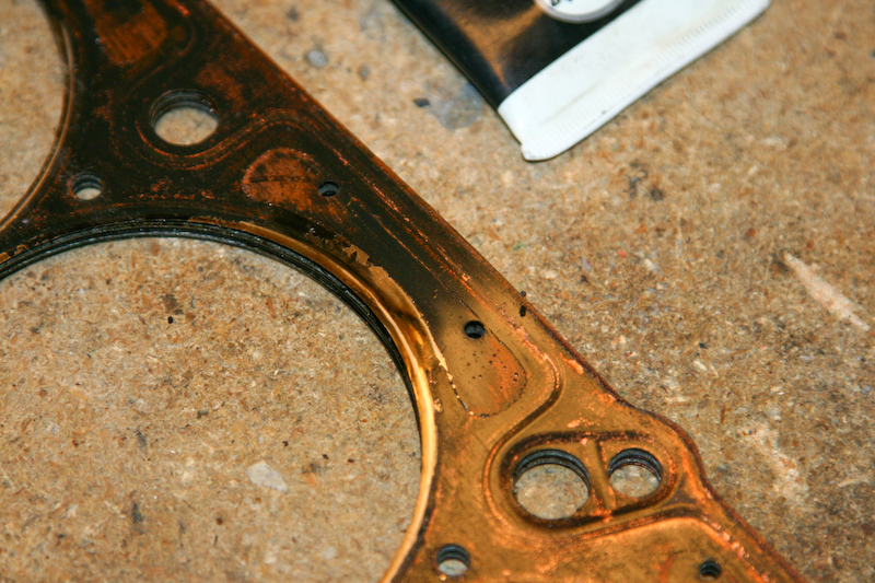

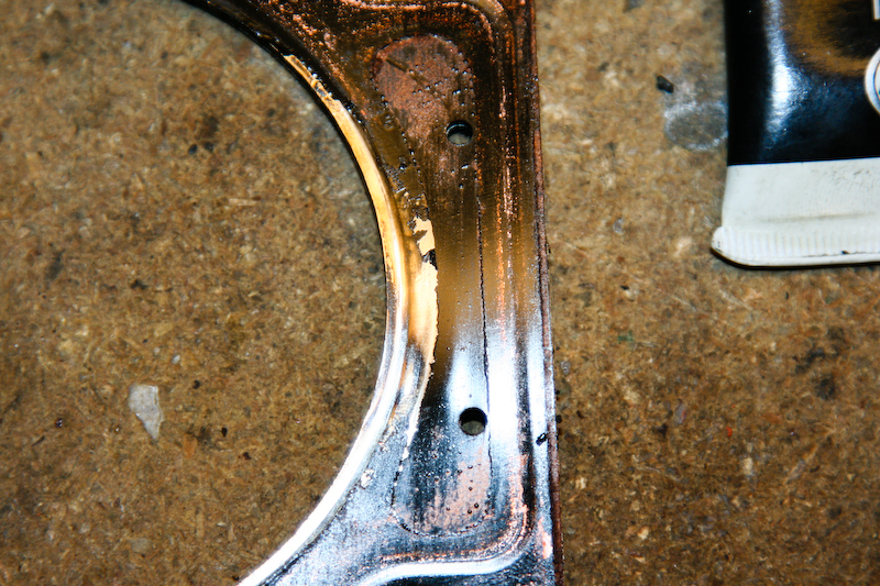

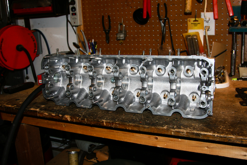

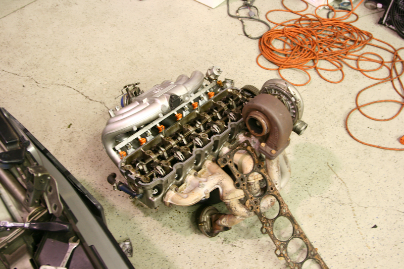

    THEN, I decided it was time to check out why my cooling system has been pooping out for the last couple months or so (haven't drivin it in a while). I ripped off the head in about an hour and found out that I blew the MLS head gasket, on cylinder #4 and a little on 3, it bent the top layer up into the coolant passage next to the intake side of the head. Notice how clean cylinder 4 is compared to the rest ;) SOOOOOOO, I decided it was time to weld the cooling passages a bit on the head.

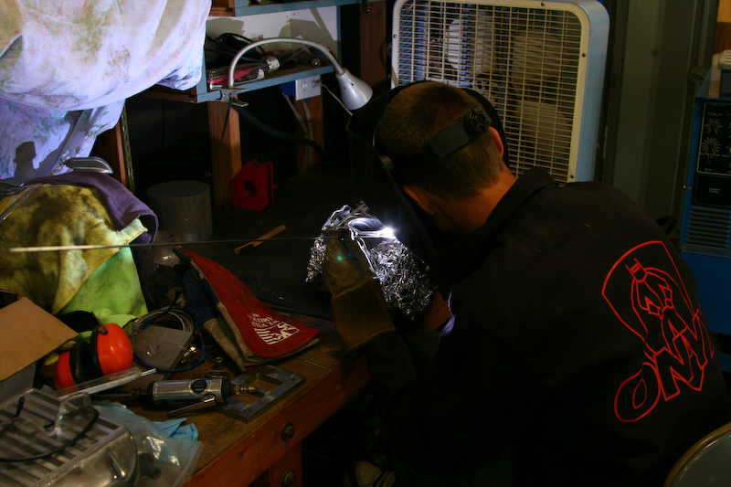

    I took the head to my buddy Ben's house and cleaned up the head a bit, and he went to work with a big Miller TIG and some 4043 rod. It turned out very well, we preheated the head to about 200'F, welded (the head stayed at about 200'F for the duration of the welding process, the head cools pretty fast), then wrapped in tin foil, and put welding gloves and a blanket on top to slow down the cooling process (less likely to warp). It turned out very nice!

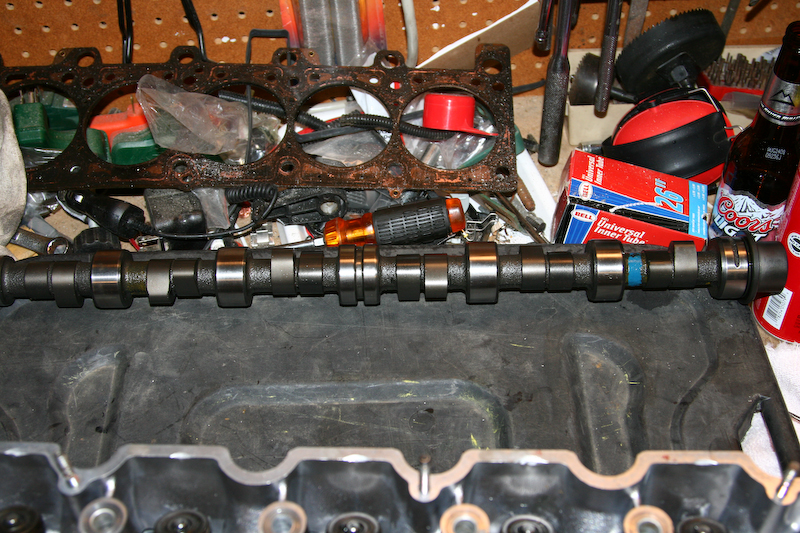

    Today I took the head to the machine shop, they are going to clean, pressure test, check the straightness, cut the valve seats, install new guides, and resurface, and should be done tomorrow evening if the valve guides come in the late morning/early afternoon. Once that's complete, I'll take it home, install new stem seals, valves, springs, custom billet 280/280 cam, and new seals. Then I'll throw the head back on the car with a new stock head gasket (less likely to push with the welded head) with ARP head studs.

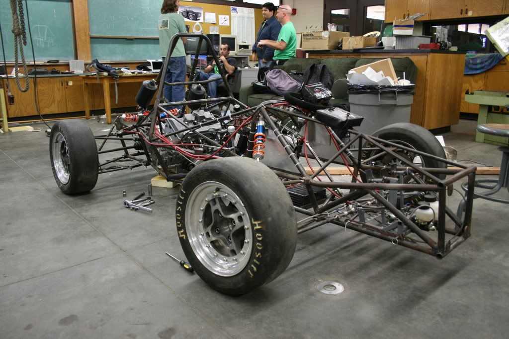

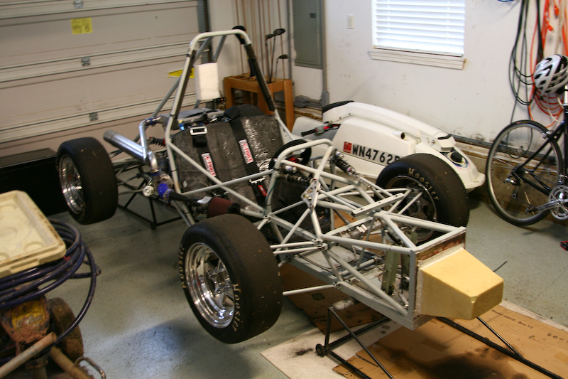

    Also one morning I picked up the WSU FSAE car and put it in my garage ;)

            Looking good man. Welded head club! Have any pix of the MLS?

              Glad to see its going back together. Nice welding your friend laid out. Looks like a badass chevy2 in the first pic.

                Looks familiar. Are you guys running a turbo? We kept going through cylinder heads and removed ours.

                  isaac, i'll snap a pic of the MLS failure in the morning.
                  318isbmw, yep, my buddy is a very good TIG welder. The Chevy Nova belongs to my buddy who owns a horsepower shop, it runs a 7.83sec 1/4 mile with a small block 406 and a huge precision turbo (1500hp).
                  einstein57, yeah we're running a garrett gt12 turbo and megasquirt 2 enine management on a lower compression f4i motor. So far so good, as long as we don't detonate ;)

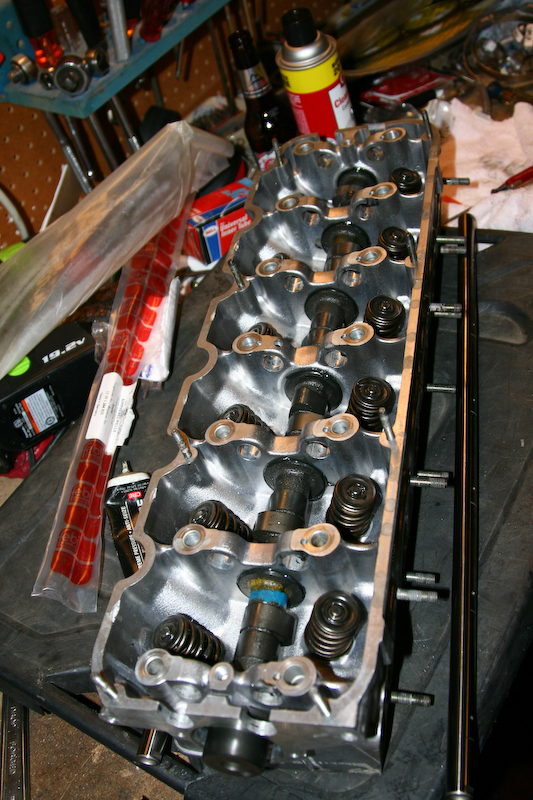

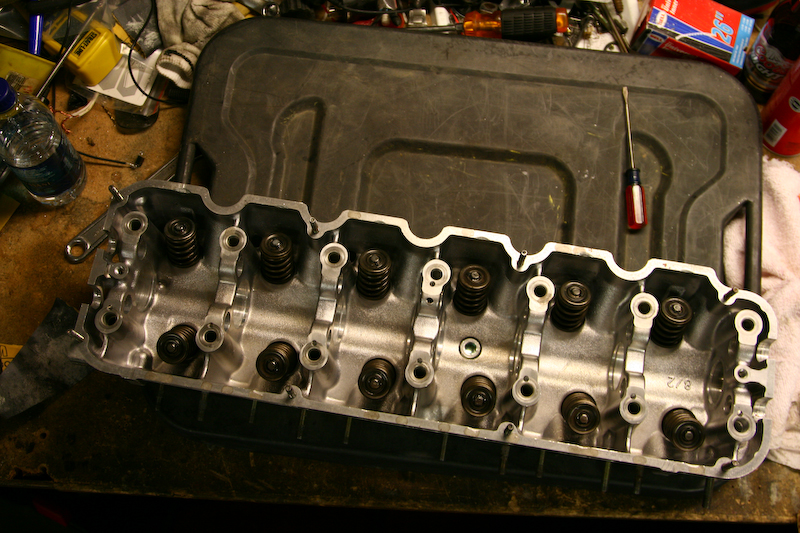

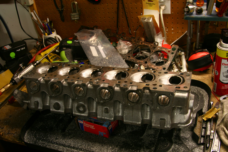

                    Update from today, I got the valve guides delivered to the machine shop, they pressed them in and finished the work by closing time. The resurfacing turned out really good. Now I'm going to port it a little and put it all back together. I hope to have it in the car tomorrow.
                    matt
                            That's not E28 535 diff, it's way bigger and has 8 bolts at each driveshaft flange.
                            The diff in the pics is typ188 diff (E30 big diff, E28 small diff, E34 small diff).

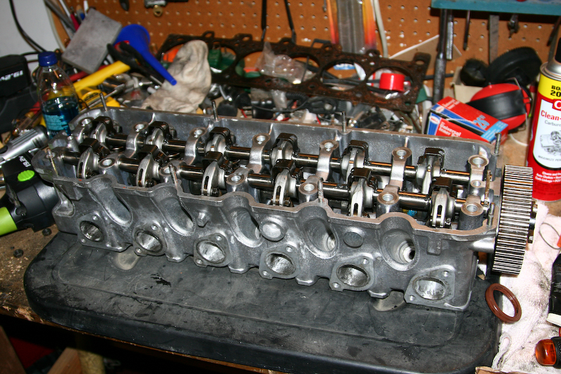

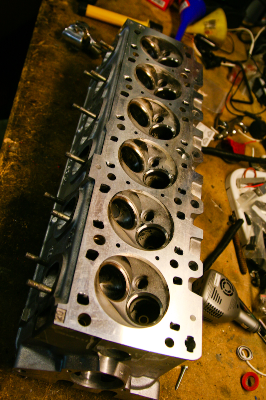

                              Last update of the night, I got the head all back together, it took about 5hrs to port it a bit, increase the head volume a little, and re-assemble the head with a new cam, new rocker shafts, and new valve stem seals and re-using the valves, valve springs and rocker arms (rockers are only a year old).
                              Jonsku, it was actually from a 535, but I swapped the diff cover and output flanges, which is why it looks like an e30 diff. I wish i could understand Finnish, it is one of my goals in the next year or so. Yes, I am 1/2 Finnish, my dad's mother came from Finland to the US. And I really want to visit there!
                              Last pictures of the night...
