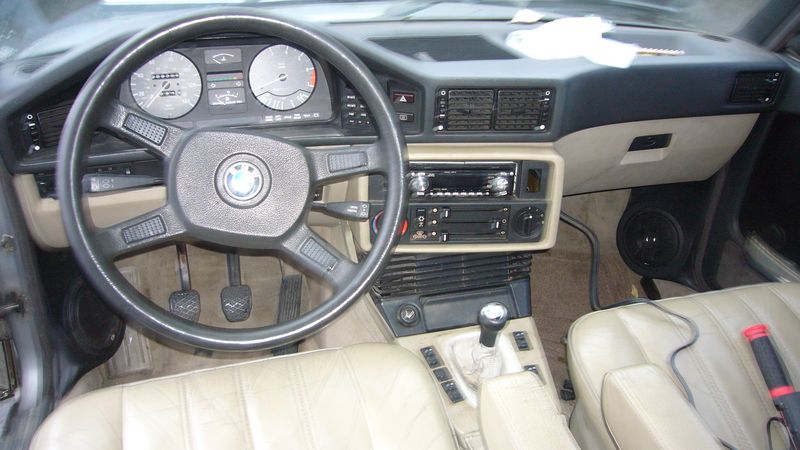

        After that I had to tinker with the cluster, and swap out the lame ETA cluster to an I tach.
        ooooh artsy, 280,000 EASY freeway miles

        While luke finished up the stereo and keyless entry John detailed the engine bay with his secret magical waxing compound.

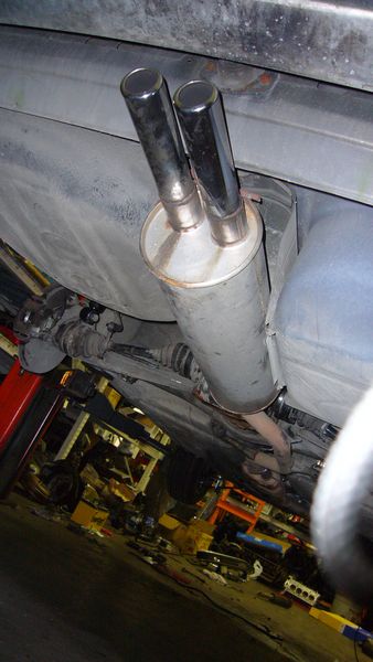

                          Exhaust finished up
                          And the final product for now, we have a large oil leak coming from somewhere that John is looking at now, and need to modify the shift linkage a little it (and a detail, my god is the interior bad), but otherwise its running and driving very well, comfy as hell to, I love the damn car.
                          More to come at some point, buts 6 15+ hour days later, here she is!
