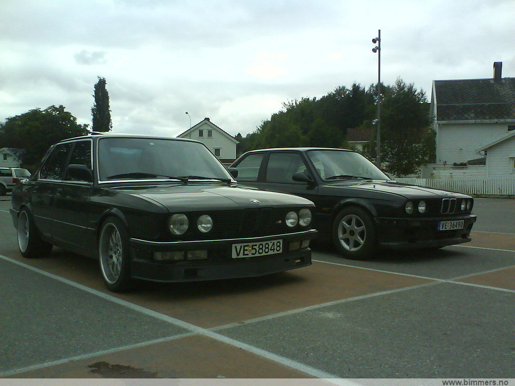

            It's a 528i. A good friend of mine's :) He's also 18 years old. Have to start early! :D
            When he bought it
