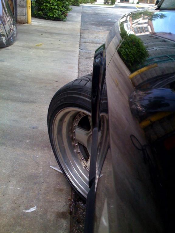

        Could you explain the tie rod spacers a bit more? I can't picture how they work.
        Byron
        Leichtbau
        • shiboujin
          • Feb 2006
          • 2791
          #199
          I'm interested in how you did it. I don't have a lathe and it would be nice to be able to DIY the solution.
          e30spdfrk: space out the tie rod on the inside so the physical stops (the inner tie rods) are up to 4mm farther than they used to be. You'll have to get an alignment to space the outer tie rod in more, but thats the basic idea.
          Status: HG repair. 488wtq though!
          • wolfgangstbd
            • 960
            #200
            its literaly just a spacer on your rack to push out tie rod
            works good!
            also Erick whaat QR are you using?
            • shiboujin
              • Feb 2006
              • 2791
              #201
              yes but where do you get/make said spacer?
              • Erick
                Official R3V Drifter
                • 11169
                #202
                Take measurements. I had to take all the measurements and take them to the machine shop. If anyone is interested, I can have a pair of them made and sent for $40 shipped.

                  #203
                  YES! I'm getting an E36 rack anyway but will they work on standard E30 tie rods?
                  • Erick
                    • 11169
                    #204
                    Yup, I'm using e30 tie rods on my e36 rack.

                      #205
                      Attached is the angle of the wheel when fully steered, but still well before you put load on it (actually sliding)
                      ..::Support FullOpp::..
                      FullOpp Stickers for sale!
                      Feedback Thread
                      • shiboujin
                        • Feb 2006
                        • 2791
                        #206

                          #207
                          Ah, I was thinking they were more towards the outsides of the car and it wasn't making sense. Cool idea, you don't have any inner fender clearance issues?
                          Byron
                          Leichtbau
                          • Erick
                            • 11169
                            #208
                            Nope, no issues, but I am running a pretty low offset wheel to not hit the sway bars.
