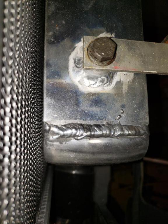

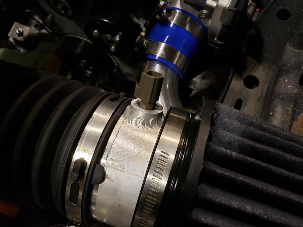

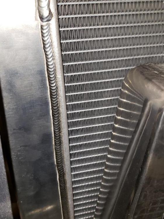

    I said i wasnt at all looking forward to welding aluminum but atleast in this case it wasn't that bad at all and actually turned out pretty awesome.
    I dare say I did better than whoever welded my intercooler
    the guy who did my radiator however has me beat lol
    so heres the end result

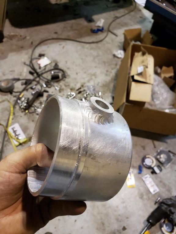

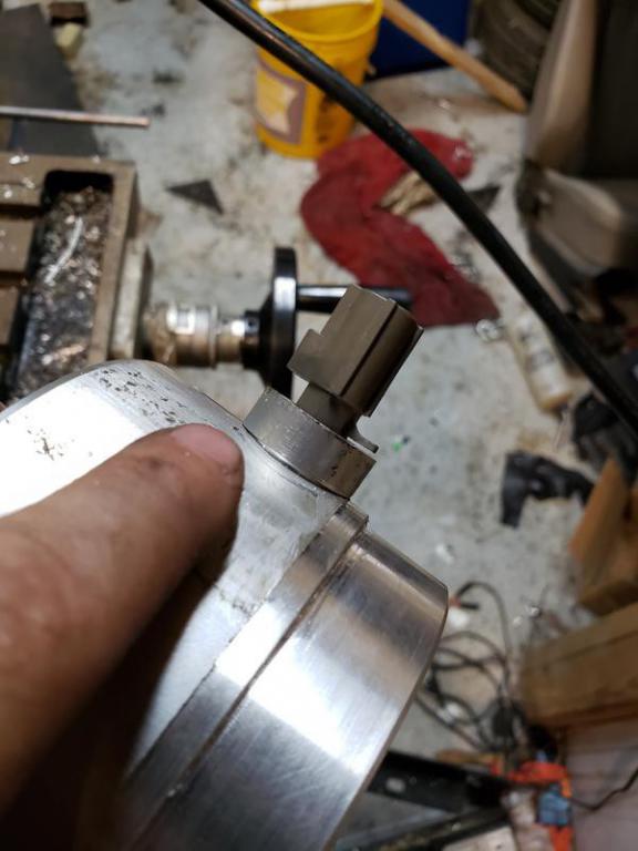

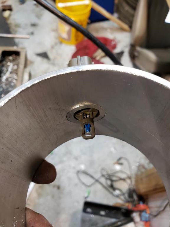

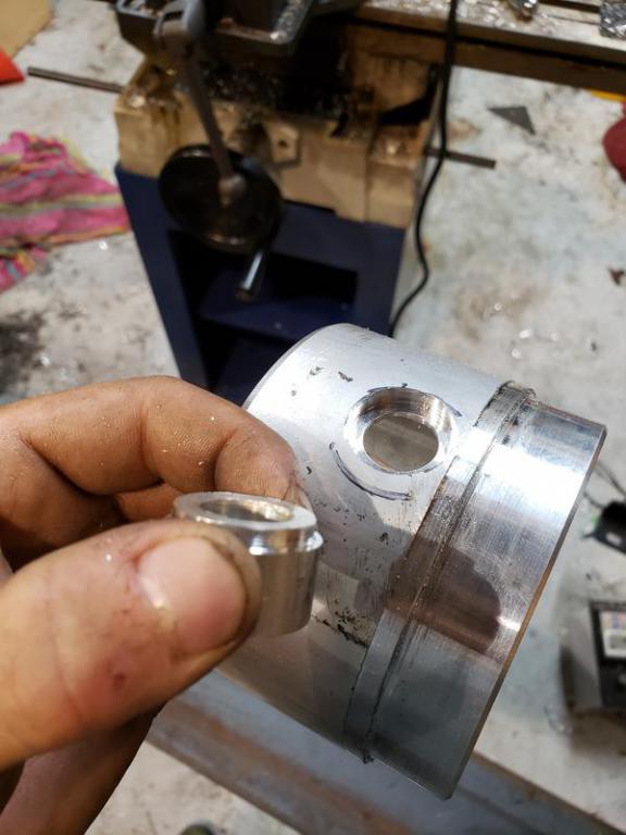

    decided to try finishing up my cone filter adapter with IAT. \
    turned the bung down to set it into the pipe
    decide to turn it down more and mill entirely through the adapter to get the sensor deeper into the pipe
    so that works out pretty good
    cleaned up the aluminum with solvent and hoping I don't mess up welding the aluminum.
    tungsten looks cool after you ball it up with DCEP, probably balled it up a bit too much.

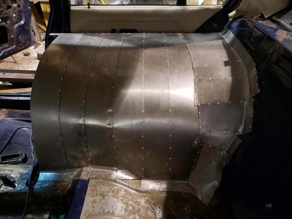

  • hkv
    replied
    getting close on the tanks firewall. now I just have the front section to deal with
    Click image for larger version  Name:	20190919-013044.jpg Views:	0 Size:	78.3 KB ID:	9871315
    Click image for larger version  Name:	20190919-012824.jpg Views:	0 Size:	80.7 KB ID:	9871316
    Click image for larger version  Name:	20190919-013212.jpg Views:	0 Size:	80.7 KB ID:	9871317
    Leave a comment:

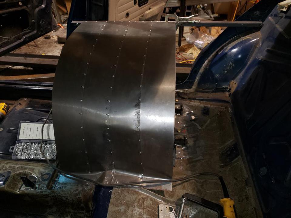

  • hkv
    replied

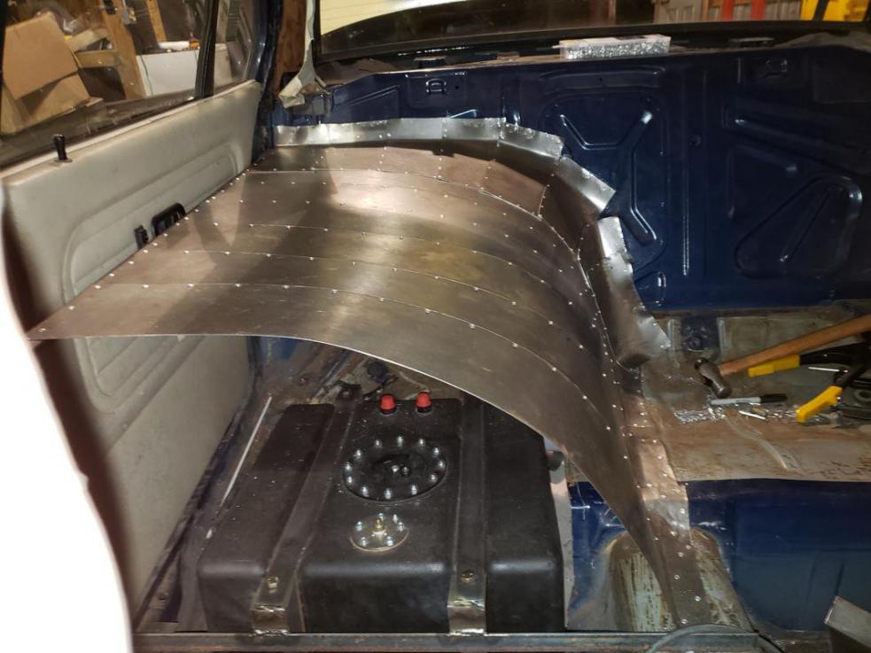

    so originally I was planning to have a firewall tightly wrapped around the fuel cell because I want some protection from it in the cabin but then I had a eureka moment because doing that I would have had to leave the filler cap open to the cabin. what I decided to do is make a little compartment that completely seperates the fuel cell from the cabin but still allows me to fill it up by opening the passenger side rear door.
    so you can see how it works. door closed ill have it sealed off from the cabin. door open and I can fit a gas nozzle in there and fill her up. no problem
    Leave a comment:

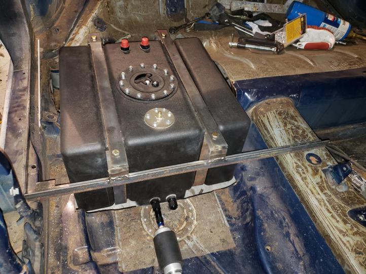

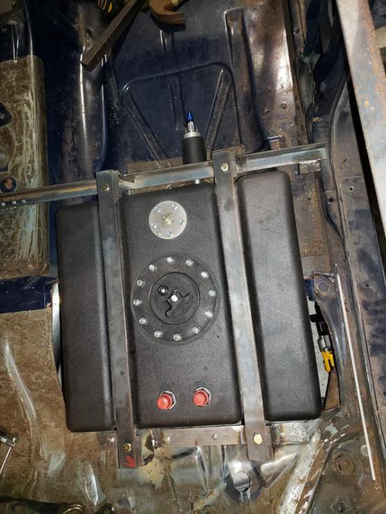

  • hkv
    replied

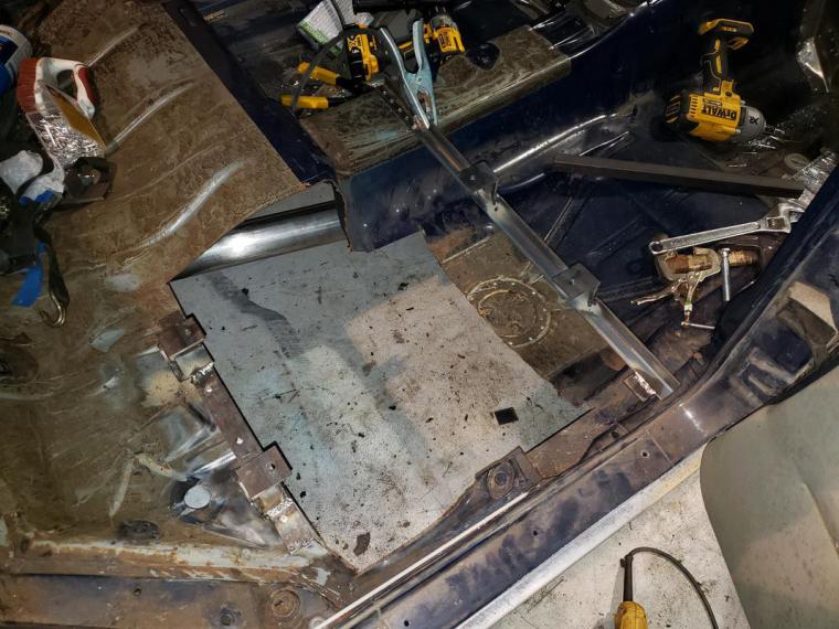

    making the frame for the fuel cell, I have several mounting points riveted to the car and then I weld the fuel cell mounting brackets to the riveted mounting points. I tried welding straight to the car but it kept catching on fire and even with 1/16th rods I experienced burn through and lack of penetration so I went back to the rivets.
    fuel cell in its nice little frame. very very snug in there, doesn't move hardly any.
    Leave a comment:

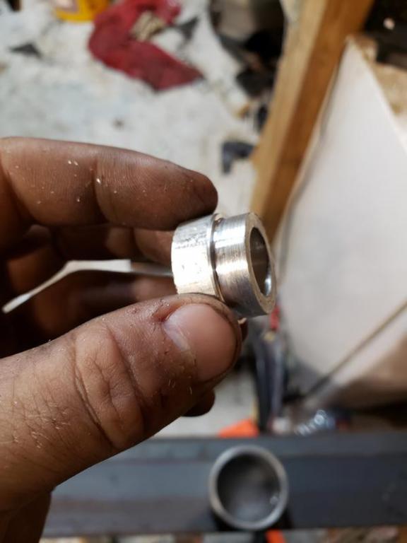

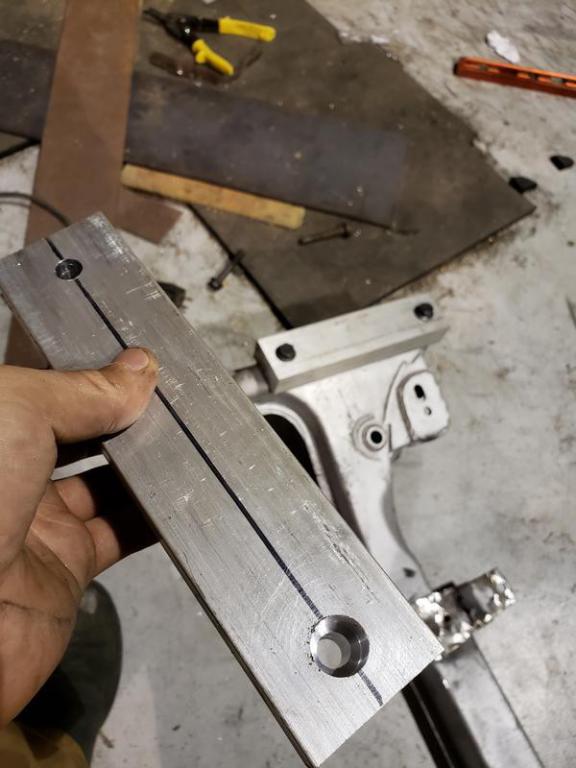

  • hkv
    replied
    didn't spend much time in the shop tonight but I made subframe spacers and they came out good. im still waiting on my order of metric fasteners but what im wondering is if I should mill the spacers down as thin as possible to just barely clear the oil pan or if the roughly 3/8" clearance I have between the subframe and the oil pan is not enough to be worth it.
    my understanding is that subframe spacers aren't good for ride quality, that they increase bump steer. so should I go to the trouble to squeeze another ~0.5" of clearance by modifying the steering rack mount and milling down the spacers or it even going to make a difference? anything else I should know about the spacers?
    Leave a comment:
