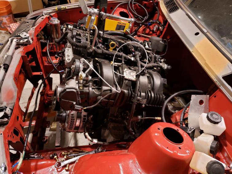

    Im back at it boys! if I have to disregard finishing the wiring harness and the gauges to let her rip a fat burnout before 2020 hits I will!
