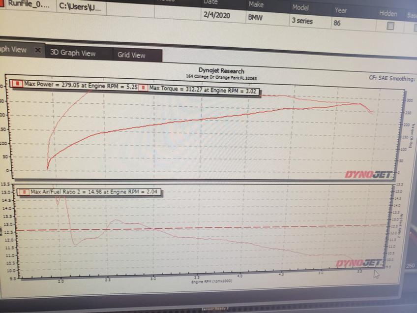

  • hkv
    replied
    BIG gains today, this thing is kind of a beast now. The tuner said it should run 10s with the right tires, that's crazy quick.
    the baseline dyno put down more power than I was expecting, the ecoboost put down smooth respectable power with its stock tune:
    And this was the final result after all the tuning was said and done:
    that is some crazy torque down low, 460ft/lbs of torque at 3k and 340hp at 5.5k.
    when he got it too put down 405ftlbs i thought that was crazy torque and then he went and got it do over 460ft lbs which blew my mind tbh. needless to say the car freaking rips because it was no slouch before.

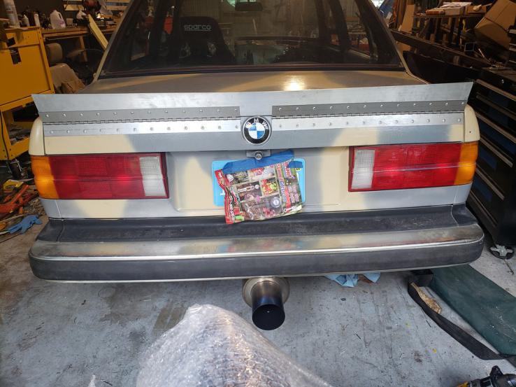

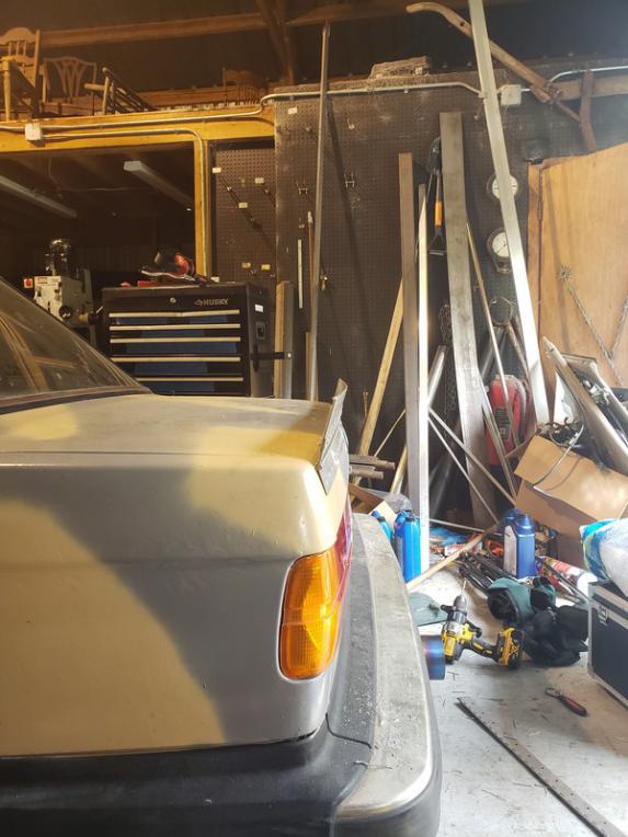

  • hkv
    replied

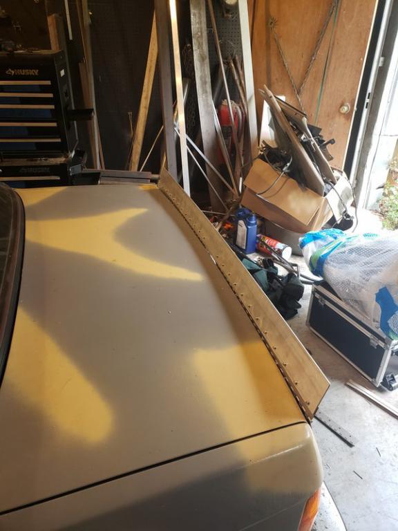

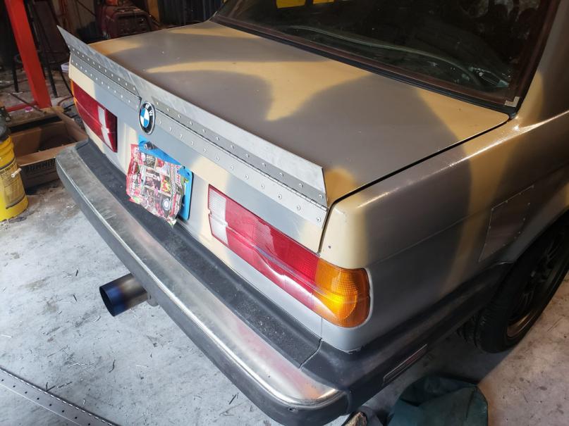

    something else I did was build and install a spoiler. I figured allot of you guys might be struggling with depression due to the recent dry spell of hot rivet on sheet-metal action so I imitated what the nascar guys do with their cars(I imagine they know allot about aero) and went for a gurney flap style spoiler something like this:
    I even replicated the 70degree angle they run. and because of the curvature I don't believe ill need splitter rods for them as cool as they would look but I have some that I can install if it deflects too much at high speed. maybe ill install them anyways just out of fear of it swinging around and messing things up.
    Leave a comment:

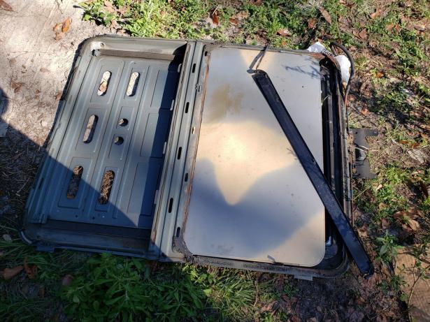

    I did some weight loss therapy and removed the sunroof and its carriage as well as stripped the doors of their windows and panels and window motors(all except rear passenger side because of the fuel cell).
    I removed the sunroof and carriage in one piece by just angle grinding the carriage mounts and then angle grinding the lip around the sunroof hole, ive never heard of anybody going about it that way but it works good and is really quick.

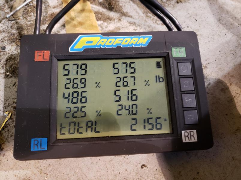

    so with all that removed and 3/4 of a tank of fuel I dropped my curb weight by probably about 100lbs although its only 70lbs lighter than my previous weight I posted because my fuel tank is much more full this time.
    new curb weight: 2165lbs
    with me:
    im pretty impressed that some people have gotten curb weights below 2k because i cant imagine any other significant weight reduction i can do that i would be willing to do(going to keep the diving boards).
    this will be the lightest my car will ever be because i still have a hood to install as well as cage and a few other things. part of that may be too that i imagine my powertrain is probably about 100lbs more than a s14 for example.
