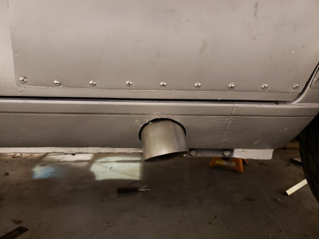

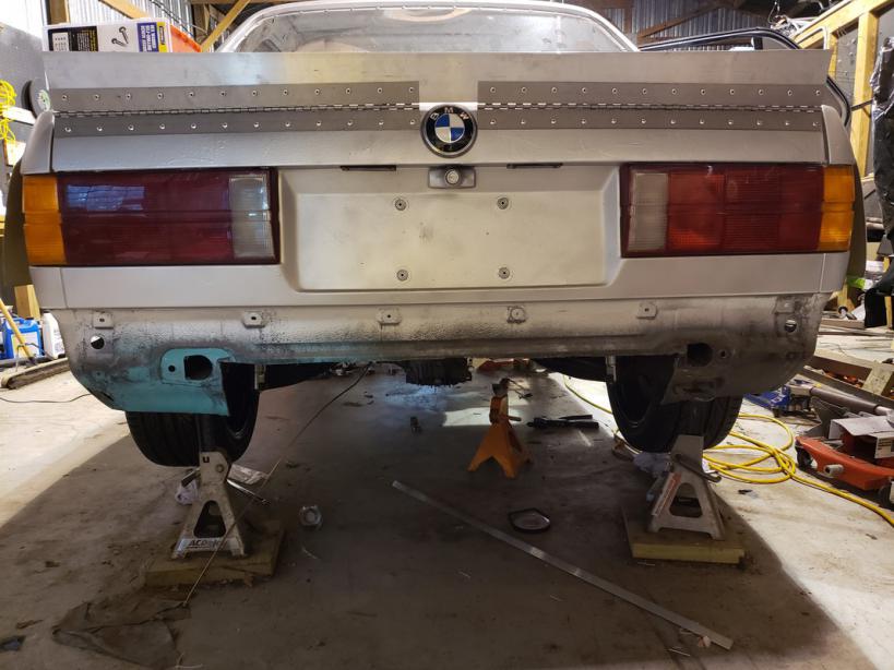

    i have chopped the rear of the car up in anticipation of a nice big diffuser so no more center exit exhaust

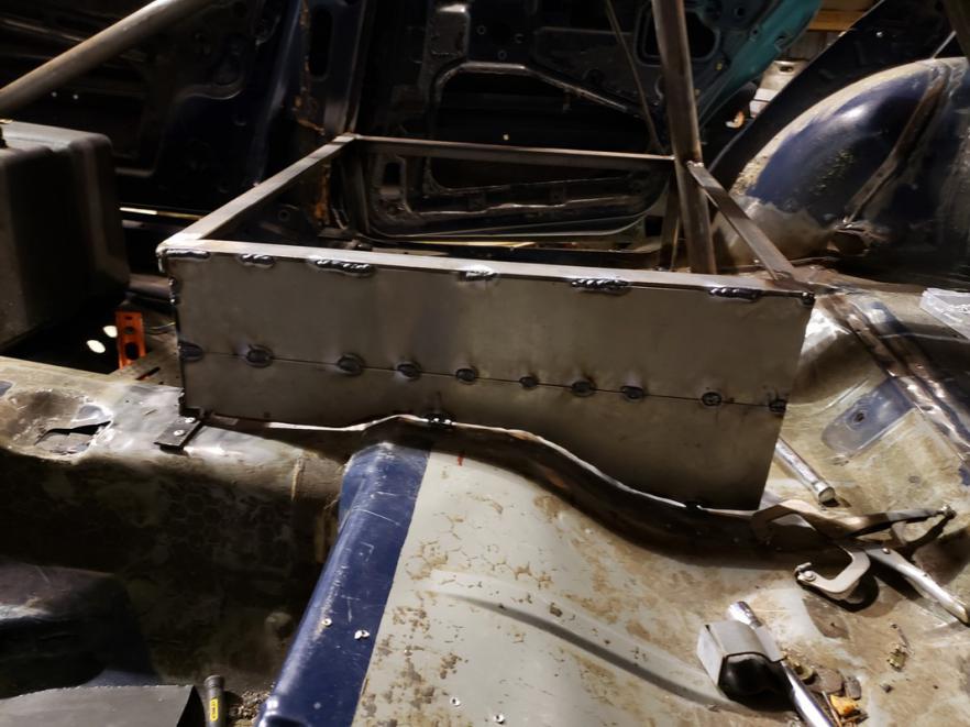

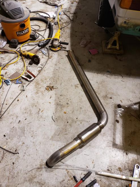

    now i side dump, the lack of a stock fuel tank left me allot of room under the rear drivers side backseat that i was thinking of lowering my batter into but instead decided to take up with this

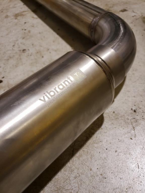

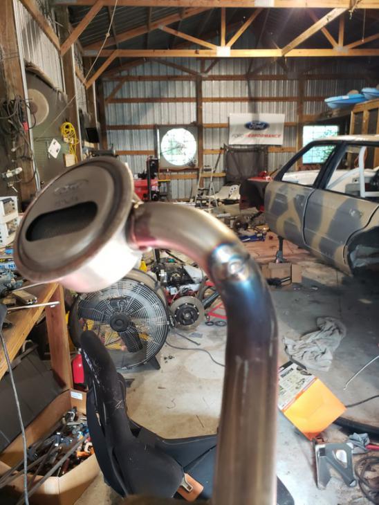

    as before, sound mitigation is brought to you by a baller vibrant ti peice
    dumping just in front of the rear wheel on the drivers side

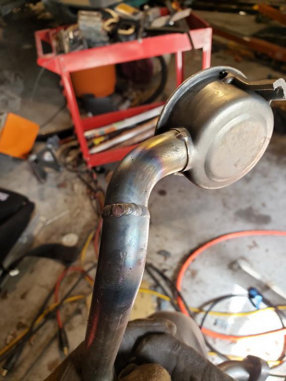

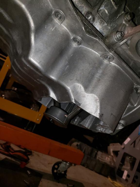

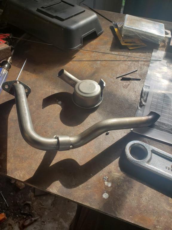

    oil pickup shortened
    Click image for larger version  Name:	20200903-101950.jpg Views:	0 Size:	52.1 KB ID:	9960976

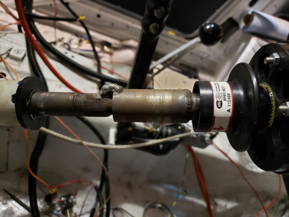

    doesnt look like it but this steering setup was a big pain and time consumer but it turned out pretty good. from the left: UHMW plastic bushing for the shaft i made myself, stock steering shaft threaded and lock welded(can be removed) into adaptor i made to weld the quick detach too.
    Click image for larger version  Name:	20201118-170242.jpg Views:	0 Size:	70.6 KB ID:	9960977

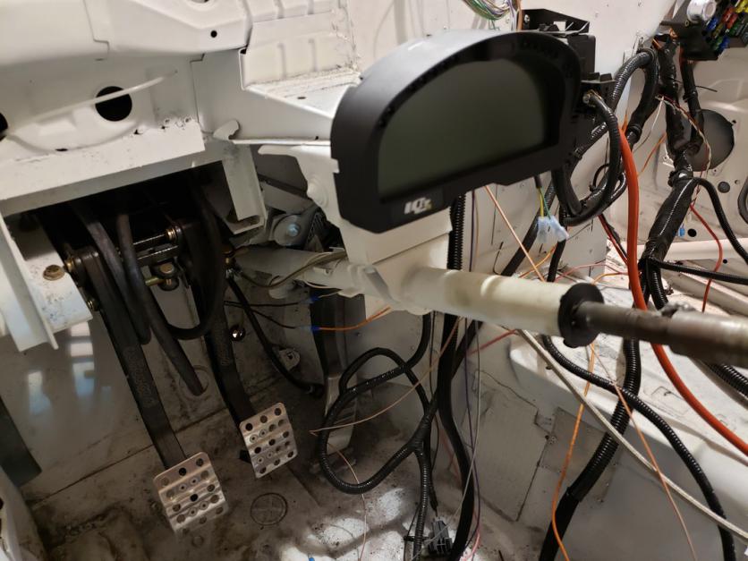

    you guys will be proud of me for this move, buh bye trucker dash
    Click image for larger version  Name:	20201118-170252.jpg Views:	0 Size:	73.7 KB ID:	9960978

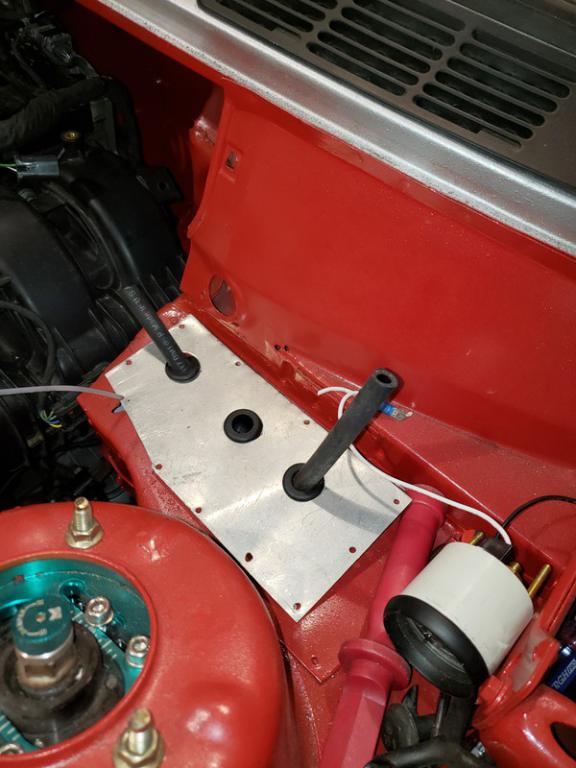

    brake setup up here is much cleaner. now only the master cylinder inputs are in this area and the outputs have been rerouted. much cleaner

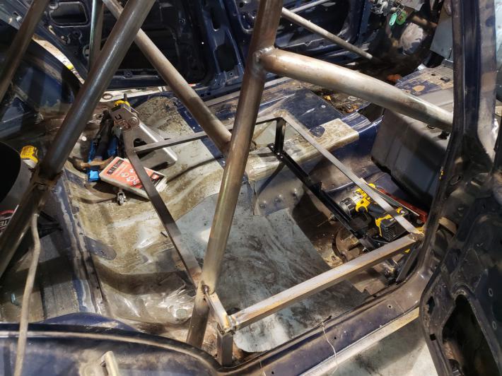

    im surprised because i dont have as many pics as i expected, but i will get what pics i need in the shop to show what ive done if i need them. i will be documenting what i did when i can.
    the car was stripped to a bare frame again and repainted. i forgot to mention that, that i repainted it. i want to make the car more complete and presentable. theres probably other things ive forgotten to mention

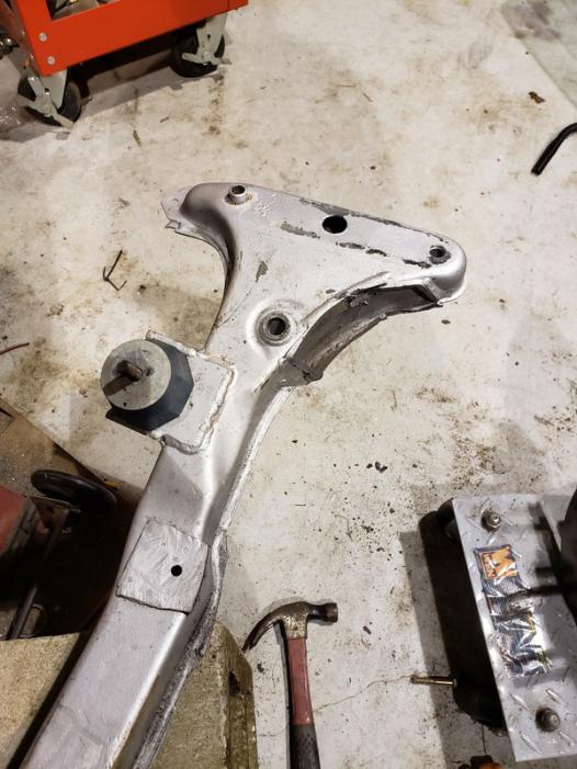

    Click image for larger version  Name:	20200826-170709.jpg Views:	0 Size:	66.7 KB ID:	9960926
    you can see i remove the drivers side motor mount on subframe because i dont use it(this isnt the final result)
    Click image for larger version  Name:	20200826-181353.jpg Views:	0 Size:	62.1 KB ID:	9960927
    Click image for larger version  Name:	20200829-085638.jpg Views:	0 Size:	74.2 KB ID:	9960928
    Click image for larger version  Name:	20200903-093917.jpg Views:	0 Size:	73.8 KB ID:	9960929
    Click image for larger version  Name:	20200903-094133.jpg Views:	0 Size:	76.3 KB ID:	9960930
    ive done a really poor job of documenting this second phase but i will get what pics i need. the car is nearly driving right now so theres allot going on that i dont have pics of.
