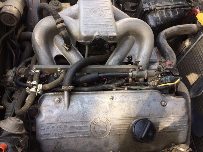

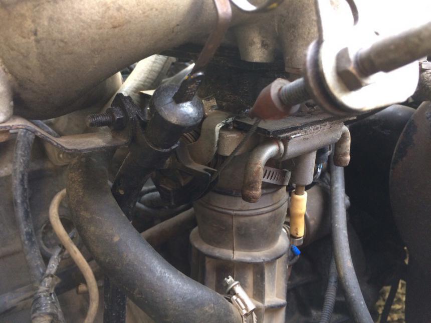

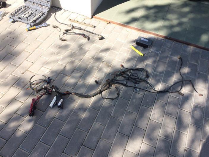

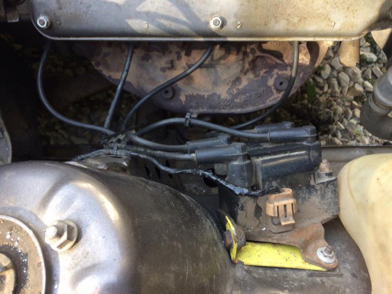

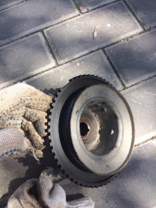

        Today i would like to write about Russian EFI system- January 5.1
        Previous owner converted m10b18 to this EFI instead of Jetronic. This system is very popular in Russia because every EFI Lada has it and it's cost about 60$ with ECU and complete engine loom with maf and all the sensors( all you need to do with the loom is to lengthen some wires and fix ECU in glove compartment)
        Then you need to wire stock fuel injectors, fuel pump relay and make custom throttle body to install J5.1 TPS or install lada throttle body with its original tps(very simple). After that you need to weld a piece of lada crankshaft pulley(with reference plate, don't know how to translate it) to M10B18 crankshaft pulley to make CPS work(also need cps sensor bracket, but it's can be made from 1mm metall sheet). Finally, you should fine a place with good ground signal to fix ignition module.
        You still have all your jetronic wiring in the car, but if you unplug jetronic ECU nothing happen and car still runs and starts.
        The benefits of this ECU is
        Cheap
        Reliable
        Easy to install
        New sensors cost nothing(TPS cost 5$, CPS cost 3$, MAF 30$)
        If you set up it very well and engine is ok, stock m10b18 with this ECU can produces up to 120hp hah
        Everyone here know it and can easily adjust it and add new features (launch control, antilag, shift light etc)
        You can convert it to APS+intake air temp sensor if you want forced induction.

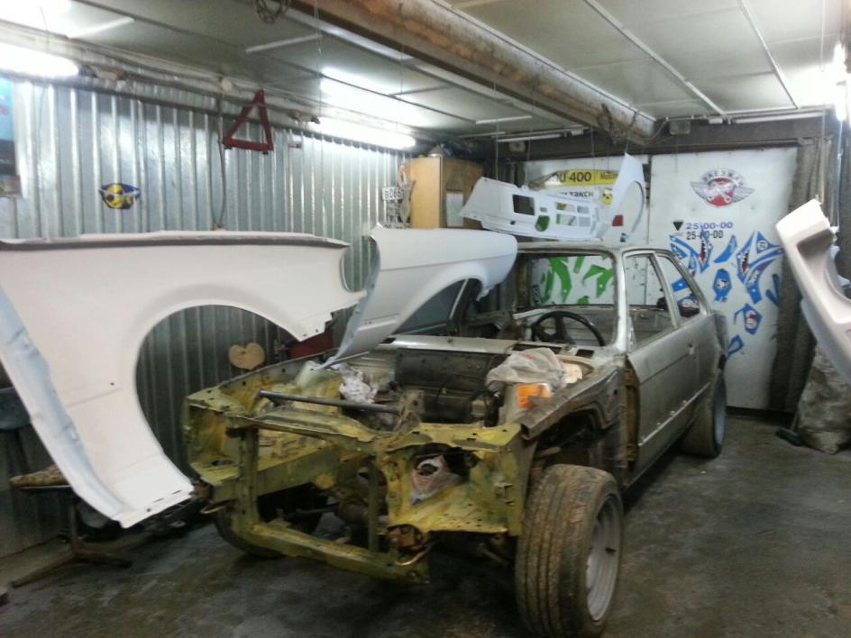

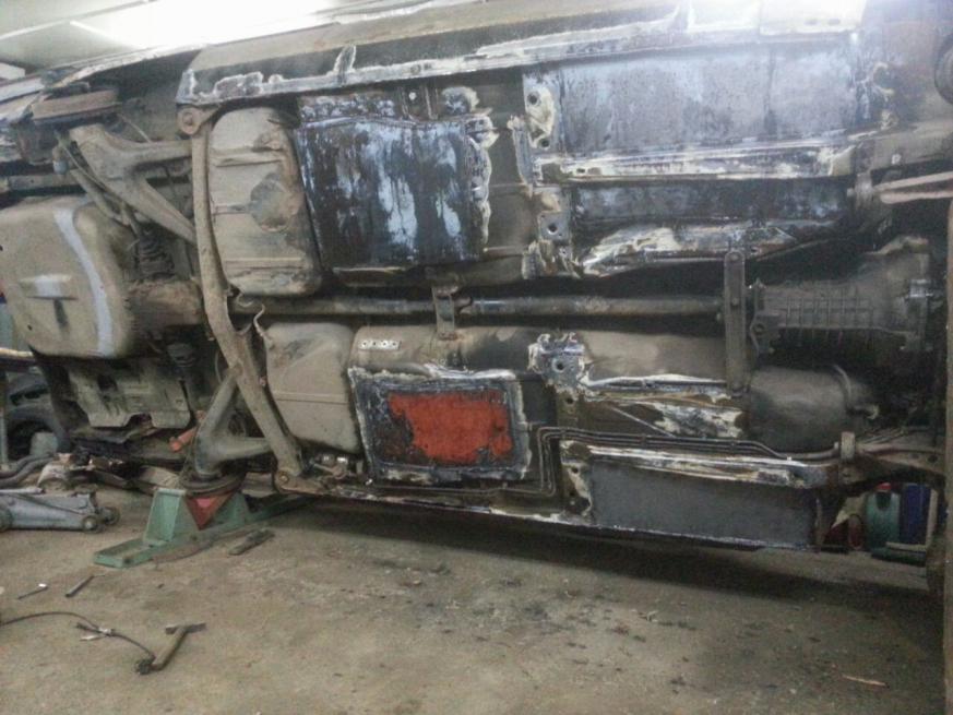

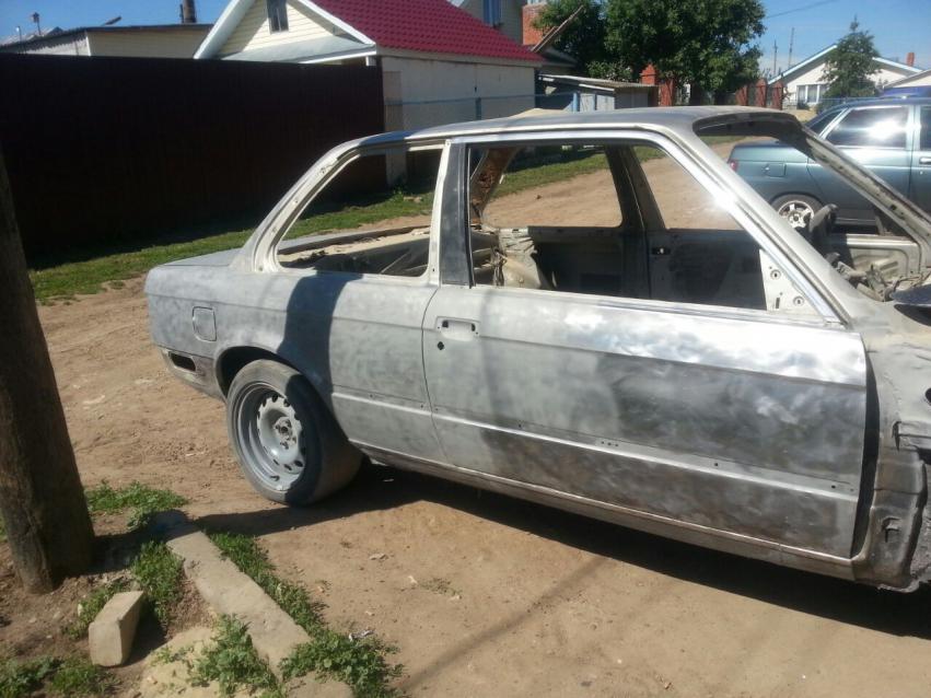

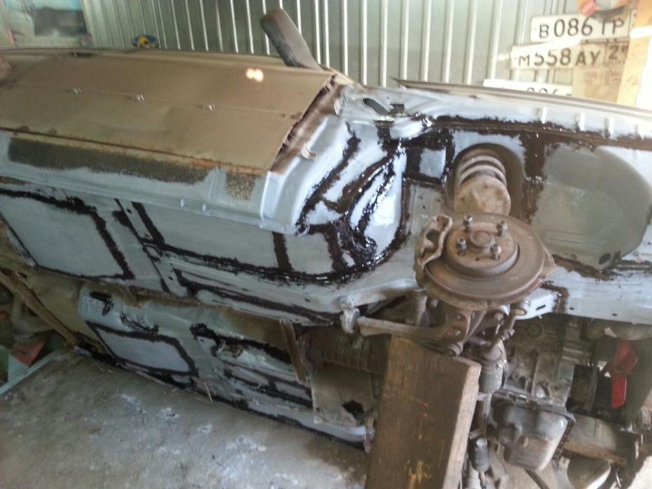

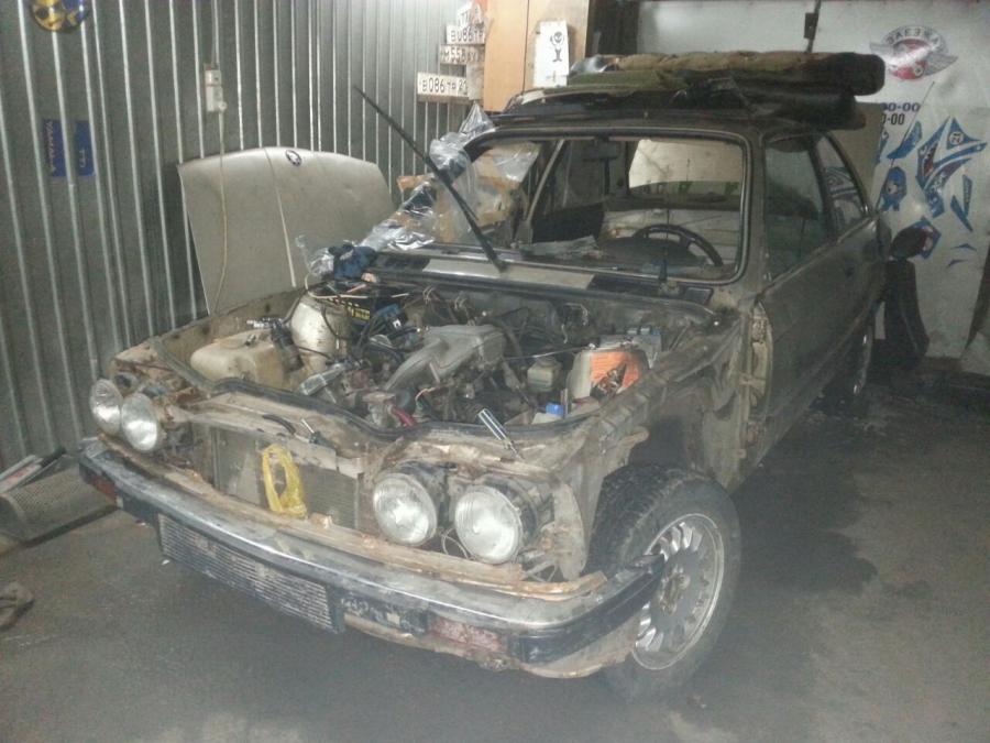

          I found some photos of my car that was made 3 years ago by previous owner.
          He bought the body with engine for 300$ and restored it as he could.
          As i mentioned before, we suffer from salt on our roads in winter and body of cars become rusty very quick, if you don't use anti-rust coatings
          Click image for larger version  Name:	b3bac886-3cd5-4633-b41f-a10a52ca8615.jpg Views:	0 Size:	83.0 KB ID:	9896445 Click image for larger version  Name:	ce0133cc-cd8d-41ad-9dea-2b8e7adde9dd.jpg Views:	0 Size:	82.2 KB ID:	9896446 Click image for larger version  Name:	1d4ea514-4193-43c4-b7c7-86a3a7bd8a3d.jpg Views:	0 Size:	79.1 KB ID:	9896447 Click image for larger version  Name:	1122c2c1-d5d5-48d9-9580-f5a5801b0559.jpg Views:	0 Size:	79.9 KB ID:	9896448 Click image for larger version  Name:	1dde0a86-bb75-4424-b0e9-d974e70bdfd9.jpg Views:	0 Size:	79.8 KB ID:	9896449

                I'm very interested in the January 5.1 ... specifically the toothed wheel setup. What is the angle of the 2 missing teeth in reference to the woodruf key?

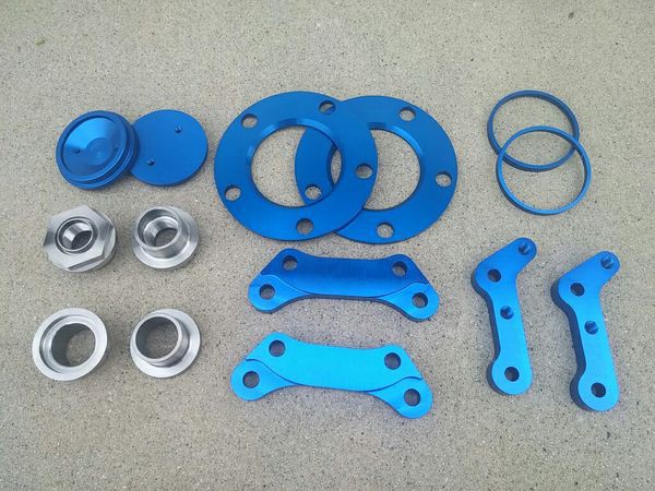

                  what rotor are you using for the front because I did the BBK too but the ET is too much the wheel is poking out too much I am trying to find a solution and any close photos of the caliper too
                  • Alan
                    • Dec 2019
                    • 17
                      Can't measure it right now, already sold this system. J5.1 has 60-2 crankshaft pulley. To install it on 4 cylinder engine, you put your engine in tdp and install the pulley that 20th teeth would be opposite crankshaft position sensor(counting begins after the spot without teeth). This is the photo from a guide which was used to make my system work(blue is stock tag on m10 pulley, green is welding spots,red is j5.1 pulley)
                        Front config is
                        E36 hub with spacer on knuckle axle
                        E39 520-528i brake caliper( aluminum one, for 22mm brake discs,60mm piston)
                        Mini Countryman brake disc 294x22 45mm height
                        Custom brake adapter
                        in comprehension with stock brakes new brakes are awesome, but i didn't test them on racetrack and i have non-sport brake pads,so can't say about brake fade

                          • Narsiyousif
                            • Dec 2016
                            • 71
                            Originally posted by Alan
                            Front config is
                            Stock brakes
                            E39 BBK
                            Gaps are minimal, but ok

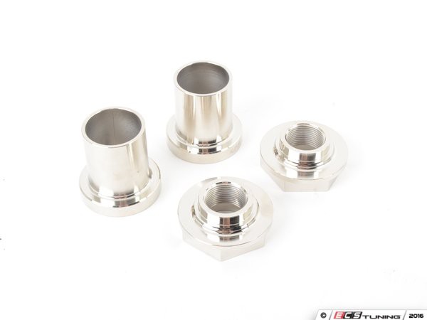

                            really nice build thank you for sharing the photos I was wondering how you got the backside of the e36 hub mounted with only the flat sleeve because my kit had this type of sleeve that sits by the back dust cap like this one :
                            and this is the actual kit that I used
                            my problem is that I am using rc090 it sits perfectly in the rear but the front is sticking out too much and trying to find a solution plus the minimum wheel size need to be 17" no less because of the e46 m3 front caliper and rotor I don't need that much brake power so I am trying to see if someone is using other options for front. THANKS AGAIN
                            • Alan
                              • Dec 2019
                              • 17
                              Fitting big brakes with rc090 is a real pain.
                              If I won't be satisfied with brake power of e39 caliper and mini rotors, I will install e46 330i brakes(caipers+rotors). They fit perfectly in my 16's because BBS has a "motorsport" shape of inner rim. This is super minimal gap with inner rims and spokes, but it works)
                              If I were you I will go this way, because your problem is small X-factor of the rim(distance from the hub mounting surface to the back of the wheel spokes). E39 caliper is very big and i thinks it won't fit with rc090's. E46 330i caliper is narrower than e39 and you will have more chances to install it with your rims without any spacers.
                              Here is the photos of 330i brakes in my rims.
