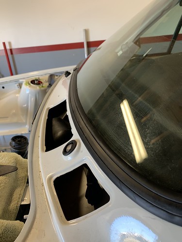

    Ended up going with Chase Bays front brake line setup for OEM master cylinder. I've bent front lines before and it can be a real pain with all the angles in such a small area, not to mention you have to make sure nothing is rubbing on the engine. I do have the e38 7 series master and a 944 booster but everything seems to fit as it should. Instead of running behind the engine the soft line attaches to the front subframe which is nice. I'll update this after i run some fluid through it and mess with the regulator.
    Click image for larger version  Name:	49983927038_965162a2a0.jpg Views:	0 Size:	53.5 KB ID:	9930833
    Click image for larger version  Name:	49983743083_23007446dc.jpg Views:	0 Size:	49.5 KB ID:	9930834
    Was also able to get the windshield lock strip in this weekend but i did have to call a professional in to do it. I've done this 3-4 times but i've always used the original gasket, lockstrip and glass. I'm note sure if i wasn't able to get it done because of the new gasket and lockstrip or because the aftermarket glass wasn't made correctly.
    Click image for larger version  Name:	49984264431_06f261dcc3.jpg Views:	0 Size:	45.2 KB ID:	9930835
    All the polished trim was wrapped satin black and new gaskets were installed. Nothing like fresh gaskets!
    Click image for larger version  Name:	49984521412_9789140622.jpg Views:	0 Size:	39.4 KB ID:	9930836
