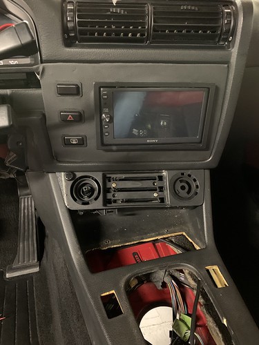

    As you can see the lower half has been cut off. I've removed 2 buttons which i'll relocate to the glove box if i decide to run AC in the future. The sides have been shaved down and a piece of angled ABS has been added to the left side. I don't think i'll be able to explain what i did on the back side but its safe to say 50% of the plastic has been removed and/or manipulated. All of the cable had to be extended and are now secured to the to the slides with m4 nut/bolts. The shift surround has also been cut where it meets the heater core to allow everything to have more room.
    what i still need to do is make a bracket to attached the bottom of the hvac panel to the ashtray area. i will most likely add a few gauges in that area and allow for a small cubby.
    Obviously everything above it just for hvac. The radio surround was cut from a piece of metal and i welded a single din cage on the back. 2 buttons will function as normal the the other is a stealth volt meter. I might go back and add a fourth because i think it looks a little too spread out.

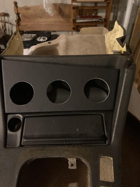

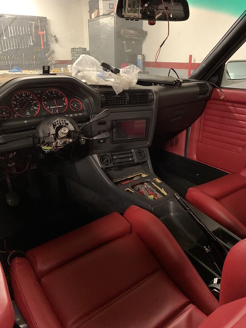

    Slow progress since i decided to start/finish the 2002 quick. Now that i'm done with that i can put my focus back on the vert.
    Interior has been installed and the radio/hvac layout is finished. I'm still messing around with painting or vinyl wrapping the panel but the pictures show it with some black vinyl i had laying around. Nothing is 100% secured in the pic so don't judge me lol.

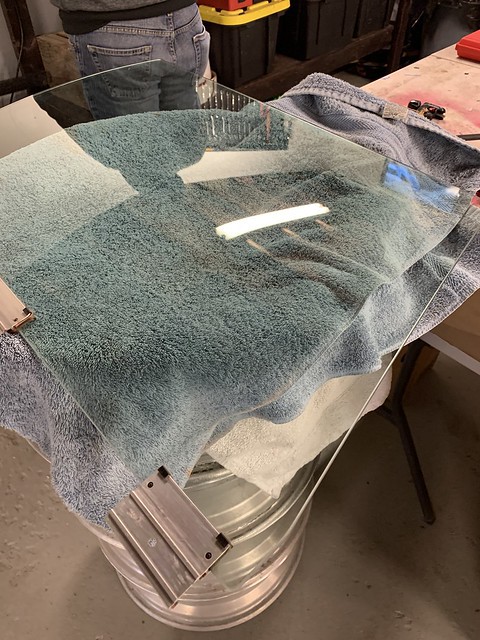

    I used a 3" cotton wheel on a drill, you don't need a lot of speed and pressure to get results. I'm sure you can find some videos online about the process.

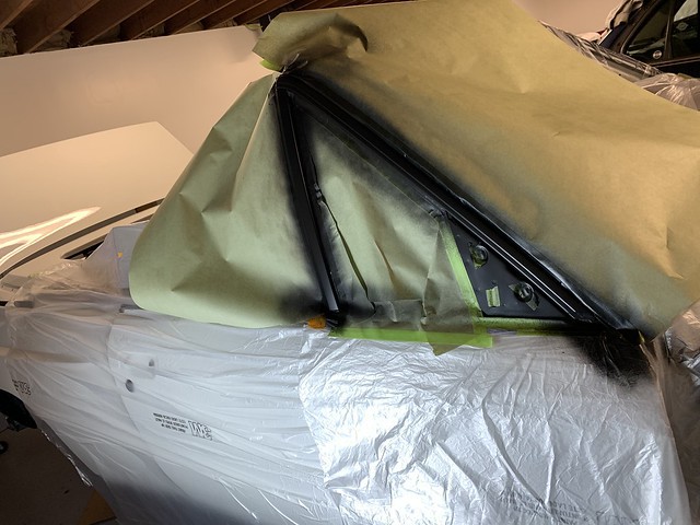

    Painted the window trim while i was working in the area. It would have been much easier to do this before the car was painted but i completely forgot.
    Click image for larger version Name:	49644008166_fd2acc7cce_z.jpg Views:	0 Size:	78.8 KB ID:	9910716
