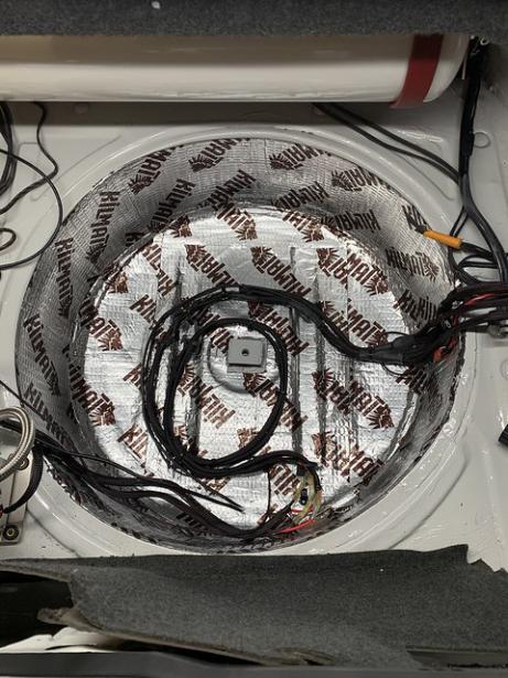

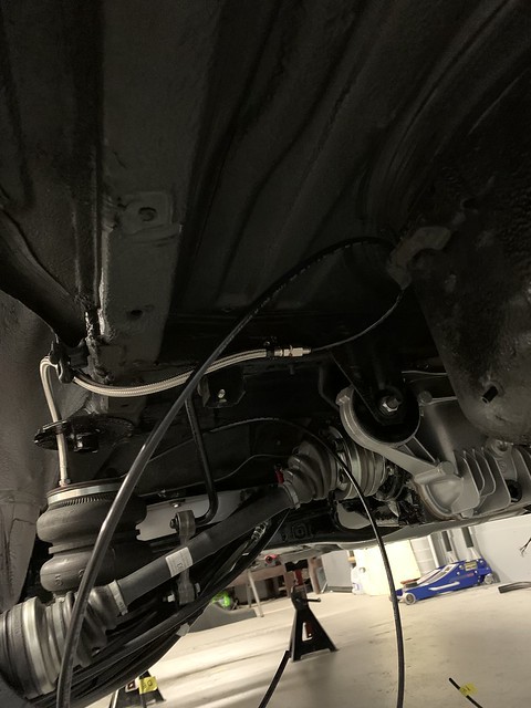

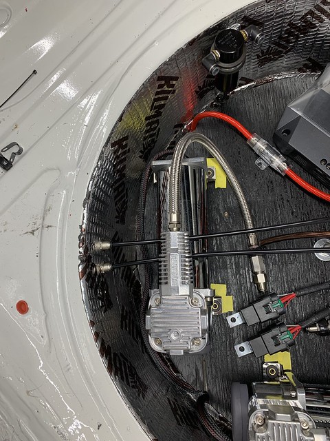

    Suspensions is pretty much installed just need to wrap up a few loose ends and start bending my hard lines. Waiting for my 5-lug stuff to come in before i can mount brakes.
    Tucked the main part of the harness against the floor and built a false floor for everything else to sit on.
    Click image for larger version  Name:	49644287902_5732e5f01a_z.jpg Views:	0 Size:	63.7 KB ID:	9913571
    Soft lines will mount to bulkheads and come up through the main floor into hard lines.
    Click image for larger version  Name:	49701322962_c41a2ec0ac_z.jpg Views:	0 Size:	103.5 KB ID:	9913570
    Ran the lines to 2 bulkheads on either side of the rear section of the spare wheel well. This will allow easy access to them from both the inside and outside of the car if needed.
    Click image for larger version  Name:	49700481673_0620e34eae_z.jpg Views:	0 Size:	69.4 KB ID:	9913572
    Click image for larger version  Name:	49701431997_4bd67664dc_z.jpg Views:	0 Size:	58.0 KB ID:	9913573
    Click image for larger version  Name:	49701012891_1c9128269f_z.jpg Views:	0 Size:	114.8 KB ID:	9913574
