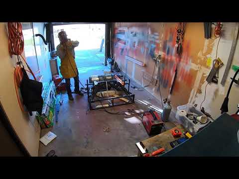

              When I cut this subframe in half it's going to be in two pieces. I figured the first thing I needed to do was put it in a jig. I think there are a couple of ways to do this. Were I to do it again I think I would just weld pars directly to the subframe. I chose to drill holes in barstock, attach it at the suspension points, and then weld it to a frame I built. With the idea being to maintain the same suspension points.
              Experimenting with timelapse videos on the GoPro

                After that I added a bar across that will eventually have the motormount attached to it. I went with 1.75 DOM steel tubing that is spec'd for roll cages. I figured if it's strong enough for that it's probably strong enough for this application. When I start cutting the center section out it will help provide support.
