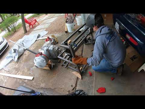

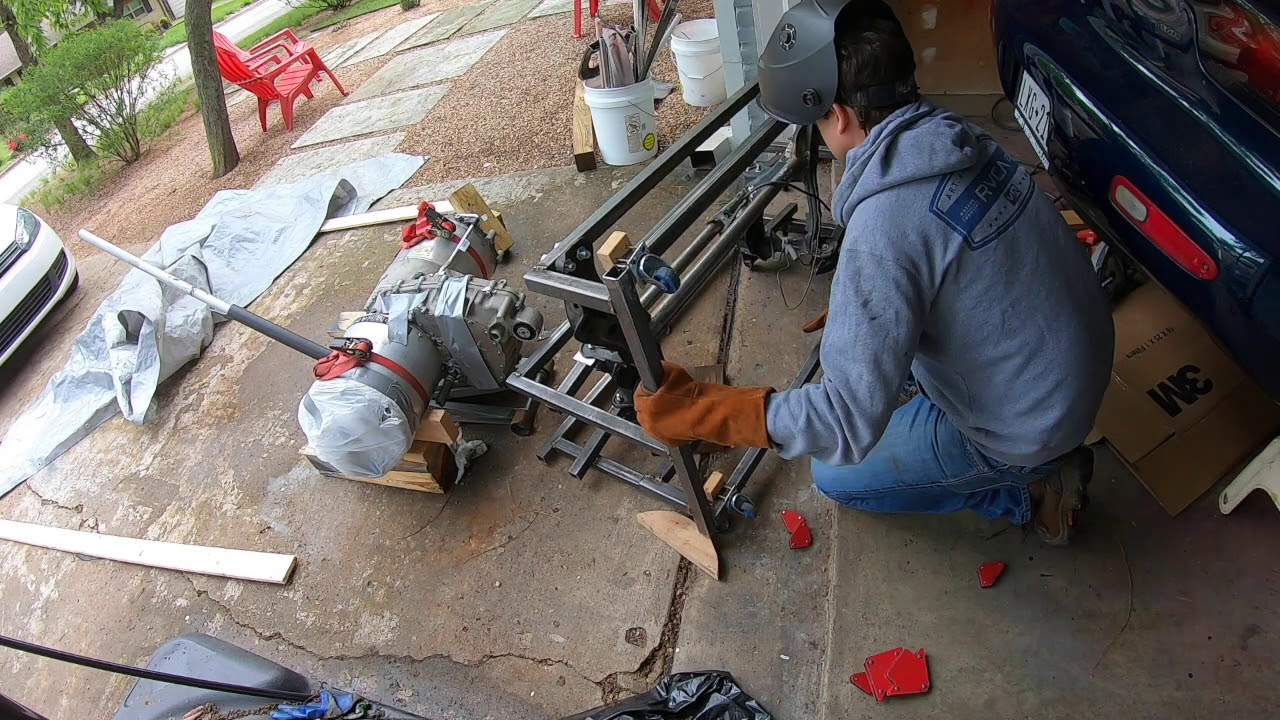

        Progress this weekend. I now have the two top lateral support bars completely welded in. I still need to clean up the welds more after I take it out of the jig but they are pretty much done.
        My son always seems to show up at the end to check my work....
        Next I'm planning to add some bar stock on the bottom that will bolt in. I'm sort of just using whatever I have around the house....since we're on lockdown. You can see it mocked up in the pick below.
