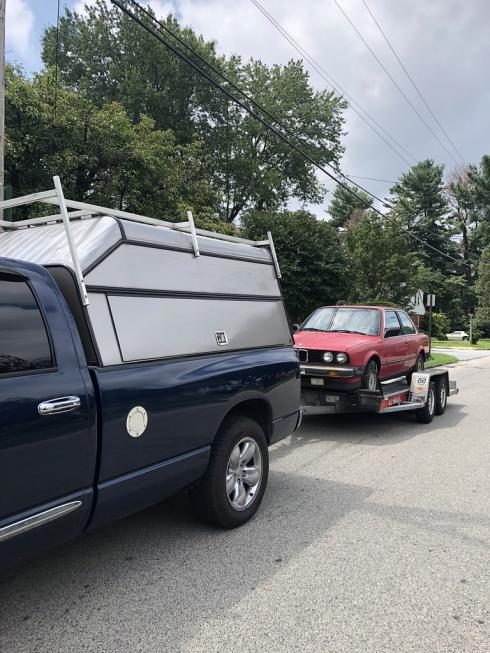

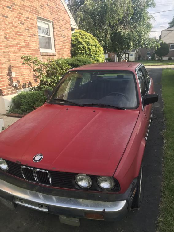

    Buying the car!

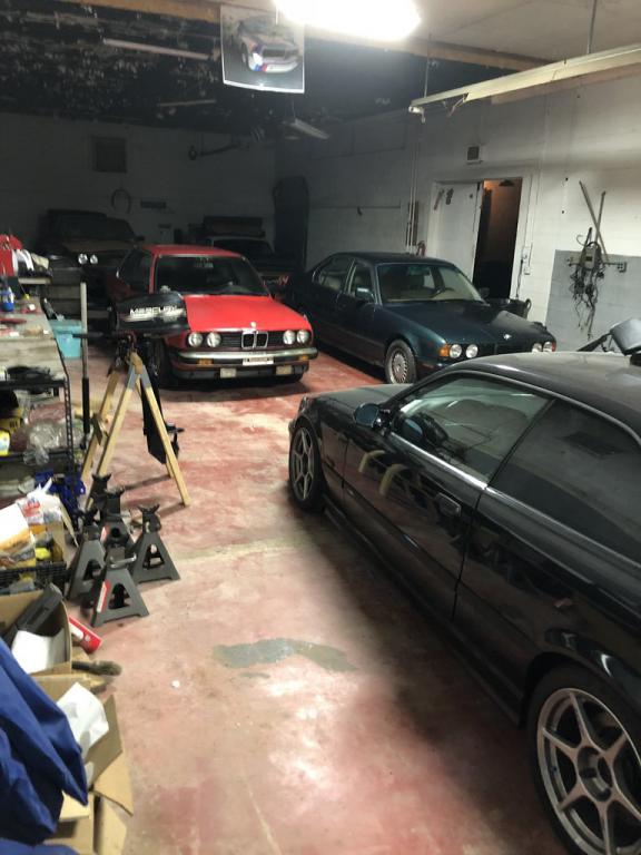

    New home!

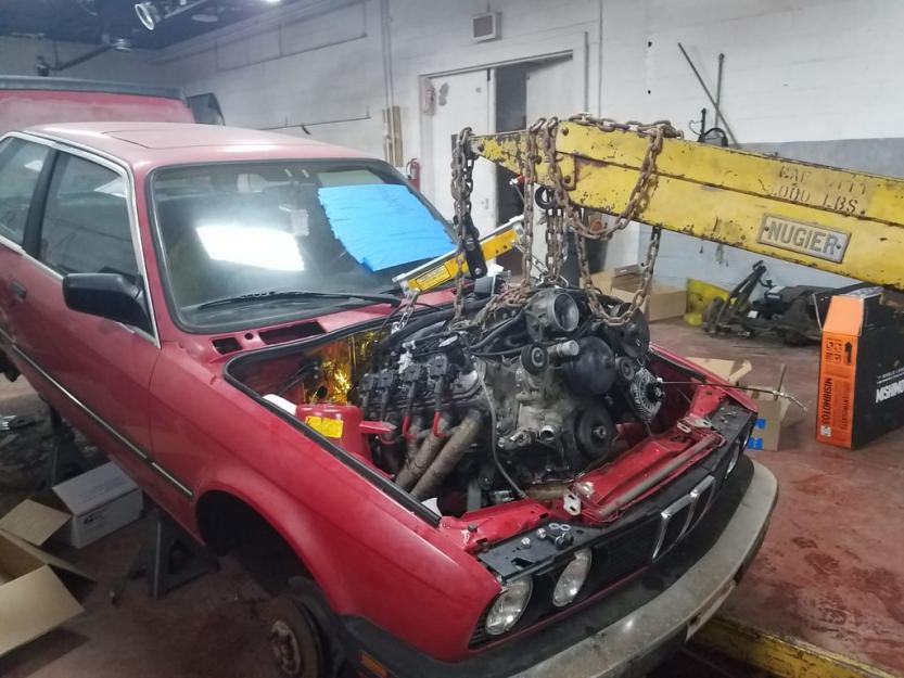

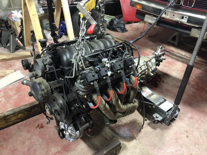

    Yanking the motor

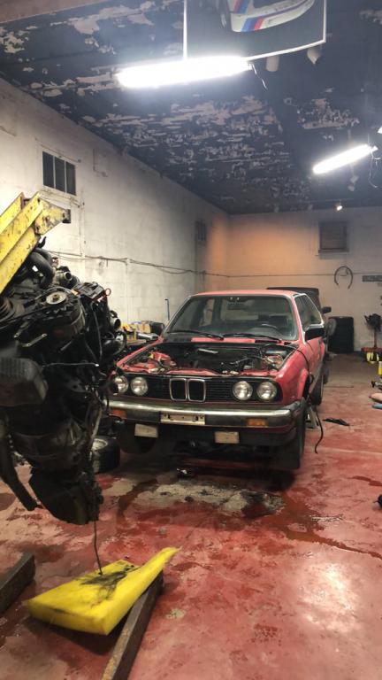

    First test fit!

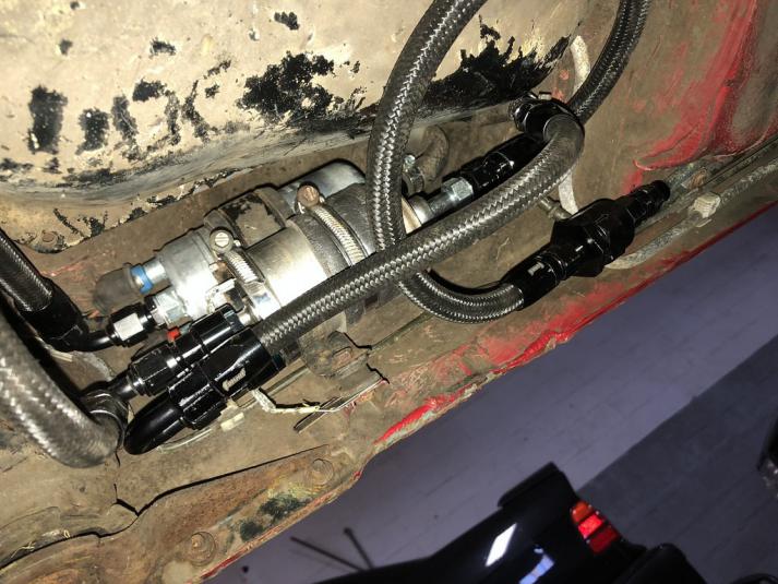

      Fuel system made up

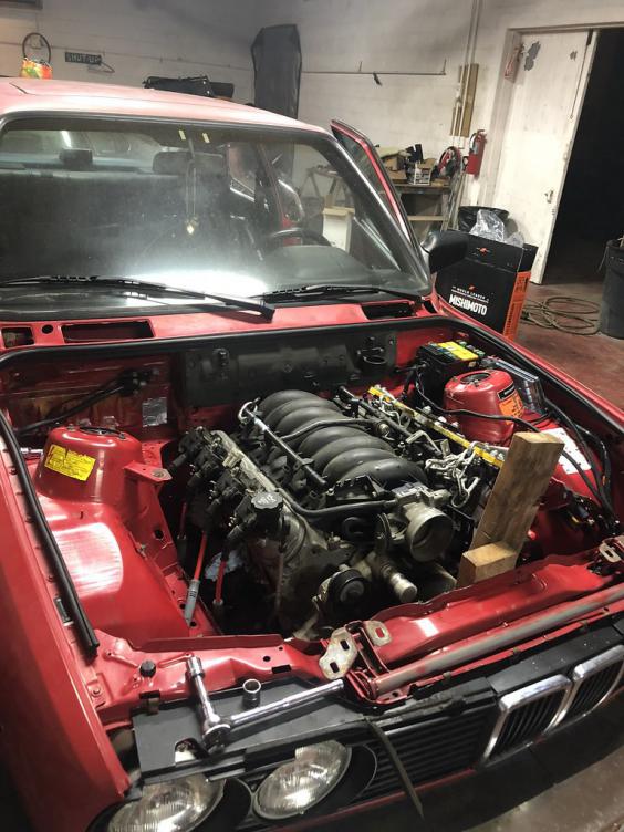

      Motor going in for the last time!

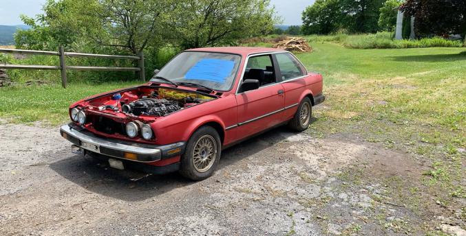

      2nd start! :) (video)
      E30 build by Isaac Marianni, on Flickr
      First time seeing daylight under its own power

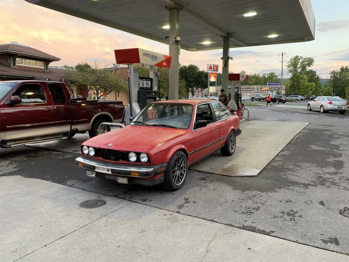

        First trip to the gas station
