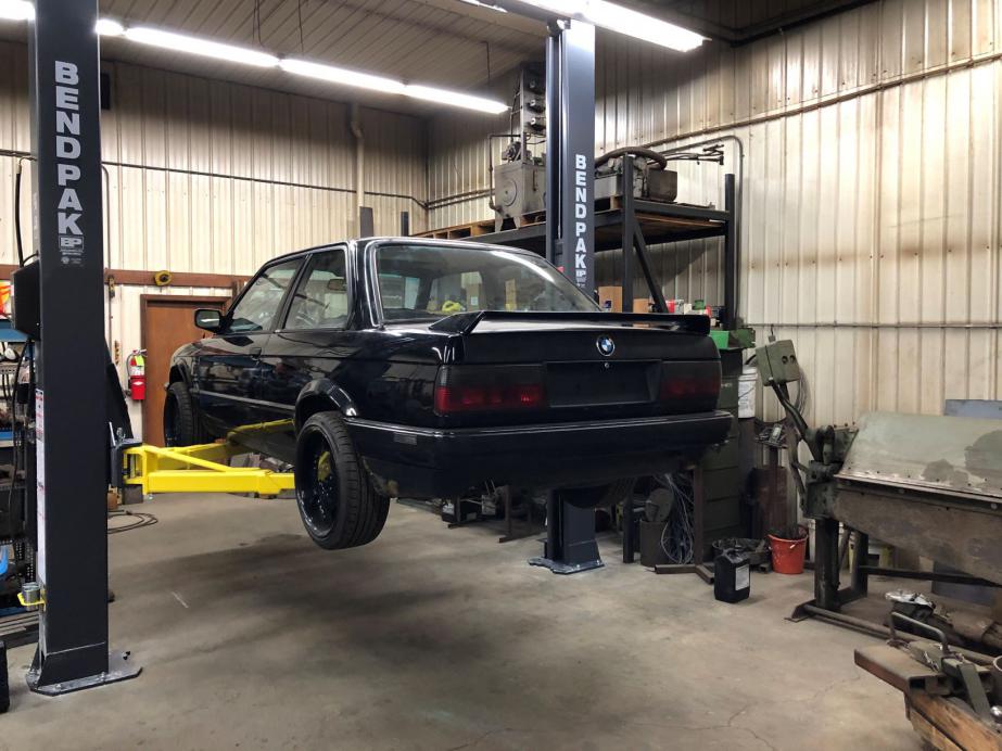

    On the bright side, when I mentioned that my son's grandpa has been a huge help thus far, he came through big with a present for himself, a Bendpak lift!! Now we'll be able to really get into the underside of the car without hurting our backs or doing subpar work because we're cramped underneath the car on our backs.

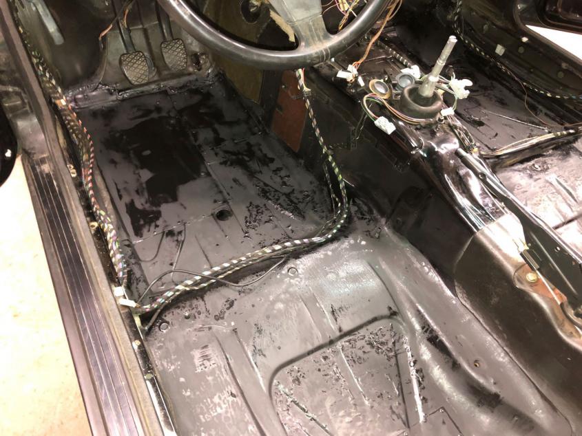

    We've just about finished up the interior/floorboard rust repair. We've painted on the Por15, a couple coats of it actually, then once that was dry I've redone the interior sound deadening both for comfort as well as the eventual audio build. The carpet is done getting dyed (pics soon) and we're about to try our hand at dying the door cards and rear side panels black. We've picked up some leather dye from the local farm supply store (for saddles) which is supposed to work great.

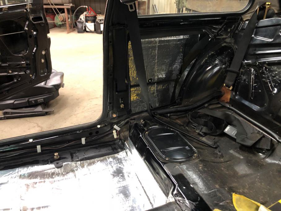

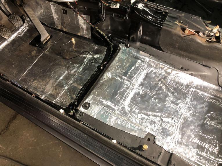

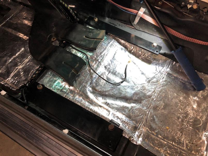

    Sound deadening has been applied to the floor, some of the footwell sides, the rear sheet metal between the trunk and cabin, backseat sides, inside both doors, and will get applied to trunk once that's cleaned up.
Name:	Interior sound deadening 2.JPG
Name:	Interior sound deadening 1.JPG

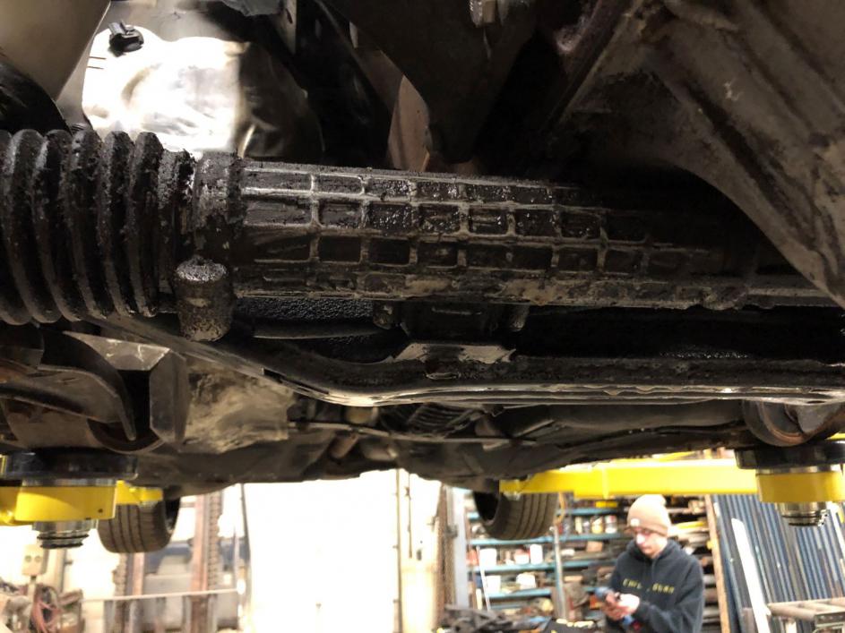

    Also on the list now that we have the car up is to start cleaning 30 years of crud, oil, grease, and who knows what else off of the underside of the engine back and subframe. Yuck.

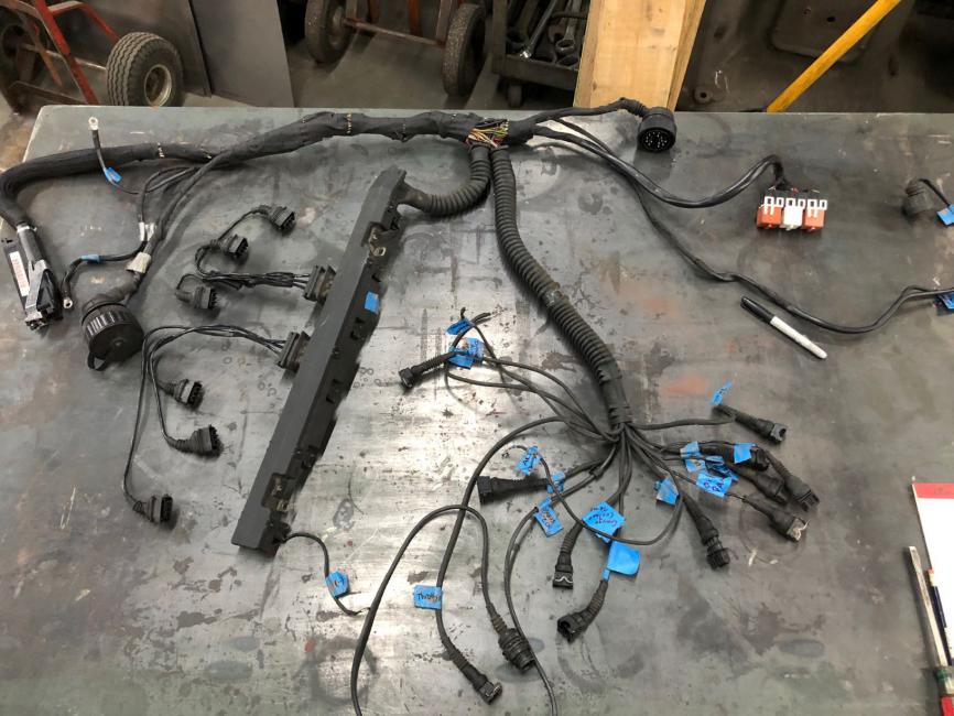

      Here's my issues dealing with the wiring harness. The M50 harness that came with the car (not installed) was supposed to have been built just for the swap, and already has the e30 driver side connector wired in. But I've gone through the harness multiple times and cannot find the crankshaft position sensor plug, and the cam position sensor plug has the wrong connector (harness side should be female, mine's male). I've pulled back the boots and checked the wire color on every single plug. I went ahead and ordered another harness off ebay, just a straight up M50 w/vanos wiring harness, and it too appears to be missing the crankshaft position sensor plug, and the cam position sensor plug is backwards. I have gone through the Bentley manual and wiring charts and checked every single damn plug on both harnesses. Either I'm doing something dumb, or I just have shitty luck and have gotten screwed on two harnesses.
Name:	wiring harness.jpg

        What wiring do you have at pin 48 and pin 83 of the PCM connector? Assuming i'm looking at a compatible diagram to your M50 (its not specified) pin 48 is a yellow CKP supply voltage and 83 is a black signal wire. If there's wiring at the DME then just trace them out.
        • M3Gonz
          • Nov 2020
          • 44
          I was finally able to figure the wiring harness mess, the only issue left over is the wrong plug (male) on the harness side for the cam sensor, and there's a parts car at a junkyard that we can grab the plugs we need from. I was hoping a while back to get the entire harness, but some savage had cut it up trying to get to something else so it's nearly worthless, other than having the plugs I need to splice in.

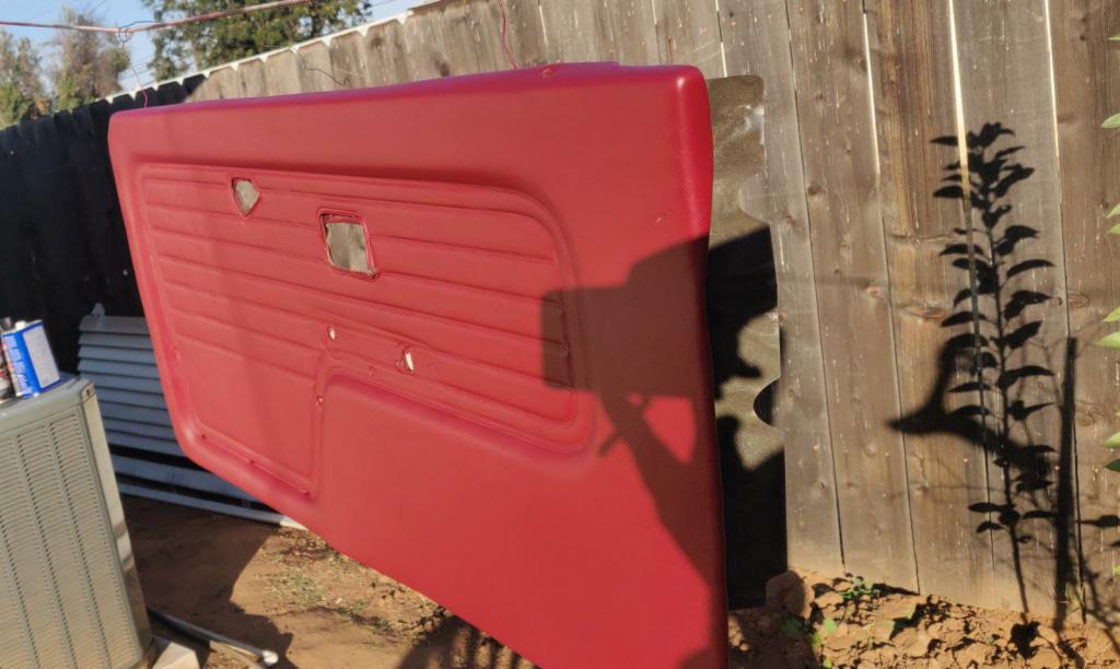

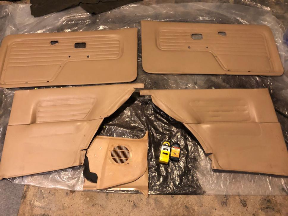

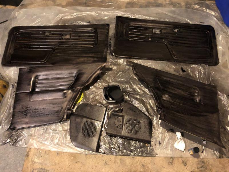

              Been working at home down in the basement on dying the door cards, rear side pieces and footwell speaker covers black, they're turning out pretty good! Taking a few more coats than we realized would be necessary, pics below are after I think the first coat, you can obviously see the coverage isn't perfect yet. It's much better now after 3 coats, just working on getting it nice and even is the trick.
              Before
Name:	door panels before.JPG
              After first coat
Name:	door panels after.JPG
                Before
                Click image for larger version  Name:	door panels before.JPG Views:	15 Size:	88.1 KB ID:	9967490
                After first coat
                Click image for larger version  Name:	door panels after.JPG Views:	15 Size:	86.6 KB ID:	9967491

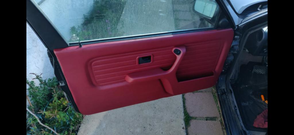

                I would recommend using (Dupli-Color Vinyl and Fabric Spray Paint) you can buy it from Oreilly works really good because it is a dye in a spray can and will make your life easier
                https://www.oreillyauto.com/detail/b...leather+&pos=7
                here is my e30 interior example
                • M3Gonz
                  • Nov 2020
                  • 44
                  I picked up the Duplicolor matte black spray and it finished off those door cards and other pieces really well, thanks for the tip! I'm picking up a ski pass rear seat in tan today (scored it for free) and am going to do both the wipe on dye with the sponge, then a few finish coats with the spray in matte black.

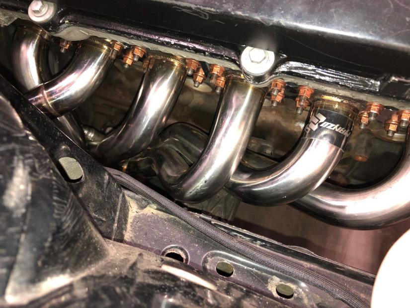

                    What's the saying? Two steps forward one step back? I think that has to be the motto of these kinds of projects. Got to work on the car yesterday, the ebay exhaust manifold came in, it's a Manzo, which is a brand I've seen referred to and is certainly budget friendly! It's great that we have the exhaust manifold, but it's also the first time we took a good look and realized we're missing 20 out of the 24 manifold studs! Oh well, there were enough there to get them fitted in place and around the engine mount arms etc. We had to heat up and massage one of the pipes a bit, similar to what I've seen in multiple online videos of exhaust manifolds and M50 engine swaps. Luckily we have access to an acetylene torch that heats up that pipe in literally 5 seconds, it was a piece of cake!
Name:	exhaust manifold.JPG

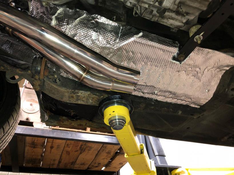

                          Here's the first update, the rest of the hardware for hooking up the exhaust headers showed up. That's all set and in place. I also picked up some new heat shield for under the car and the header, that's in place and looking good. Super easy stuff that simply sticks into place with a high heat resistance. For now it looks clean too! Then a big win a few weeks ago was getting all the coolant lines under the intake manifold set up. I purchased a new coolant pipe set up but had to rig it a bit as seen in the photos. The metal coolant pipe looks like it would normally fit right into the engine block, like it does on our E36 M3, however this M50 block already had some type of adapter for rubber that I could not get out of the block. Next is figuring out the rest of the vacuum lines and other assorted hoses and getting this thing fired up!

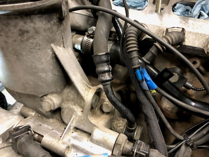

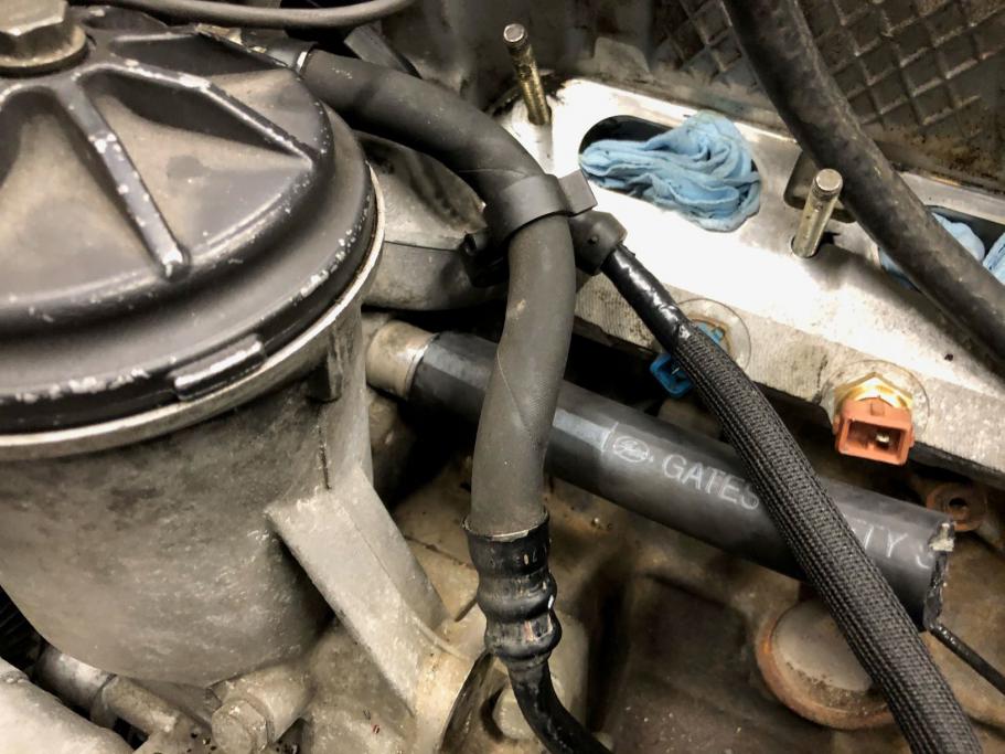

                          Coolant Pipe installed, pardon the mess of plugs etc.
Name:	coolant pipe.jpeg
                          Coolant pipe adapter, just a short piece of hose.
Name:	engine block outlet.jpeg
Name:	Block outlet with coolant pipe.jpeg
                          New manifold with studs!
Name:	header with bolts.jpeg
                          And new heat shield:
Name:	heat shield.jpeg

                            Now here the new dilemma, we got the car started, it sounds great (for no muffler), but it won't run without a primer fired into the air intake, as seen in the videos.
                            Here's what we've got, I'm going to continue to research as well as start a new thread in the M50 swap forum:
                            Fuel pump works, there's plenty of fuel pressure. I know this because we ended up with a big leak in one of the lines that we had to fix. It just appears that the injectors are not firing. It's an M50 fuel rail with the FPR integrated into it, and the vacuum line running off the back of the intake manifold next to the intake air temp gauge.
                            I believe we're running the correct ECU, someone asked me if it had EWS, but if it did would the car do as much as it does (like fuel pump running and engine running on brake cleaner?!)?
                            Other thoughts welcome, I'll take this over the 24v swap section of the board.
