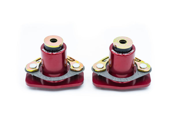

            Check out the ground control RSM that moves the Mount point up higher. Are they E36/46 rear shocks?
              Maybe this would help?
              ive seen this before. id like to stick to using a spherical rear mount over a solid bushings for the shocks. these would also make it a bit more difficult to adjust dampening. not too big of a deal-breaker, but something to consider.
              the shocks are whatever MCS provides for their 2way shocks. not sure if they reuse them for other bmw applications, but i wouldnt doubt if they did.
