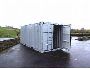

              Surprised no one mentioned one of these as an option....
              Do some shopping around (even on Craigslist) and you can get a deal on a 20x8x8 container. No need for a concrete pad....just a level surface with concrete blocks or gravel bed (check your local building code). The posibilities are endless with these things - with a little creativity you can make them look much nicer. If you have the space, opt for a 40x8x8. Room for an E30 or two and your chit.

                LUL! thought that huge thing in the background was the shed
