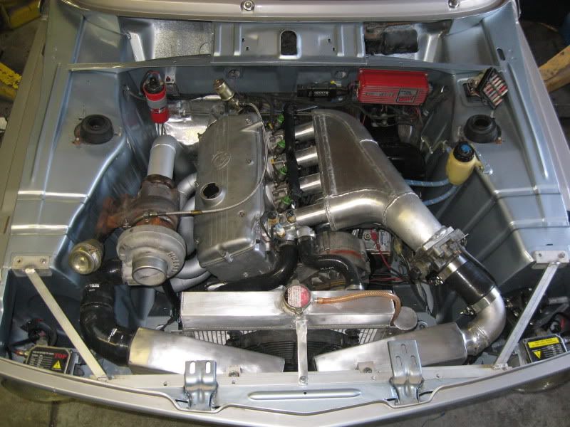

    I had a major case of FAIL today
    I've been redoing the Engine bay in my 2002 for the last couple of weeks and after some minor fail late yesterday ( flat ass dead battery ) I was able to start it for the first time, rebuilt motor with some mild head work and a mild cam ( 276 I think ). It fired just fine but my oil pressure gauge didn't budge after about 3 or 4 seconds of running, no big deal just turn it off and check for oil in the turbo feed line to see if oil is actually getting to the top end. When I get out of the car I notice a HUGE puddle of oil under the car, hmmm that can't be good so up the lift goes again and it's still pouring out from behind the flywheel, more hmmmmm. Pulled the tranny ( not real easy in a 2002 with a 5 speed swap ), pressure plate and clutch, what do I see, the plug missing for the main oil galley. FFFFUUUUUUUUuuuuuuuuu
    I know CSB.
    Here's a pic of the redo so far,

          To the engine, not likely, eveything was slathered with assemble lube and there was no load on it. To my fingers, yes, two fresh busted knuckles and a smashed finger nail.

              What's up with the split intercooler design?

                  More intercooler in the V shaped nose of the damn car.
