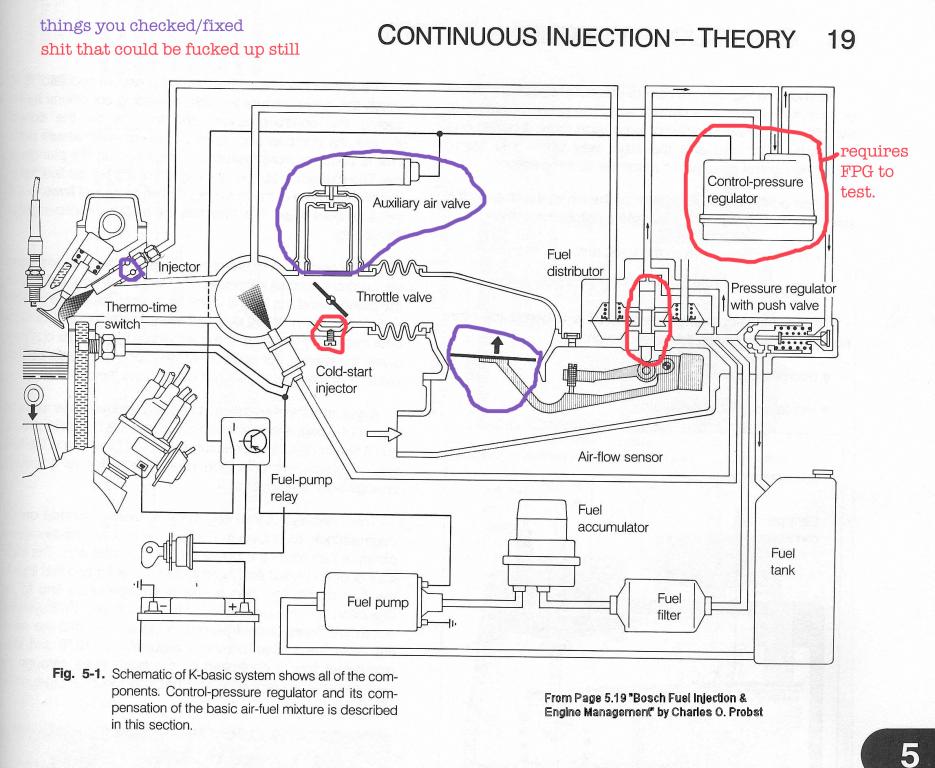

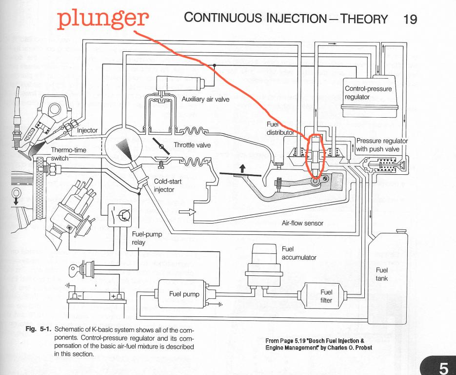

If the plunger is gummy and hanging up inside the distributor or some asshole fucked with/lost the idle mixture screw in the injection unit it's possible that they compensated for it by messing with the idle adjuster screw at the throttle body. If you look at the diagram I just put up you'll see that the idle mixture adjustment just plays with the relationship between the airflow arm and the plunger. This does not affect idle speed directly so much as a/f mixture at any given idle speed.Comment
Good point. Someone's obviously been tampering with it. You could at least obtain a new idle mixture screw from a second hand unit. Then again yours is probably laying in the bottom of the air box somewhere.Comment
Have you located the idle screw on the throttle body yet? I've seen two types: one has a hex head which protrudes from the throttle body, the other uses a flat head screw driver slot and is flush or sunk into the throttle body.
Checked ignition timing? That can cause a high idle as well.Comment
