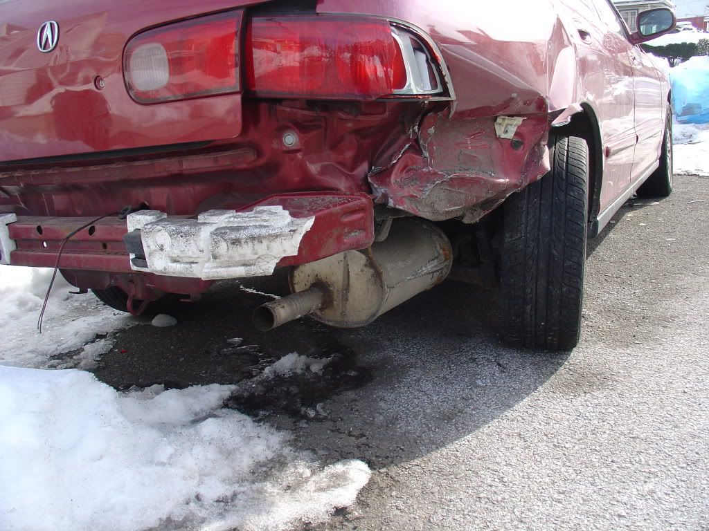

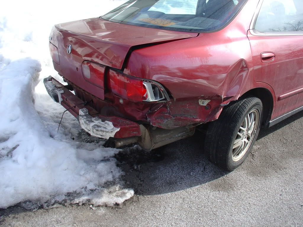

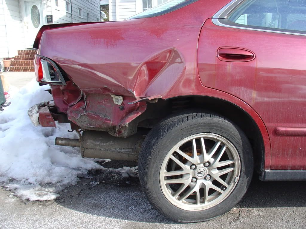

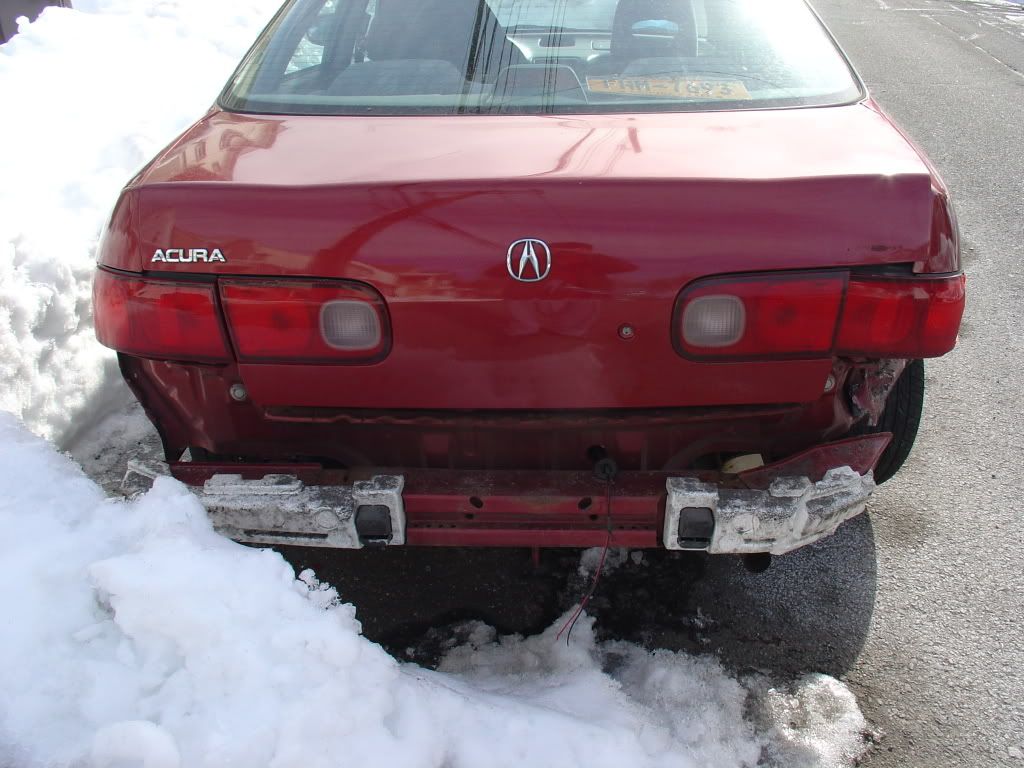

    guys i need your advice or suggestions. our car got hit when we had the ice storm. it was a hit and run. my question is can this still be fixed and around how much. engine and tranny are really great and car is very clean. this really sucks :(

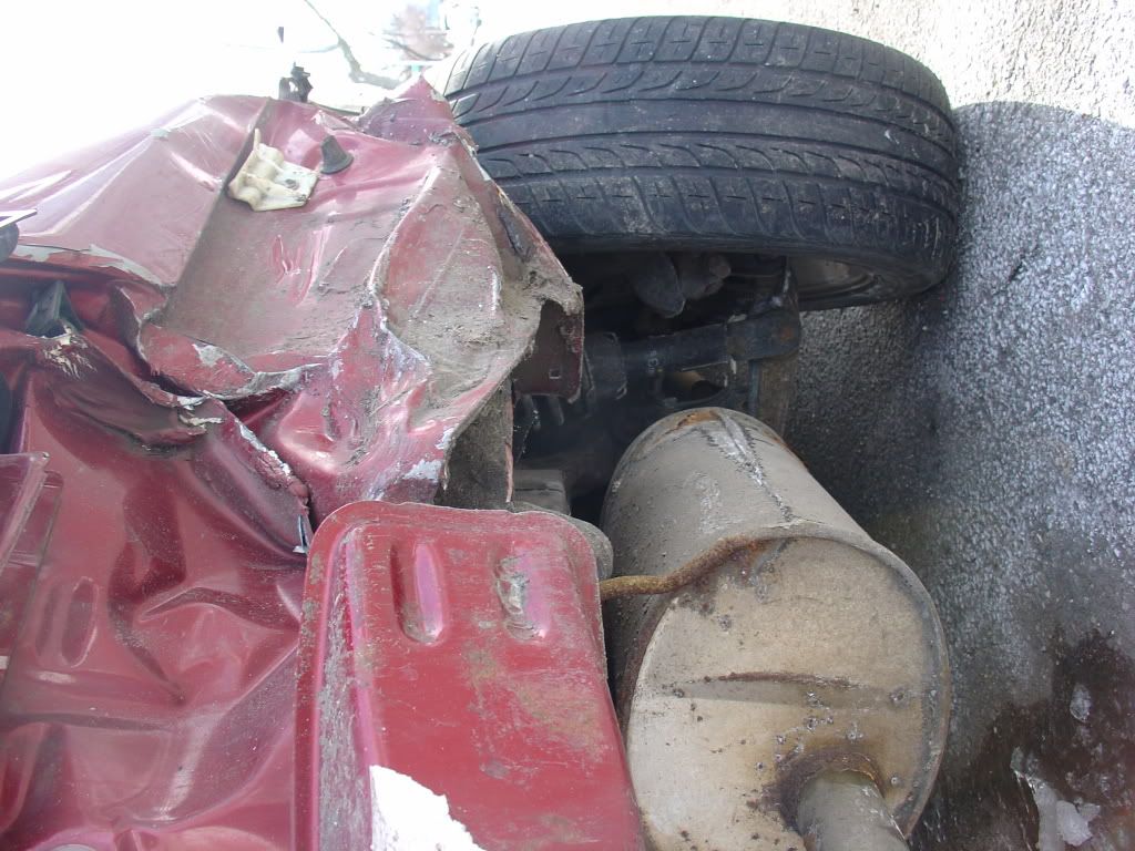

    Done correctly, that is about a $4000-$4500 repair. New or LKQ quarter panel, aftermarket facia, absorber, and reinforcement, aftermarket tail light, quarter extension, trunk floor, R&I the rear glass, gut the back door for the blend panel. The best way to save $ onthe parts is to see if you can get a complete LKQ rear half and strip it.
    Sorry to say, but that is a good money making hit you have there.

      I hate to say it, but your insurance company will most likely total that. Fixing it correctly will be extremely cost prohibitive.

        thanks. i figured it would be best to sell the car as is. i'm sure a lot of civic owners would love to get the motor in this car.

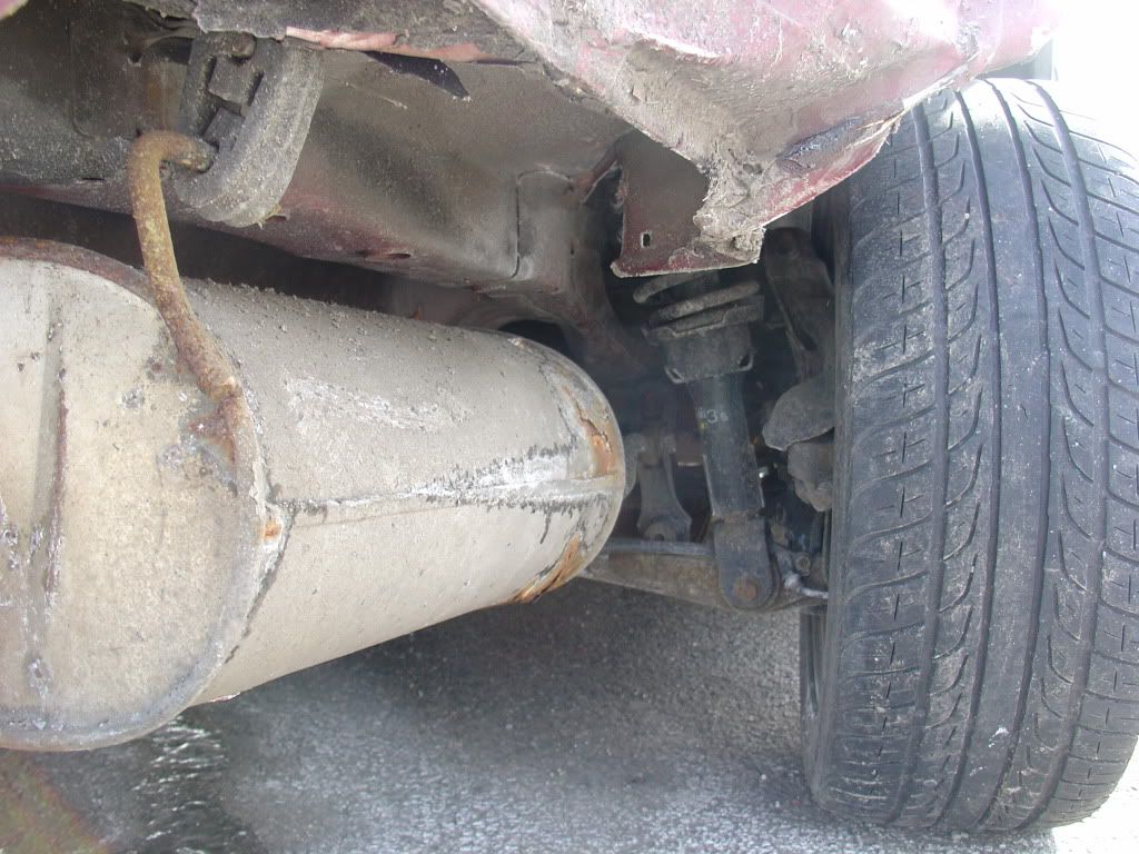

            yea its totaled. you also have some suspension issues. the rear wheel has mad toe in.

              Totaled.
              As mentioned, you have a lot of sheet metal issues, the quarter, the floor pan, the rear body panel. Plus a helluva of lot of R&I labor. Plus mechanical to get the suspension figured out.
              It isn't totally un-fixable, but you are looking at whole lot more money invested than just buying a section from a wrecking yard and having a shop do the rest. I'd imagine the labor just to set-up measure and do some pulls would but this over threshold.

                shitty. but if its got a b18 and the 5spd trans to match, you can make your moolah back. seats and wheels go fairly well off of those too.
                maybe you should build up a > 600 dollar EG6 shell with your motor/ trans...

                  just part it out dude if u don't want to spend any more money on it.
