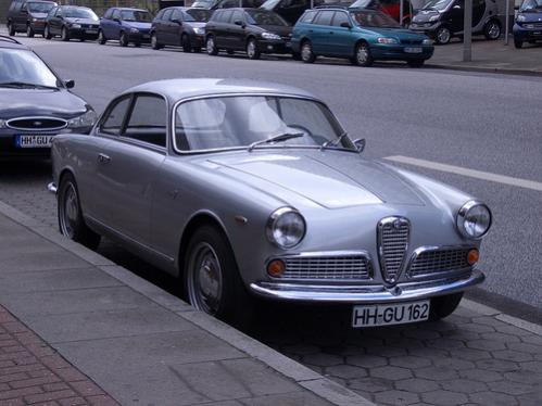

                Silver isn't a bad color for them.

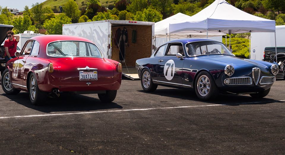

                      You do realize that is my pic. hahaha I shot it at the CSRG event back in May. I love the blue car.

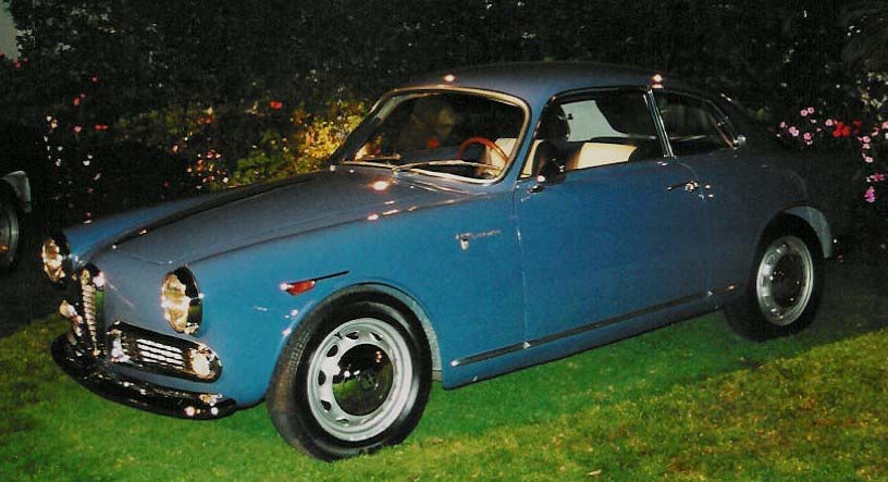

                        This is kind of a cool color...
