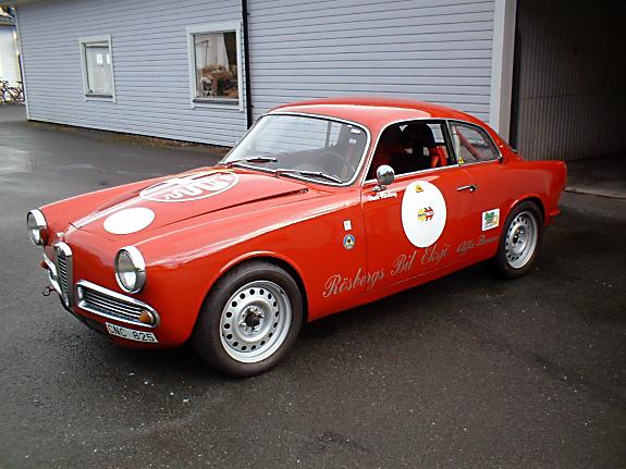

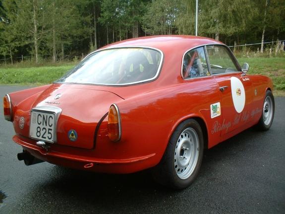

                                I think these might be Saab wheels. 61 Sprint, 175+hp, 6x15 steel
Name:	6x15 175 1961.JPG
