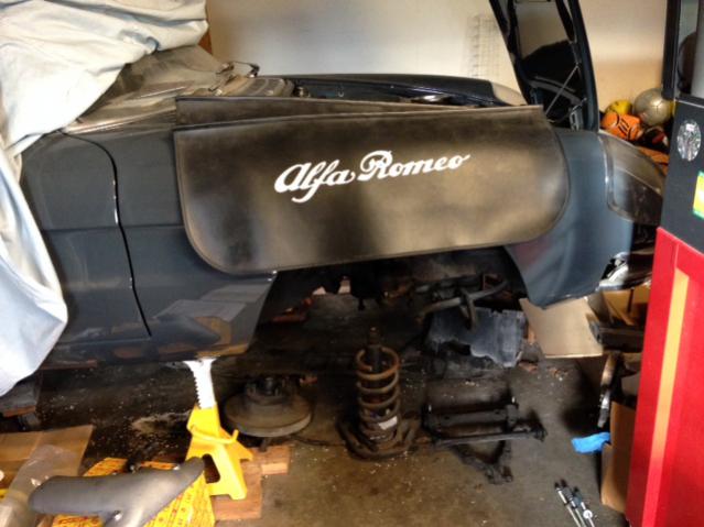

    Centerline yellow sport springs, shocks OEM Koni. Rear end 4.56, same as stock (these came from 72-79 105 cars). Adjustable front control arms.
    The only reason I can afford to do all this is I bought all the pieces years ago and they're sitting in boxes under the car.
    My son was excited to see me out there (after spending last winter replacing an Audi A4 engine, which was not fun). He took pictures.
    The air box has to come off to even see the upper control arm bolt, which is like 22mm. There's no swing room with a ratchet or wrench between the carbs and the body shell - I'l have to figure that out.
    But that let me check the carbs again, as there was confusion back in the 80s about which carbs got swapped to which engine I had. So all is good - 40DCOE27 like they're supposed to be.
    Garage is a mess - that was storage underneath there for a long time. Found an old piano dolly, and an E30 belly pan!

      I ran the Centerline yellow springs on my GTV. I also had the adjustable upper control arms. One note, before you put those in, get poly bushings as the rubber ones that fit into the body will self destruct in short order. (ask me how I know.) Removing the control arms once those bushings are dead is not a pleasant task. (It took about 6 hrs per side using everything I could think of to extract them from the body) My thought with the Bilsteins was that due to the higher compression damping rate of them, they might help reduce the body roll due to the horrible roll center that will occur with the springs. Yes they are 1400 lb springs but even so, body roll is still hard to control even with a big front bar (that can tear the mounts off the body.)
      Just thoughts from when I had the GTV, and further thoughts for setting up my Sprint when the time comes.
          I'm doing that as we speak - ordering the lower arm spherical bearings, which people install in the upper arm where it bolts to the shell. Some guys are saying those upper aftermarket rubber bushings lasted them 1000 miles, and the whole damn thing had to come apart again. And like you said, the rubber isn't bonded well on the new ones, so it migrates out of the hole and jambs so you can't get it out! Also getting poly to replace the castor arm bush. Hard to pay $200 and throw away 4 brand new bushings.....oh well, do it once, do it right.
