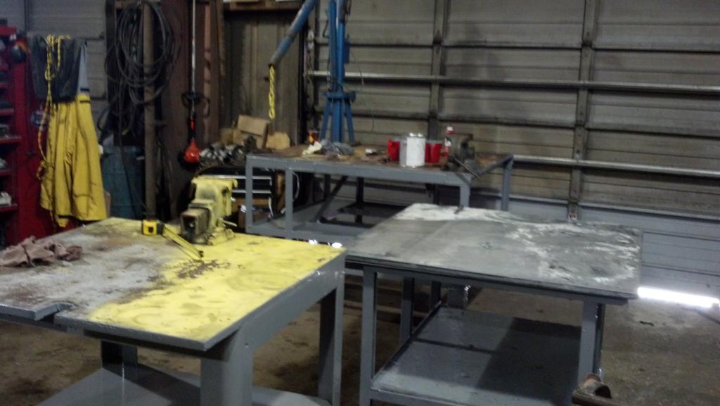

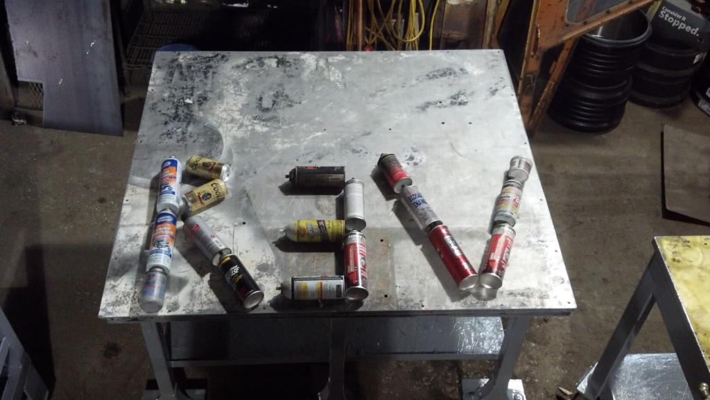

This is a shot of some steel tables I bought and cleaned up. Painted them shop grey(Rustoleum). They are big and heavy, I also put caster wheels on all of them. The one on the left with the yellow paint has a one inch steel plate top. The one in the back has an electric over hydraulic crane mounted to it, it actually belongs on the back of a service truck. The one on the right has an aluminum top(nice for aluminum welding, I hate oxide contamination).sigpicComment

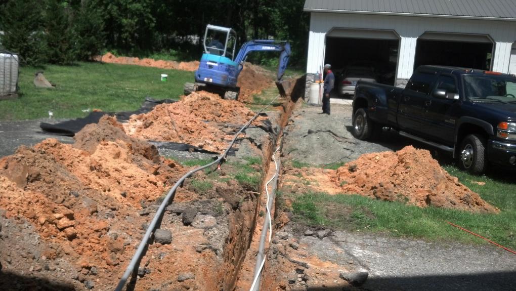

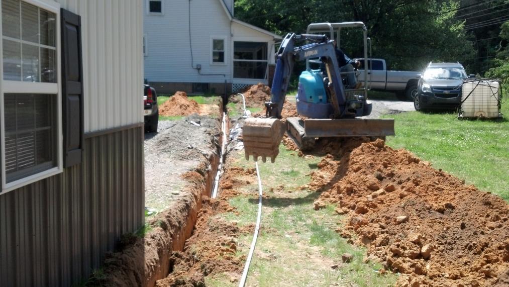

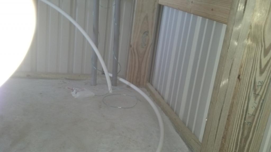

Saturday morning was reserved for a two and a half hour ride to chriskbmxs' house, a member here, I was supposed to pick up my hood and some bumper trim. Instead I spent the morning with my brother and stepfather working on the garage. I have been wanting to put electric and water in now that I have my c.o. and today was the day we started. My father brought over his mini-excavator, and his operator friend came over too. We trenched from the telephone pole to the garage and from the garage to the house. We laid conduit for electric 2 1/2", fios cable and (telephone if I ever wanted)1 1/2",and we also laid a 3/4" line of pex pipe for water. Everything is backfilled and tamped with a jumping jack.
For those who are curious, I was kind of forced into running both buildings (house and garage) on one electric service. The electric company would not let me have two meters at the same address unless my second meter was billed as commercial. Not only is the rate higher but there is a $30 monthly fee just for having a commercial account. $360 a year just to have the account, not including the cost of power, no thanks. However I didn't want to run the garage off of the house, dimming lights in the house and all that anytime we strike an arc or use some real power. So since I have access to a free mini-ex and all it was going to cost me was the conduit and the 4/0 power cable and the pex pipe, I decided to go underground. I'll be feeding the garage first (my meter will be hung there), and from there it will feed the house. The house will feed the garage water, fios, phone and security cameras. I took some pics but I have not downloaded my phone yet. My wife has to do that for me. Hopefully tonight I will be able to post a couple.sigpicComment

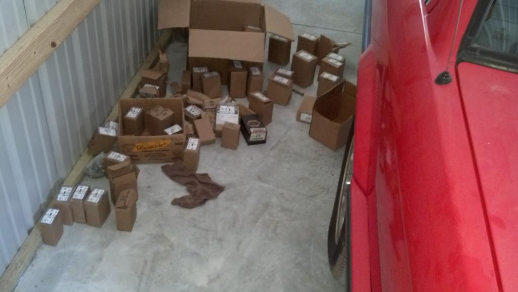

Some of the nuts and bolts have arrived, still waiting on the rack with bins. This is only some of them, I purchased 6mm-10mm, in 1.0, 1.25, and 1.5. Some of them up to 60mm. All are 8.8 or harder. Also purchased 1/4-1/2 in sae and uss up to 3". I get a really great deal on hardware from Cumberland truck parts. We purchase all our little stuff from them at the truck shop. Butt connectors, electrical tape, tek screws, machine screws, nuts and bolts, etc. I know some of you my think this is a little extravagant but I really hate stopping a project or progress because I need to take a trip to the hardware store.
