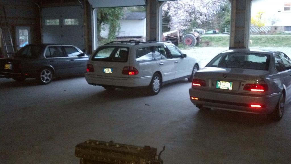

                          Still no cert, but I've moved in anyway. The builder has been going back and forth with the county guy for the last few weeks over the stone facade. They didn't get an inspection before they put it up and they had to prove that they put up two vapor barriers before it was installed. I'm so frustrated with this project at this point I've given up being angry. I can't let my blood pressure get out of control or my eyes will pop out of my head. The latest from the builder is "the county has everything they need and they are reviewing it now, we should know something in a day or two." I don't know if I'll ever pay them the remaining 8k.
                          • bmwstudent

                                #75
                                I got it. Finally. And now some cars can come home.
