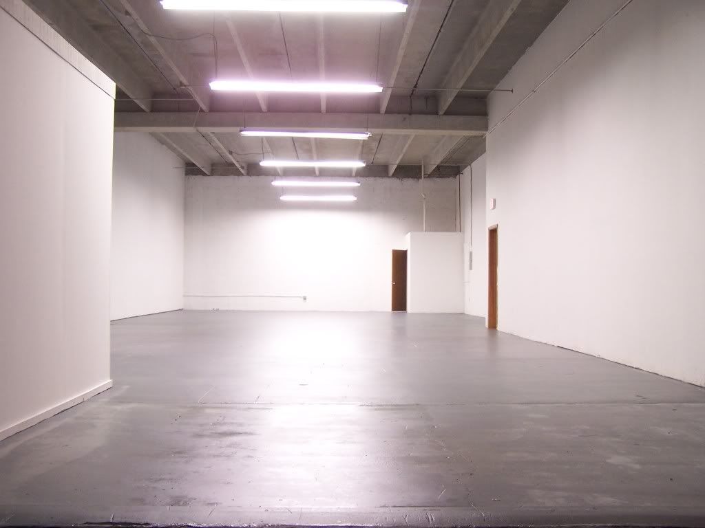

                    I have painted both my shop floors with one part epoxy and it doesn't last long. Couldn't afford 2500sf of 2part but one day will.
                    john@m20guru.com
                    Links:
                    • Thizzelle
                      • 4422
                      How much floor traffic does it see though? Somebody's garage doesn't see as much as a commercial shop.
                      "I wanna see da boat movie"
                      "I got a tree on my house"
                      • ForcedFirebird
                        • Feb 2007
                        • 8300
                        Spill brake fluid on it once and it will strip right back to concrete. Trans fluid and fuel will make it look like alligator skin in an hour, and it scratches it very easy. My old shop was just me and 1000sf and it looked decent for about 6mos.
                        This was after pressure washing, degreaser, acid etching, then 1 part epoxy.
                        It cost me about $1200 in 1 part and a ton of labor. Looked real good at first.
                        Old shop when I moved in...
                        Old shop when I moved out...
                        New shop when we moved in (lacking final coat in the front)...
                        Too much stuff in the shop now to give you a good view, but the entire floor now looks like this...
