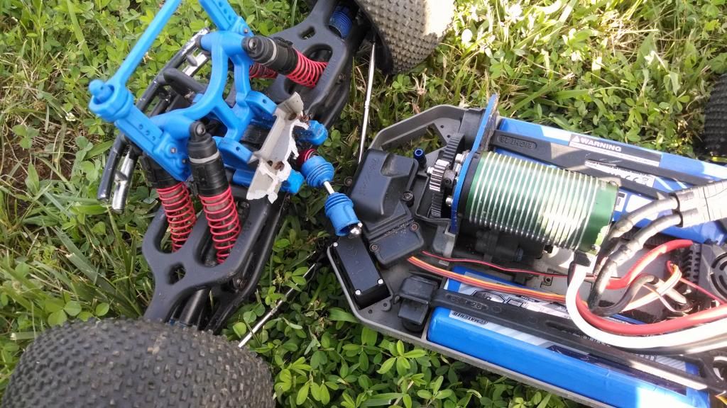

      So I'm at the beach this weekend and the emaxx needed some repairs, so I decided to make it bulletproof.
      Already had rpm front control arms and bulkheads, and a rear rpm shock tower. So I purchased an rpm tru-trac rear control arm kit, rpm rear bulkheads, rpm shock tower for the front, hitec 645mg servo and aluminum horn, new body, new pins, and new control arm pins.
      Spent 6 hours rebuilding the truck and putting new fluid in the empty diff's, got it all together and working perfectly.
      Got to the beach yesterday morning at 6:30 and busted out the 6s of fury. The truck hauls ass, doing at least 40 mph through the sand, and shredding the rear u joint within 15 minutes.
      Since upgrading to the Mamba monster and adding 6s, I haven't made it through a single charge without breaking something. Traxxas metal driveshafts are already on the way. All that's left are axles and then I'm sure it will be the diffs that break.
      I'm thinking about putting away the 22v setup and running4s from here on out. I never thought an rc car could have too much power.

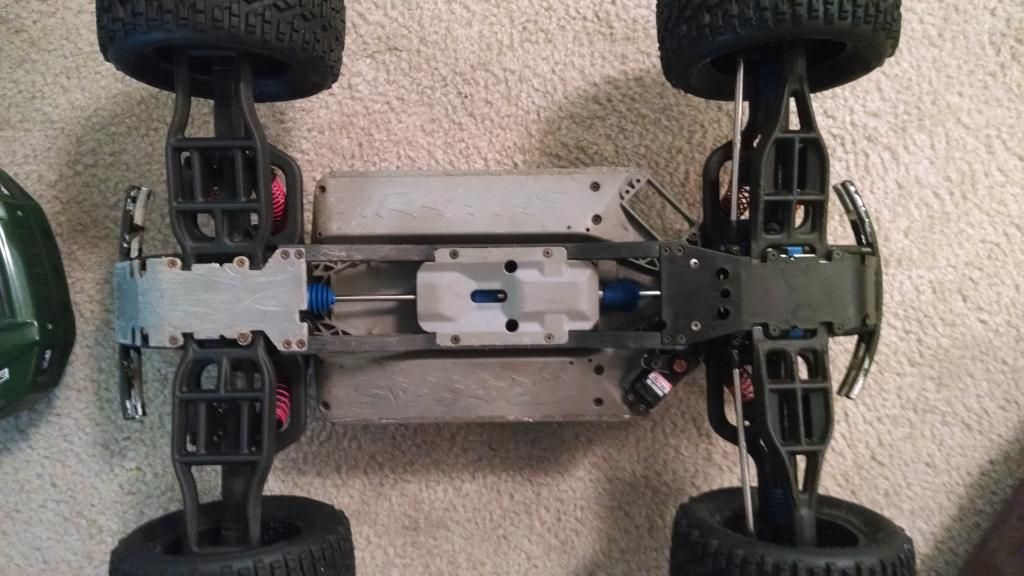

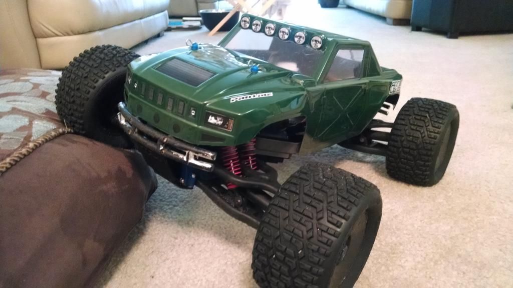

          Just about unbreakable. Still need shocks and axles, but she's getting there. Been a few years now in the making.
          New driveshafts installed. Also decided to just keep using/breaking stock skid plates. They should be a wear item anyway. Also note the rear control arms. So nice to not have the rear wheels toed out as far as possible after every cartwheel.
          New body, spent as little time as possible on it. I'll still be sad when it get's destroyed. Does anyone know where to get body's that don't set you back $30+?
          The last time I was building this my wife told me to just keep sitting in the corner like a 10 year old playing with my toy. I told her that for every $10 I spend on this it would be $100 on a car.
          EDIT: Just noticed from the photo's that one of the front control arms got installed upside down on the last tear down. Oops.

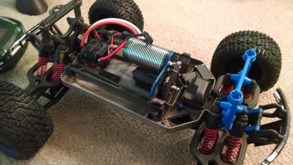

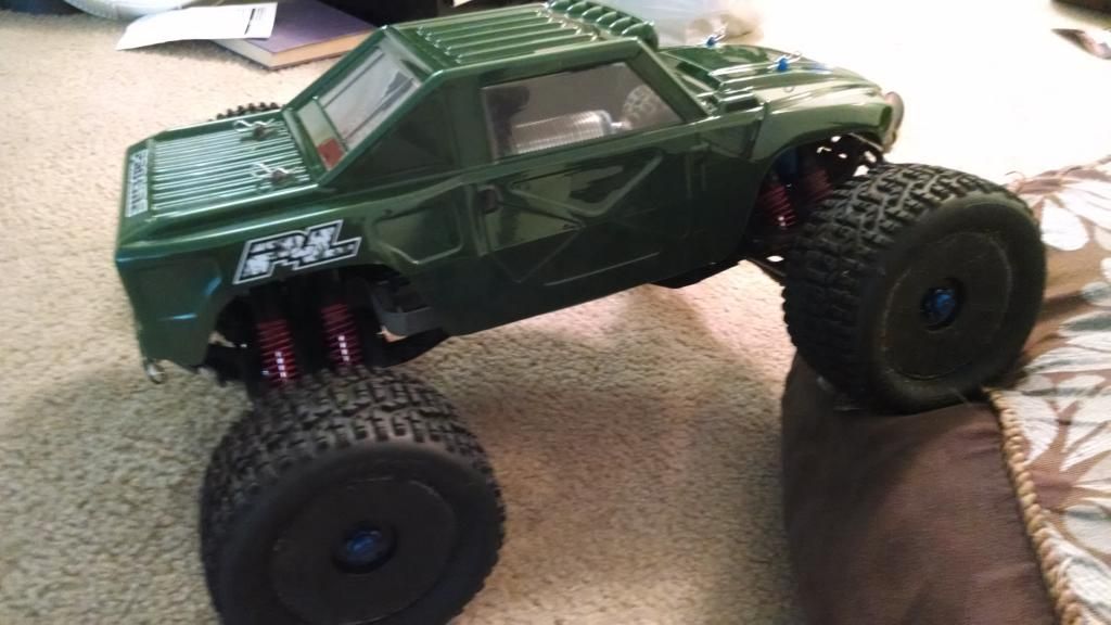

                            • Exodus_2pt0
                              • 5943
                              #224
                              Back in action!
                              New chassis, big bore shocks with dual rate springs, 50wt oil in the shocks, and RPM front turnbuckles.
                              The truck handles amazing now, much better planted. Still, I hit a curb at speed but the only damage this time was a lower pillow ball popped out of the new turn buckles. No damage to the RPM part, so I simply put it back together and back at it.
                              I don't consider that a break after the past few incidents.

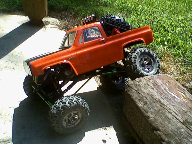

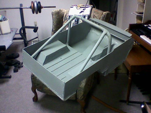

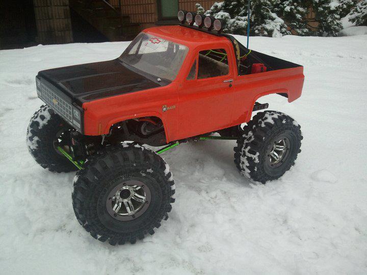

                              • BLACKCHARM88
                                • Jun 2014
                                • 563
                                #225
